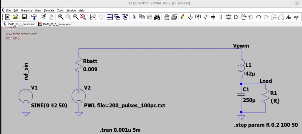

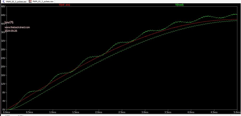

I tried to simulate with a LT spice 1/4 of a sinuzoid (1/4 of 50Hz):
- in red a perfect sinuzoid for comparison for the shape (the voltage values ​​are not correct because they depend on the battery, the transformer, the pwm...).
- in green / upper curve the voltage at low load (R=100). We can see that it ripples a little. It does it more or less depending on the L+C values.
@KeepIS: can you confirm that at low load, you find this ripple? I want to make sure that my calculations are not too wrong vs reality?
- in green / lower curve, the voltage under heavy load (R=0.2). We can see that it shifts from the sinuzoid, especially at the beginning. Maybe an idea to explore: tinker with the PWM signal to slightly increase the PWM signal duration on the 0/3µs range.
For those who would like to try, it's interresting, because the software can extract voltage, current, power, fft, harmonic distortion....
We can therefore have an idea of ​​the evolution of the no-load power or the distortion vs. the value of L+C+load.
If I'm off topic, feel free to tell me!

I have seen the slight ripple in the lower trace which is quite common, but I doubt that anyone is going to look any further into SPWM generation for a "possible" minor or simulated imperfection in this powerful and proven design.
I just had a look at the AC output of the Inverter (running the House and workshop), using a TekTronix 100Mhz DSO.
With part of the sinewave zoomed in to almost a straight line across the display, as I zoomed in, there was nothing but the finest step appearance when fully zoomed in, which could be just the limited resolution of this Tek DSO at that zoom level.

Indeed, I missed the EPCOS filter. When I read your story, I didn't understand its usefulness. To understand better, I removed everything that did not seem useless to me.
Now I understand their importance better!
So I'll have to put some in too.
Above all, don't modify your inverter, it's much easier for me to change the simulation if necessary (a few clicks and it's done)!

Your simulation confirms my dso images when probing a hf inverter (hv bridge and lc filter). In a lf inverter some magic hapens in the transformer. So you will need to take that in to account as well.

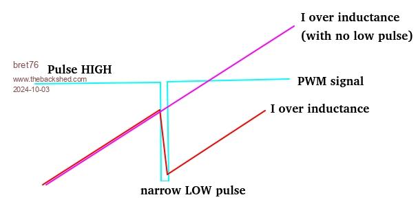

Do you have any idea of ​​the remaining uH in the inductors when you are at full power? (50% of the initial value ? -> something about 20µH in total?)
Many saturation tests have been done, we often talk about the inductance at no load (indicative value?), or the Amps at the knee,  but not so much of µH remaining under  load (useful value?).
I understand that the inductor is used to protect the MOFSETS from currents that are too high when the current is at its maximum. My goal is to avoid ending up with an inductor that doesn't have enough µH under load (as I planned to buy bigger cores Like MS-301060 ones - which should reduce the number of cores and the heating a little (I hope !).
David

I just did a quick calculation (R mosfets + R cable), you are almost at "Pulsed Drain Current" ! Whaoo !! That is safety, but without the straps   . Good done !
Maybe some low and narrow pulses are missing in some conditions (1 pulse missing => 2xI , 2 pulse missing =>3xI), leading to I increase => µH decrease / saturate => more I ...
Red : normal current over inductance
Purpule : current if low pulse is missing
Luckily you explained it to me, I was going to do the opposite (put a big cable in the inductor to reduce the heating)

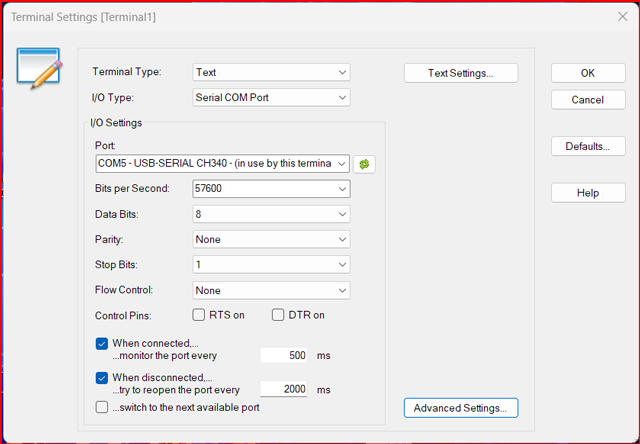

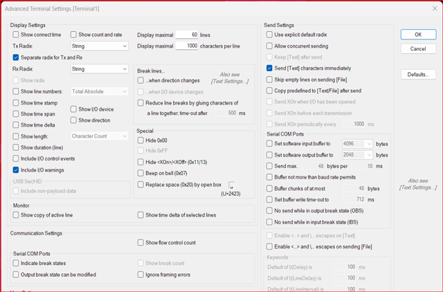

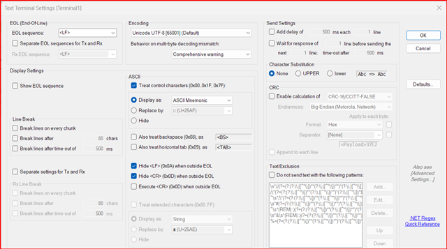

I had a question about setting up "Tera Term" Terminal program to work with Nano Menu system in my Code, and another about setting up YAT.
So the easy one is Tera Term, In Setup -> Terminal, set New Line for RX and TX = LF,
Terminal ID is VT100, Local echo can be on or off.
YAT:
Note: I spent all of two minuted on this Terminal program, I have not used it before, just checking it worked correctly, so I'm not really interested if something is incompatible with your YAT religious or other technical manta.
After this very brief look at YAT, I do like the program and will look at it in more detail when I get time.
Screen Grab for YAT:
Terminal.
Text Settings.
Advanced Settings.
