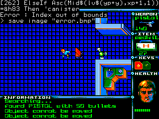

and now for something completely different
since v 23 the program runs into an error with the program from time to time.
(not just with my last version)
'no comment
Posts: 6194
Posted: 01:19pm 06 Nov 2023
Martin,
I think it is since pet23b.
I expect this is a result of a change I made after your remark "I did not know Robots can also shoot canisters". I may have introduced the error myself. I will look into this tonight.

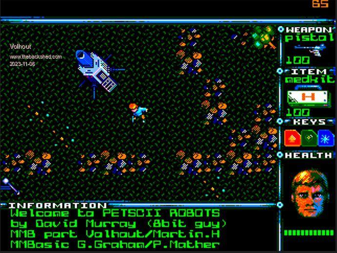

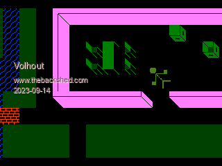

I like how it is growing from this
to this
Edited 2023-11-06 23:35 by Martin H.
