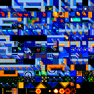

I have another request, something that needs change.
TILES &h82(bomb) and &h86(magnet) would need a magenta background, so you can use black as a color in the sprite. Maybe they should transfer from tile library to sprite library.
Especially for the bomb, you need black (try using it on a blue floor as indoor in the building.), maybe even a fringe.

  Volhout said  Hi Martin,
Nice sprite. I already used it (added it as SP3056.SPR in the sprite list).
will, see and yes, the sould be moved to the Sprite_lib, as you use them as Sprites not Tiles ..
I will create a Sprite for both with Magenta Background...

Posts: 6195
Posted: 07:11pm 28 Oct 2023
I already made the required changes to the library and sprites. Don't worry.
Have nice magnet and bomb now.

Still VGA only: additional functionality:
- you can place a bomb, and have 3 seconds to run (at least 5 tiles) away.
- the bomb does 11 damage radius 5, so all hoverbots within 5 tiles will die.
- when too close, you get damage also... so make sure you have a medkit.
this version has a new library, with sprites for arrow cluster, bomb and magnet.

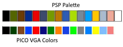

I will try the challenge of replacing non-existent colors with dithering next.
compare:
If you're unlucky you'll get a new, revised tileset
Dithering causes details to be lost, so it can only be used on larger areas.
Martin
