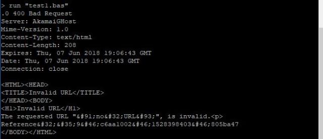

I've found the problem but don't know how to fix it
I'm using 2018-06-08_190744_mmbasicstretch.zip
When I send the Get request it's sending the wrong data
In the attached picture you can see the GET request - the IP address is correct, the data is correct as I've tried it direct in a browser
In the bottom half in the browser section it says the requested URL is different to what was actually sent
This is the actual code - API key blanked out

Posts: 12076
Posted: 09:37pm 08 Jun 2018
The wunderground docs say the request should be of the form
  Quote  http://api.wunderground.com/api/Your_Key/conditions/q/CA/San_Francisco.json

Posts: 4391
Posted: 06:48am 10 Jun 2018
One or more of these may matter:
1. you left out http://
(a browser may silently add that)
2. you have an extra /geolookup
