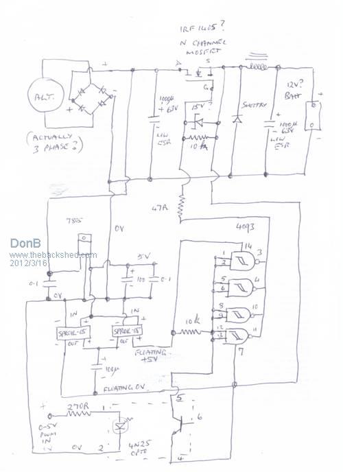

Hi, I am not familiar with the parts your describing and a schematic would be greatly appreciated, Thank you

Posted: 12:19am 16 Mar 2012
If the upload has worked OK, then this circuit shows one way of driving your Mosfet even continuously on if needed.
I have had a quick look at the IR2110 specs, and note that it can do much the same job as my circuit, and probably more elegantly. It can not turn the mosfet on continuously though unless it is provided with a separate floating power supply. While I use the SPRO1L-05 DC-DC converters for this, Figure 16 of the IR2110 application notes uses a 555 oscillator and diode pump circuit to provide the (continuous) floating supply.
I do not know what mosfet you are using, but 10V is usually sufficient to turn most of them fully on. Most will also tolerate a higher gate voltage (say 15 V), but will not turn on any harder. An excessively high gate voltage just needlessly increases the gate charging and discharging current, and actually slows the turn off time.
Note also the 15V Zener connected between the gate and source. This will hopefully protect your mosfet against any spikes induced into the gate circuitry, which could otherwise destroy it.
The following comments may help in your experiments:
The switching of switchmode circuits generates almost square waves. These have some very high frequency components, which can interfere with circuit operation. In particular, where things are physically connected to the 0 Volt line can be critical, and the connection between the electronic circuit grounds and the power circuit ground should be at one point only, otherwise small voltage drops from the flow of power circuit current will be imposed into the electronic circuits, and may cause some mischief.
Long wires should be avoided, and also try to segregate the electronic and power circuit wiring, as otherwise capacitive coupling between the two can cause problems.
You appear to be using an air cored inductor. While there is nothing inherently wrong with this, the inductor will generate a wide spread magnetic field that can induce currents in the rest of your wiring, and also radiate interference into other electronics. Far better to wind your inductor on a (decent sized) ferrite torroid, and then the field will be almost fully contained.
Make sure that the electrolytic capacitors that you use across the input and the load are of a decent size, suitably voltage rated, and of the low ESR (equivalent series resistance) type. I also tend to fit a 0.1 uF capacitor in parallel with them to bypass higher frequencies.
When you monitor the source voltage relative to ground on your oscilloscope, you will see the source voltage rise to just below the drain voltage when the mosfet turns on. When it turns off, the source voltage will actually go slightly negative relative to the 0 V line, and will either stay there for the full off time, or will commence to rise to the high side load voltage as the energy stored in the inductor as a magnetic field fully dissipates. This should not be confused with ringing, which will involve overshoots, and some oscillations.
If you can get hold of a book entitled Switching Power Supply Design by Abraham L Pressman (McGraw Hill), it will explain in much more detail the many factors involved in switchmode design and operation.
Note that the floating supply shown as 5 V on the diagram should read 10 V. Edited by Don B 2012-03-17

Hi, Wow, this is great. I found a possible solution from a manufactures application notes, plus the two methods suggested here, hopefully I will be able to be get one of them to work. I think I have all the parts to try all three. I will post results when available.
Thank you, this circuit is very important for the system to work well. I was checking old test data and the system without the circuit required a 30 MPH to output 4 amps @ 12 volts, with the circuit, driving a resistive, the PMA can output 4 amps under manual rotation. Thanks again.
Don B

Posted: 02:10am 16 Mar 2012
One further comment on the DC-DC converters. I use the SPRO1L-05 because they are locally available. If you look at the SPRO data sheet (from Mean Well??), they are available in a range of input and output voltages and a different model might suit your purposes better.
All you then need to do is track down a supplier.
Don B
