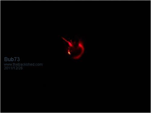

Here is a servo in Michigan winter with the deicer's on using up some of the extra amps!!
