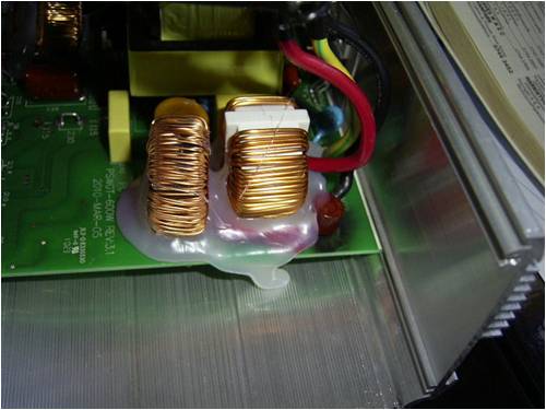

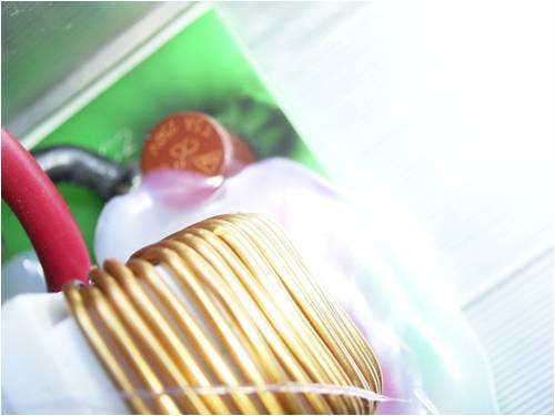

Thanks Bob, I can be an annoying pain when I have to be. Here are a few photos of the cooked part in the invertor. It is in the high side. I am not sure what it is or does but I am sure you guys will. It is rated at 250 volt 7.5 amp.

Yeah thats a fuse. Circuit board mounted type, not meant to be replaced, only there as a precaution against the thing catching on fire when there is something seriously wrong.

Take that fuse off the board, run two 1mm
wires to a panel mount fuse holder (3AG or M205)
and put a 3.15 amp ceramic fuse in it. If that fuse
on the board failed, it would need to have passed
a couple of thousand watts, if your supply is 240v,
so if the fuse wasn't faulty or incorrectly marked
chances are another fault is lurking.
