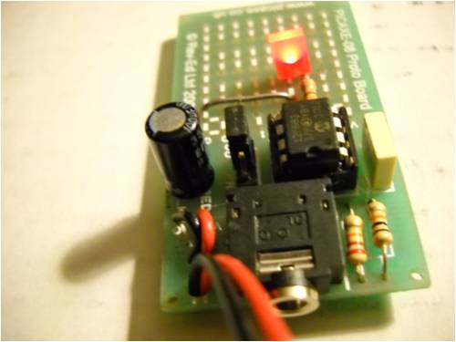

We will be using vero board or pc board for now, I know its not the best for some projects and should be good enough to learn with.

Posted: 05:16am 03 Jan 2011
Looks like you have made the first step.....lighting a led, it gets easier from here.
Vero board is fine , just remember when it comes to the wireless modules to keep the antenna track length as short as practical, as long tracks can introduce noise into the circuit and the track is also counted as antenna length too.

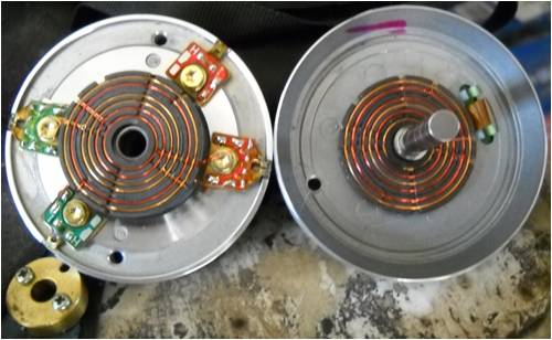

Ive got some machining started on the outside unit .
What all will we have to put in it?

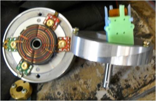

I think Im going to use the motor out of a old vcr and was wondering what that is inside the motor each side has a disk with coils of copper wire looks to be a break or something?Bub has pictures if he puts them up of this.
will we put the transmitter in the outside unit? an amplifier and the octicoupler units??
Isaiah
Posted: 01:35am 04 Jan 2011
Think you will find the coils you refer to are a mini stator arrangement that is the windings for the motor itself.
Either way the coils need to be stripped out so all that remains is just the bearings and the outer head casting.
I only placed the interupter disc and sensor in my anemometer section and run the wires down to a box with the electronics mounted in it lower down the pole.
I found if the antenna for the transmitter was to close to the spinning mass of the anemometer it caused interfearence with the transmition.
Also the antenna needs to be away from the pole, as any metal in close proximity will effect the signal
If you can remove some of the mass of the video head to reduce the weight without upsetting the balance it would be good, as a heavy mass will effect the response of the anemometer.
Pete.

Here are the pic's Isaiah took of the vcr whats it thing. There seems to be a pickup of sorts still in the vcr we didn't get pic's of; the bearings are very smooth and easy to turn.

What I intend to do is I have a hard drive disk turned to fit inside my pvc cap the disk has about a 1 1/2 inch hole in it I am planning on turning the bearing holder to fit that disk. then the other side of the motor ill turn to fit the octi coupler and the other end of the shaft will be hooked to the cups.See Bub's pictures I wasnt sure what those black disks with the wire in was. thought it may have been a counter of some sort? Oh well You guys are the electricians,I just let the smoke out!
Posted: 05:24am 04 Jan 2011
Don't know what the disc/coils are for and would remove them to reduce any weight.
