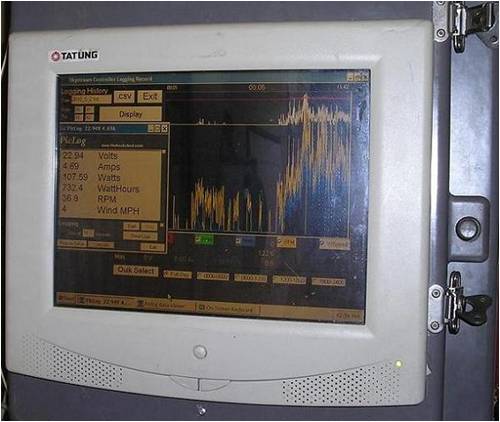

I run my cable router and my switch gear plus the HPe-pc and the 12" monitor from my batteries and I also have a cheap 400 watt ebay grid tie that is hook up to the mill side with diode to battery side so i can always put any extra power back into the house,
if there is exsess power made my dump is to 2 cheap grid ties so it dumps from batteries and mill to house at about 1000 watts for 5-10 minutes'

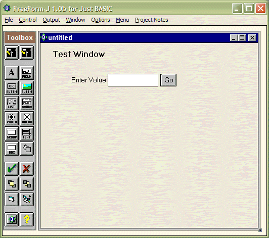

Just BASIC can be used to create forms like VB6, though its a more hands on approach. You can have several forms open at once, each doing their own thing, like this example...
There is a free program called FreeForm thats a GUI form designer for Just BASIC. FreeForm is even written in Just BASIC!
FreeForm will generate the code to copy/paste into your Just BASIC program. This code will create the form above.
nomainwin
WindowWidth = 440
WindowHeight = 395
UpperLeftX=int((DisplayWidth-WindowWidth)/2)
UpperLeftY=int((DisplayHeight-WindowHeight)/2)
statictext #main.statictext1, "Test Window", 26, 16, 144, 20
textbox #main.textbox2, 134, 61, 100, 25
button #main.button3, "Go", [button3Click], UL, 238, 61, 32, 25
statictext #main.statictext4, "Enter Value", 62, 66, 144, 20
open "untitled" for window as #main
print #main, "trapclose [quit.main]"
print #main, "font ms_sans_serif 10"
print #main.statictext1, "!font MS_Sans_Serif 12 bold"
The more I play with the software the more I like it. I've writte a test program that receives PicLog data and sends it over the internet.
FreeForm-j can be downloaded from here., Just BASIC is available from here.

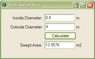

This is an example of a little program to calculate swept area. Very basic stuff at this stage.
nomainwin
WindowWidth = 312
WindowHeight = 195
statictext #main.statictext1, "Inside Diameter", 38, 21, 96, 20
statictext #main.statictext2, "Outside Diameter", 30, 51, 104, 20
button #main.button6, "Calculate", [CalculateArea], UL, 142, 76, 104, 25
statictext #main.statictext7, "Swept Area", 62, 111, 72, 20
statictext #main.statictext9, "m", 246, 21, 144, 20
statictext #main.statictext10, "m", 246, 51, 144, 20
statictext #main.statictext11, "m2", 246, 111, 144, 20
textbox #main.SweptArea, 142, 106, 100, 25
textbox #main.OutsideDiameter, 142, 46, 100, 25
textbox #main.InsideDiameter, 142, 16, 100, 25
open "Blade Swept Area" for window as #main
[main.inputLoop]
wait
[quit.main]
Close #main
END
[CalculateArea]
print #main.OutsideDiameter, "!contents? OutsideDiameter";
print #main.InsideDiameter, "!contents? InsideDiameter";
OutsideDiameterArea=(OutsideDiameter/2)^2 * 3.14
InsideDiameterArea=(InsideDiameter/2)^2 * 3.14
SweptArea=OutsideDiameterArea-InsideDiameterArea
print #main.SweptArea, SweptArea
wait
produces this little app
Now for the harder stuff.

Strange syntax, I gather that (for example)
Tells the main form to assign a function called "quit.main" to the close event.
Defines a button and assigns the function "CalculateArea" to it's pressed event.
