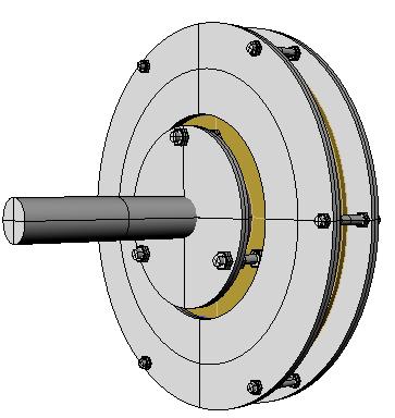

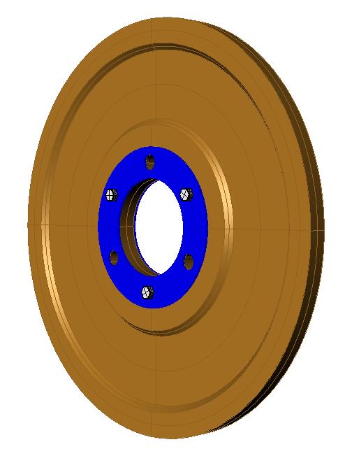

Posted: 01:57am 18 Apr 2010
Yeah I agree a 12 magnet 9 coil arrangment is better. I've spent the last few days in CAD trying different layouts, moving coils and magnets around, and the 12/9 or higher magnet/coil count works very well, which is why just about every axial flux out there is using a 12/9 configuration, its the logical choice.
However I'm going to use a 8/6 for this first build. Its a challenge, but I want to see if it can be done with no wasted space between the coils. The overall diameter is unchanged from a 12/9, so I'll be able to reuse the waterjet cut plates when I upgrade to a 12/9 later.
To better make use of the lower coil count, I'm winding wider diameter coils to fill the space between coils. This means more wire, and more resistance, so to counteract that loss I'm going for a flatter stator between the magnets, 10mm, which will reduce the wire length. This also means closer magnets, and more flux intensity, so I'll gain some power there. The stator will be cast with a step, 10mm thick where the magnets pass over the coils, and 15mm thick where the support bolts go through and the outside diameter..
Where the bolts go through the stator there are two steel reinforcing plates, on either side. I'm using 3 12mm bolts to postiion the stator. The bolts will only be short, there is 25mm between the stator and the mounting plate welded to the axle. 3 Bolts means easy adjustment, but 6 should probably be used for a 12/9 or bigger.
This pic shows the stator and its reinforcing plates. Between each 12mm bolt hole there are smaller 8mm bolts to help clamp the sandwitch together. I think this should be strong enough, but time will tell. This area is where all the big forces are, especially if the mill is shut down in high winds. I can cast this part of the stator thicker if needed, making it stronger and closer to the stator mounting plate.

They can be calculated reasonably as resistance machines. This will leave ideal at the higher power ranges. as back MMF must start to kick in somewhere... but I haven't witnessed it yet.
Here the turns is dictated by the gap, and the flux, the angular speed that the magnets cut the coils (frequency. or degrees/second, not peripheral inch/second). A simple test coils gives you the turns/volt at your chosen RPM.
Then we get the single coil AC rms reading from our cheap DVM, multiply by the number of coils in the phase (usually 3 for a 9 coil design). That gives us our phase voltage. Usually we run star, so we can multiply that by 1.7 to get star AC voltage, and then multiply that by 1.4 to get the peak DC that will start charging the battery at cut in.
So if we had a 100 turn coil being tested at cut in rpm, and saw 7v, we multiply 7 X 3 for the phase AC voltage, X 1.7 for star AC voltage = 35.7 and X 1.4 for the DC = 50v. This will do for cut in for a 48v system.
Next thing, is to design your coils with as much copper as the winding space will allow. So 1/9th of you real estate at the coils diameter is how big your outer for the coil will be, and the inner will be a fraction less than the magnet diameter. (Yes efficiency is lost below magnet size via cancellation to some extent, but the extra volts generated with this shorter less resistance wire is a win.... so we take it)
Then chose however much of your available wire will fit in in how many turns in hand . 16# is fine, but you will probably need a few inhand to get the window full, and keep the R down to minimum. Individual wire size is immaterial, it will be the effective gauge or circular mills if you like (so many in hand... ie 2x16G = 1x13G ...or #16 = 2581 cmils, and #13=5180 cmils etc, mixing gauges is fine also , and may help packing ratio a bit .
Now the above is general for disks that have the magnet spacing at around the half a diameter of the magnet separating the magnets. If the gap is much much larger than this (big disk perhaps), then it may be more useful to use more magnets, and coils in a (4 mags:3 coil ratio for 3 phase). For a vawt, you may want to go with larger disks, and 16 magnets to 12 coils etc. Any cut in can be achieved with these things. Sky is the limit I suppose.
Remember, at the power you have designated for your design we want efficiency to be at least 50 or more pecent (eg. @ 3000W we want to see less than 1500 watts lost in the stator, and more than 1500watts into the batteries). This isn't as bad as it first seems for the design. An iron core will not get there to waste it in the first place (back MMF reactance problems way before then), the AXFX will/can. It is true that the larger the stator, the better the natural cooling. Sadly, unless you pull one out of the barrel, the vawt will not trouble the alternator unduly. They seem to be always well lower on power than the designer expects..... maybe you can change that So if it can turn the shaft, you can easily make an AXFX to match it...I expect most of the time you will be less then 200W.
The stator losses are a squared function, so most of the time efficiency will be very high. It will be only when you don't really want any more power that it will be in the lower end of the efficiency range..... ie near the limit to what you can usefully put into the batteries.... big winds A Vawt will probably not drop below 85% I suspect.... unless it is a very small AXFX
Stator: There have been many mavericks doing their own thing, but they always come back to the old glass stator. It is the strongest, and easiest one to make with the least work. It is just the best so far... (Fibreglass resin, H/temp epoxy(not normal stuff) etc)... but go for it...... but I would not bother with anything else.
Whatever you get up to, the stator must be true and flat and strong as hell.
...............oztulesEdited by oztules 2010-04-28
