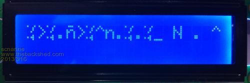

I use the program editor wizard and convert Mr. Gizmos original version 2 code and compare it both with Mr. Pete X2 conversion code and the only difference was the piece of code above and the nap command. so I added this to Mr. Pete code and I get this.
I also tried to rewire as I mention in previous post but that did nothing. I also add the "setfreq m4" command and still no luck...
My other guess is the LCD...But if the LCD works fine with the version 1 code shouldn't it work for the version 2 code? here is the specs of my LCD.... http://www.taydaelectronics.com/datasheets/A-1749.pdf
The program seems to be running, but no visual on the LCD. If I hit the menu button and up /down buttons I recognized changes on the LCD. Just the characters are not recognizable...

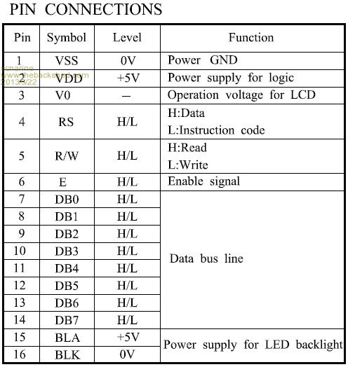

The problem we have is Glenn did not list the "DB" pins for his LCD in the schematic, so the pinouts of his lcd and yours might be different, as there is several versions of lcd around with different pinouts.
Although they look to be the same pinouts.
The messed up charactors are most likely caused by the wrong order of wiring from picaxe and lcd DB pins, causing the data to be sent to the display in the wrong order.
From what i can workout the display should be connected as follows
B.7 to DB7
B.6 to DB6
B.5 to DB5
B.4 to DB4
B.3 to E
B.2 to RS
That is if Glenns display has the same pinouts as yours.

B.7 to DB7
B.6 to DB6
B.5 to DB5
B.4 to DB4
B.3 to E
B.2 to RS
That is how I have it connected see my pin config
But I will rewire the lcd tomorrow and try your test above. If the same wiring works on the version 1 code, can it still be incorrect for the version 2 code?

I just tried that code and it did not work...
I believe the version 2 code only works on the PICAXE-28x chip and NOT the PICAXE-28X1 or the 28X2 chips.
I found a temp sensor circuit and code and the commands are totally different for the LCD display

However, this code loads ok and works...My LCD initialize.
Can you or anyone you know have a revolution programmer that can convert basic to assembler. I have PIC16F873A that I can try if the code is converted it may work....

Thats good, although i dont see where the difference is, as both sets of code uses exactly the same code for the LCD.

Then it might not be a problem with the LCD wiring or LCD coding.

I don't understand any of this programming, I wish I knew what to do to make this project work. I search the internet for PICAXE-28X and could not find one. I order one on ebay the description for $28.00 http://www.ebay.com/itm/PicAxe-28X-Chip-Microcontroller-Inte grated-Circuit-/300852199852?pt=UK_BOI_Electrical_Components _Supplies_ET&hash=item460c3041ac
I don't believe it is correct.

Well Guys I would like to Thank you both Mr. Glen and Mr. Pete for your time and effort, I have learned a lot about picaxe..(not really an expert yet I am still in kindergarden) Well The good news the circuit and Version 2 code is working so far. so here is what I did so far.
A few years ago I used sprint layout and create the PCB I also purchase PICAXE-28X1 and X2 chip. Last year I used my CNC machine and Finally mill the board and drill the holes. This Year I assembled the board. A few weeks ago I attempt to program the chip. So I started out getting syntax errors since I jumped straight into the 28X2 chip so I revert back to the 28X1 chop and program it with version 1 then tried version 2 code, well that was not a good idea...because you will get a bunch of weird characters on the LCD like I was getting. I would like to apologize to Mr Glen and Mr. pete for wasting their time with me for my silly mistake.
However, This is what I did to make it work. I found a different code ( temp sensor picaxe project) I loaded that code (trial and error while I was testing my LCD wiring configuration) which changes the chip completely. An erase chip function would have also done the trick. I then program the chip again and the notice the LCD display "O/P 1 On 00.0V I then decide to hit the menu button and play around. I then decide to play around with the values then realized I have to set the values so I did and as I exit the menu I see "wait" and then wola the darn thing display correct "12.0v, 00.0A, 000.00W 000Wmax"
1. Do not program version 1 code then version 2 code over version1.
2. Do not disconnect or reset power to chip/circuit (if you do the characters might get messed up on reboot) without going through the initial setup menu by entering values, by just going through the menu will not exit and you are stuck. Version 1 have defaults setup for you.
Thanks again guys....
