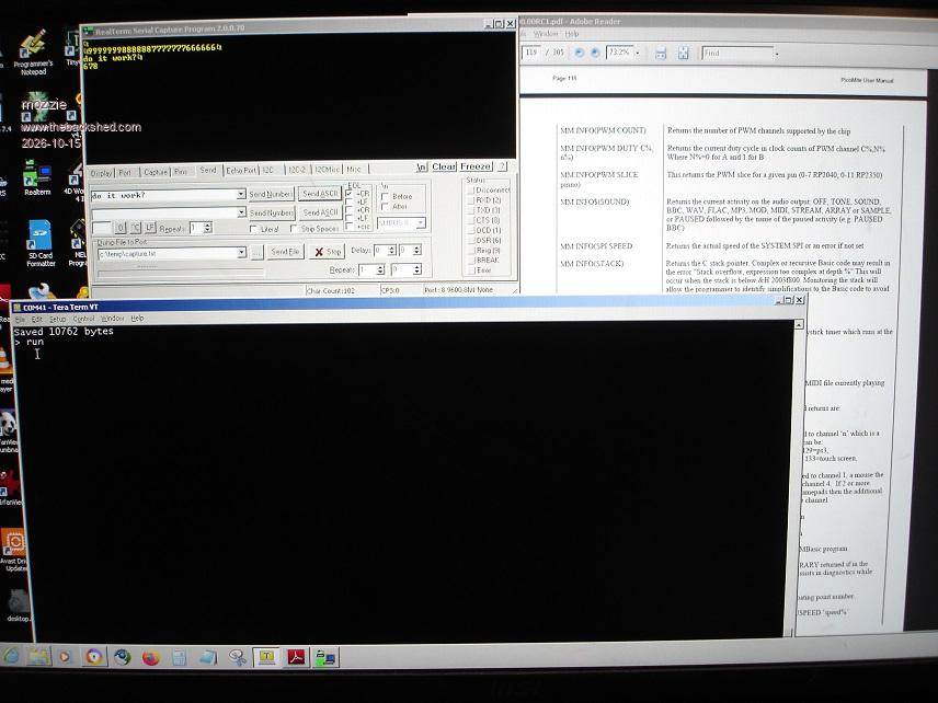

Just for the sake of testing, decided to try plugging / connecting a heap of things onto the PC3 running RC1 to see how it went:
Bluetooth Keyboard / Mouse combo
Bluetooth serial HM10 module (COM7)
Bluetooth speaker (Milwaukee M12)
USB Wireless Keyboard / Mouse combo
FT232 TTL / Serial converter (COM3)
7" HDMI Monitor with 10 point CAP-Touch screen
Music on SDCard
Running 1024 x 600 in mode 3
The FT232 has RX-TX looped to send back anything it receives.
The HM10 serial module is connected via another FT232 to the PC.
A slightly modified version of the PUMP-TEST program to send all recieved keypresses to COM3 and then from COM3 to COM7 via interrupt routines
Anything received from COM7 (PC) is sent to COM3 via interrupt routine and then is sent back to COM7 and back to PC
Play audio from b: to BT speaker
And it all just works
Typing on touch screen / USB keyboard / BT Keyboard / Console Keyboard all working together. Touch Screen / USB Mouse / BT Mouse all working with the Pump-Test GUI system.
Music keeps playing, no gaps noticed
Whilst I guess this is not stressing the processor it shows the peripherals are pretty steady. Only issue so far is getting enough 5V current to power everything.
Overall very impressed with the PC3, my thanks to Peter and everyone else involved for making this possible
Next test is Bluetooth and Stepper system to see how that goes. But thats tomorrow (ok, later today), its time for bed
Regards, Lyle.

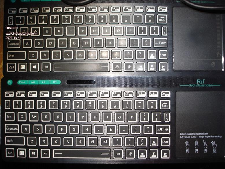

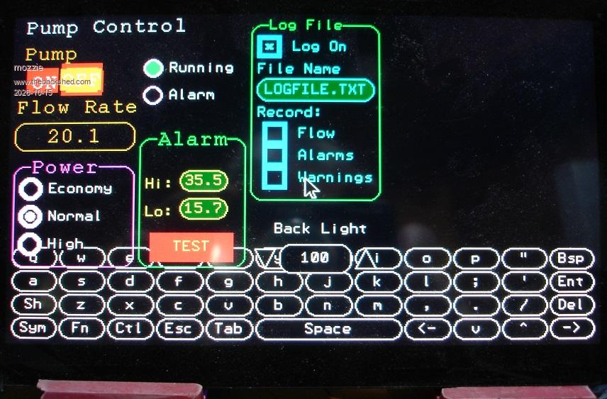

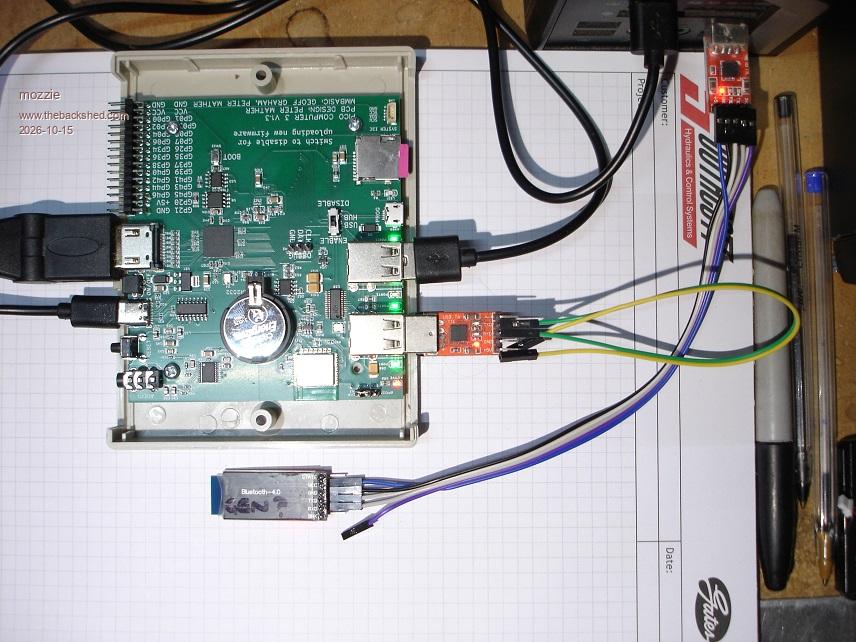

G'day Phenix,
No problems but nothing too exiting to look at:
PC3 / BT modules / FT232 ETC
Pump Test needs to be re-sized to suit on screen keyboard
Keyboards, upper is USB-Wireless, lower is Bluetooth (can be very confusing)
Teraterm as console, Realterm talking to FT232/HM10
The "experimenters bench" looks like a nuclear blast so no overall pics I'm afraid. The occasional ant is moving real fast from all the absorbed coffee
Regards, Lyle.

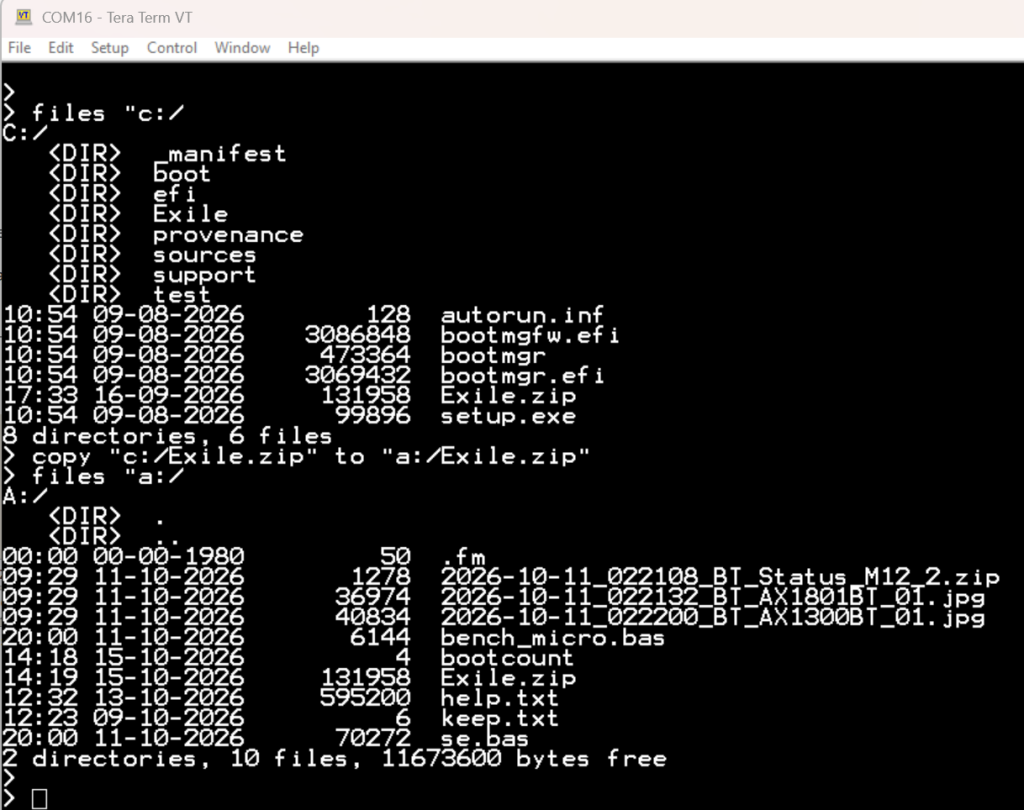

with PicoMitePC3 MMBasic USB RP2350B Edition V7.00.00RC1
I have a problem copying files from C: to A: drive. Not even a file with about 15kB is properly copied.
For example c:c.jpg with 14726 bytes is copied to a: with 5120 bytes. As the copied part of the jpg can be displayed I assume the copy just stops after a few 1000 bytes.
After the copy operation the drive c: is partially inaccessible and behaves strange.
e.g.:
> c:
> files
C:/
14:44 15-10-2026    1440054  a.bmp
14:31 15-10-2026     215338  a.jpg
19:35 07-07-2026      14726  c.jpg
15:02 15-10-2026          0  d.jpg
0 directories, 4 files
> kill "d.jpg"
Error : A hard error occurred in the low level disk I/O layer
> files
C:/
0 directories, 3 files
so d.jpg is deleted but every access to a specific file (LOAD JPG) results in an error and takes a long time.
I've tried this with an USB drive and a SD card with an USB adapter, both behave identical.

I have now flashed onto the PC3
  PicoMiteHDMI MMBasic USB RP2350B Edition V7.00.00RC1
and that version works ok.
The version with the issue is
I hope I've not used the wrong version before ...
Edit:
seems to be a problem with pico flash artefacts!!
After trying the PicoMiteHDMI version which worked, I reflashed PicoMitePC3 and now it magically also works. I've only changed the resolution to 1024 on both versions due to sync probs on my HDMI monitor, all other optons were left to default. The drive a: was also preserved and ok as was copying files from c: to a:. OK, so at least I know for the next time where to look first ...  . Maybe a flash nuke upfront would have avoided it.
Edited 2026-10-16 00:27 by ville56
73 de OE1HGA, Gerald
