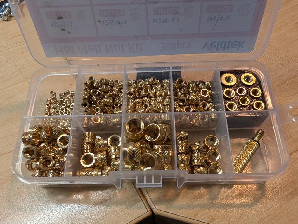

  zeitfest said  There are "heated brass thread inserts" which are said to insert into
plastic cases and have a strong thread (a soldering iron heats the the insert
and it bonds in place), don't know if they are ok.
I didn't know about these.
For bigger stuff, I've been using helical ones used in woodwork. They were sort of OK in part.
I ordered a box of assorted heated ones which arrived today. They look much better & should work better assuming I can fit them properly. The 2mm ones look like fun.

Be careful with the inserts. There are single and double ended ones. The single ended ones are a simple tube at the end that enters the plastic and these are the ones we want. The double ended ones have knurled collars at both ends and are intended for injection moulding. I'm told that they will work but aren't as good, being difficult to insert and having less grip. I've not verified this.

The ones I got are labeled as a Hot Melt Nut Kit & are single ended with the Chevron pattern on the top section a small plain section on the bottom. They came with the insertion tool & adaptors (which will be the first things to lose)

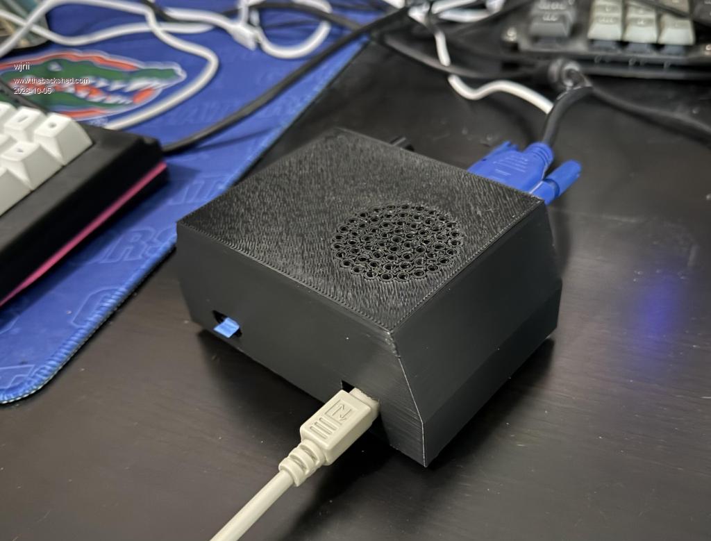

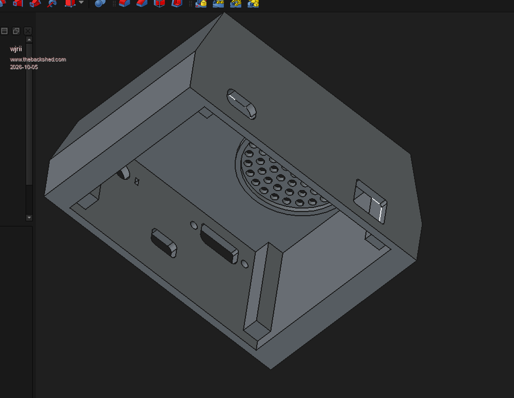

For my PicoMite VGA I used a 90x70mm perfboard and designed an open-bottom case in FreeCAD for it, as well as the LM386 amplifier and 40mm speaker I used with it.  I printed the whole thing upside down and set my slicer to print the "top" 4mm completely solid.  This gave me plenty of material to drill into but left the infill areas nearby to sort of "absorb" the deformation from screwing the board down.
For my keyboards I do generally use the heat-set inserts.  You need to be quick and steady to use them on PLA, but I generally find them the best balance of simplicity and robustness.

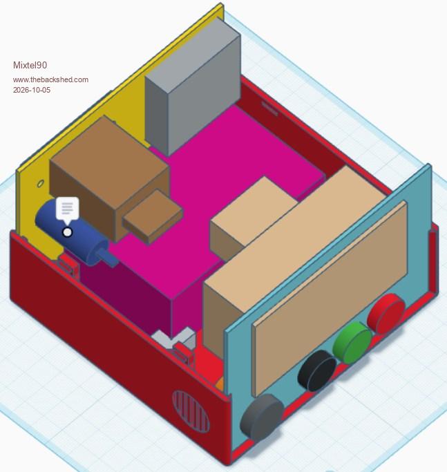

I have a sort of "enclosure kit" in Tinkercad now. Ok, it's not parametric in the least, but it gives a way of making enclosures with front and rear panels in any size that I can handle. It's way slower than parametric but Hey, I'm retired, time isn't money now!
Getting rounded corners on an enclosure in Tinkercad is interesting. You can't stretch a cube without distorting the curves as the stretch is linear along the full dimension. I discovered that someone had found a way to solve it though. Little things like that, from an enormous user base, help a lot.

Speaking of, I don't actually use FreeCAD for most things, both for the reasons you mentioned and because the nature of the project means it's a bit behind in some areas and needs to be all things to all users.  It was finally close enough in workflow to my normal suite (Alibre Design) that I didn't bother rebooting to windows for this relatively quick design.  If you're still on Windows, Fusion360 is a good choice for as long as their free tier is usable, and it's definitely a more mature program than FreeCAD.
Here is my case, and while the top doesn't look quite so bad as that (my phone thinks we want to see every single imperfection), it would get a few changes if I were to print another.  My 'Mite itself is a study in how many shortcuts and cheap-outs one man can take and still have it work.  I didn't have any level-shifters or Mosfets on-hand, so we'll see how long my YD-RP2040 lasts with a single diode shielding its clock pin from 5v.  I also skipped the filter circuit on the audio on the assumption that my little amp board could do the job.  Finally, my VGA resistors are not quite perfect, but apart from skewing half a shade towards green, all seems well.  This is what happens when you let a person with a literature degree own a soldering iron.

That's really nice. Sometimes the novelty is more important than accuracy. :) I have a soft spot for the YD-RP2040. I think it's one of the cases where the clone is a definite improvement on the original from the viewpoint of the majority of users. Ok, it's not quite pin compatible but you can work around that. They've thought about the design.
This is what I've really been aiming for, a nicer case for my bench PSU that can include the mains supply instead of having to have two boxes. It's still ongoing as I'd like to have some sort of secondary filter on the outgoing side but space is very tight. I may not bother.
At the moment it's in limbo until I can afford more filament. That in turn is in limbo until I can find a sensible way to store the one reel that I currently have (the cheapest one I could find, which happens to be silver - not normally used for lab equipment).

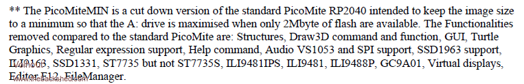

I have soft spot for the original RP pico range. Compared to others the difference is the switching regulator, that is happy with anything between 1.8V and 5.5V. I have several applications running of simple 2xAA cell, and these could also be rechargeable. Even a Game*Mite with AA cells The LCD and backlight are all powered from this 3.3V switcher. But yes.. it only has 2Mbyte flash. The YD-s 16Mbyte is a pro.
I am glad Peter created the 2040MIN version. This is feature restricted, and still has respectable A:/ drive of 870k. Progress is good, always going forward, but this stake in the ground is good for my health.

I agree on the original Pico. That switcher is very good indeed, and something that AFAIK none of the clones have copied. I've not tried the 2040MIN version yet. So many things to play with, so little time! How did I ever find time to go to work?

If you try the MIN version, make sure it does not restrict you. There are many things removed.
It is however a good step up from 5.08.00 and 5.09.00. And (now with V7) faster.
When you always work with SD card, it may not be worth using MIN. It is typical for the microcontroller applications, and suits Game*Mite.
