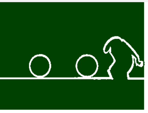

This is a (3 Sec) brief feasibility test using Polygons in mmb 4 Windows. The data would then be stored in an external file. In addition, there is still much to optimize (counting duplicate frames, etc.).

Here we have the full La Linea 10 Video for the Pico, using Polygons.
Need option resolution 640x480 378 MHz to stay in Sync with the Audio
Have Fun

the video should run at 25 FPS, i.e. 40 ms per frame. Even at 378 MHz, the “longest frame” takes 51 ms, but this is not noticeable and the video remains synchronized. The audio is 16 kHz 8-bit mono. No, I haven't tried flac yet, but it's a good idea.
I first reduced the video to 320x240 using Handbrake and then exported it as individual frames using VirtualDub.
For vectorization, I use the Douglas-Peucker algorithm and had gemini write a JScript
for it, although I still had to modify the output file again with the hex editor, .

When rendering to polygons for the first time, the output - file was 38MB in size. It worked under mmb4w, but absolutely not on the Pico.
I had previously considered converting the individual images to SVG, but our polygons cannot handle Bézier curves. Of course, this can be done using software, but then it takes too long for real-time rendering. And manually reworking over 3886 individual images was just too much work for me.
One could also try converting it using the RLE method from marcos_lm, but I was more concerned with the feasibility using polygons.
