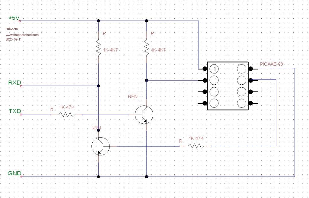

If that doesn't work inverting the signals with hardware will. In my previous post I setup  a MicroMite to use Inverted TTL and proved the transistor inverters will work.

I have tested the circuit desribed by Phil99 on a Picaxe08 and it works with a generic TTL232 lead
Hopefully you have a couple of generic NPN transistors and 4 resistors in a bitsa box somewhere, and you figured out which connection is which on your lead.
TXD = TX data from the converter cable, ditto for RXD = RX into the converter cable.
Good Luck
Lyle.

I tried putting inverters in the Rx and Tx lines and the message I got from the program wa that it couldn't find the device.

The solution was to invert the RxD and TxD lines as suggested by several members.
I used a 7400 quad NAND but it didn't seem to work, so postponed any further investigation as I had arranged a meeting with Mozzie.
Keep in mind that the 3.5mm audio connections are different to the actual AXE027 as mentioned by members.
Where the Sleeve is GND, collar is RxD and the tip is TxD.
It's all working thanks to you guys and a BIG thank you to Mozzie who had this problem before and was able to carry out the procedure like a pro to fix my problem, using FT_Prog as mentioned by ElectroPI.
