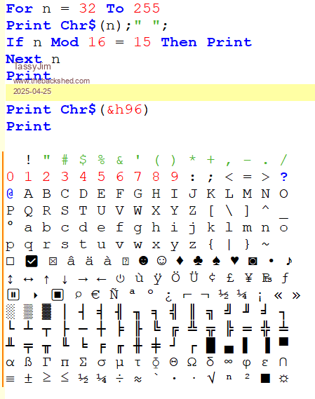

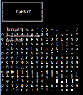

I have added support for code-pages to MMCC.
The default is CP437, the original IBM character set. Other pages included are CP858 and CP865
A special one for javavi is CP1125
It is easy to add addition pages by copying the format of the included pages.
Wikipedia is your friend for finding the Unicode characters for any set.
The last code page I have called cpcmm2 as it covers (most of) the characters of font 1 which first appeared in the CMM2 and carried on with the picomites. I wasn't able to locate some of the characters so they remain as per cp437.
The format of the cp*.inf files is the same as used with FontTweak.
By doing a copy and paste from MMCC, any extended characters are copied using their Unicode designation so most text editors should display correctly.

cp1125 (I hope I have it correct)
and some mmbasic fonts in cp1125 for javavi

Posted: 09:22am 26 Apr 2025
Привіт і тобі Jim від мене,
Thank you very much for your efforts in supporting the font for PicoMite VGA/HDMI, now it's just a matter of figuring out how to eliminate the gaps between the font glyphs on the MMCC screen.

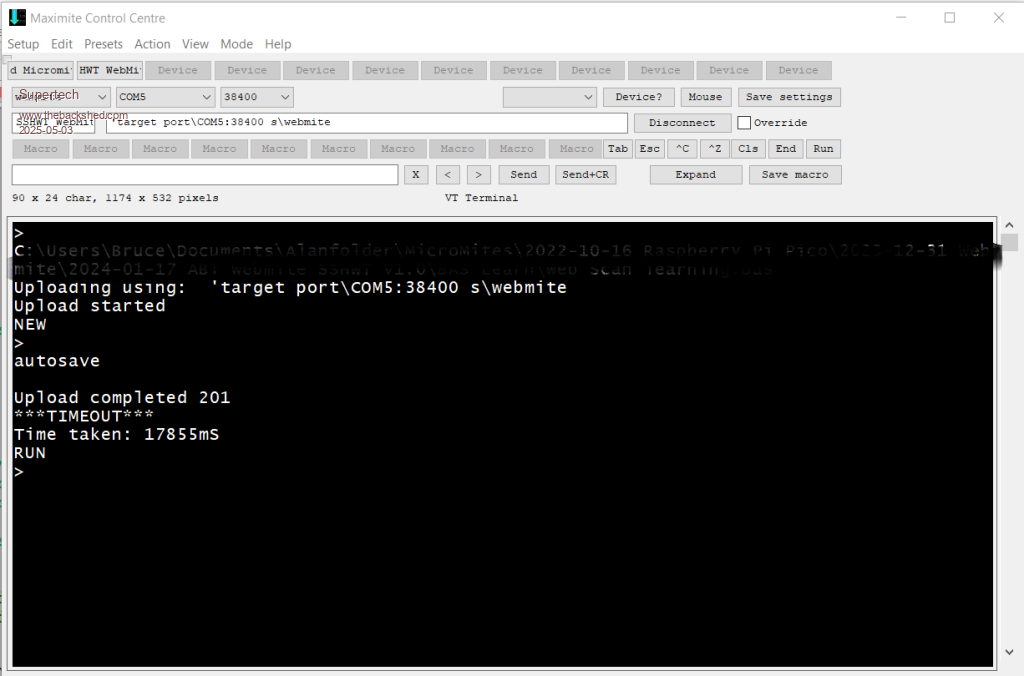

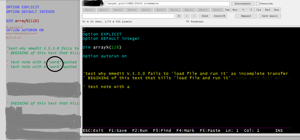

1. 'Load file and Run it' via MMCC.
Now this is tricky to explain, and took me a while to find cause.
1.1 In one word " ' " that is the single quote character itself, nasty.
1.2 Now this ONLY occurs if one pastes from any external text source, so bare with me.

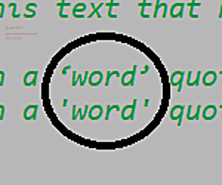

1.3 By default, as one types comments in (Webmite syntax mode I am using) in your .BAS in MM Editor V5.3 console, one gets that single quote belonging to MM Edit font.
eg ' text with 'word' in single quotes GENERATED in MM Edit. All good.
1.4 However, lets paste this identical text in externally as notes.
eg ' text with ‘word’ in single quotes PASTED in MM Edit.
Notice the different? This was never an issue before and especially within a ' text comment that really should be font ignored or inclusive?
1.5 In case you can't see, the single quote is a different style, ' ' vs ‘ ’.  Woopy do hmm? Um, No. It took me by sleuthing, to reveal what was going on.
2. Well now try using 'Load file and Run it' icon via MMCC.
Result in MMCC screen,
Upload completed 201
***TIMEOUT***
2.2 AND, No data is transferred from the unhappy character part of your .BAS onward.
2.3 When you type EDIT in MMCC, program transfer shows no data from that point directly off device itself, in my case, irreverent but, Webmite Pico W. It only holds code to 1st font quote it don't like, with blank data onward obviously not....?
3. Undo any history, or in fact mostly any Undo does nothing, in some cases it seems to forget if was stored as a Undo, if it even did, jumping back with whole lump of Undo steps totally missing. Sorry, It don't work, but thank you for fixing Icon!
Warm regards from just above down under. Take Care TJ.   Regards. Supertech.

Lovely, Forum REMOVES illustrated issue, so,
An image says a thousand words! Kind of explains itself.
Supertech
Joined: 13/11/2016
Posts: 67
Posted: 03:35am 03 May 2025
A little closer......
Them little quotes are DIFFERENT if unnoticed in the fog of character land....
I give up at this point
Posts: 6626
Posted: 05:29am 03 May 2025
MMBasic is ASCII only.
If you enter non ASCII, you get problems.
