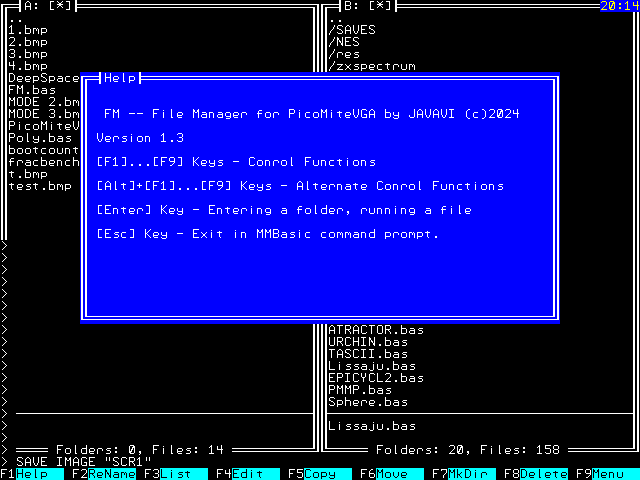

What would it mean, to get the Filemanager running on lcdpanels?
Is there an easy way to translate/get around these VGA specific tile commands?
Dietmar

  Volhout said  @javavi,
I think I found it.
Try this version. It copies, and moves files correctly now.
Problem was caused by the path name, that did not include trailing "/".
Thank you very much for your efforts!
Accepted corrections.
And also added viewing of .BMP files, though in B/W.
FM_v13.zip
