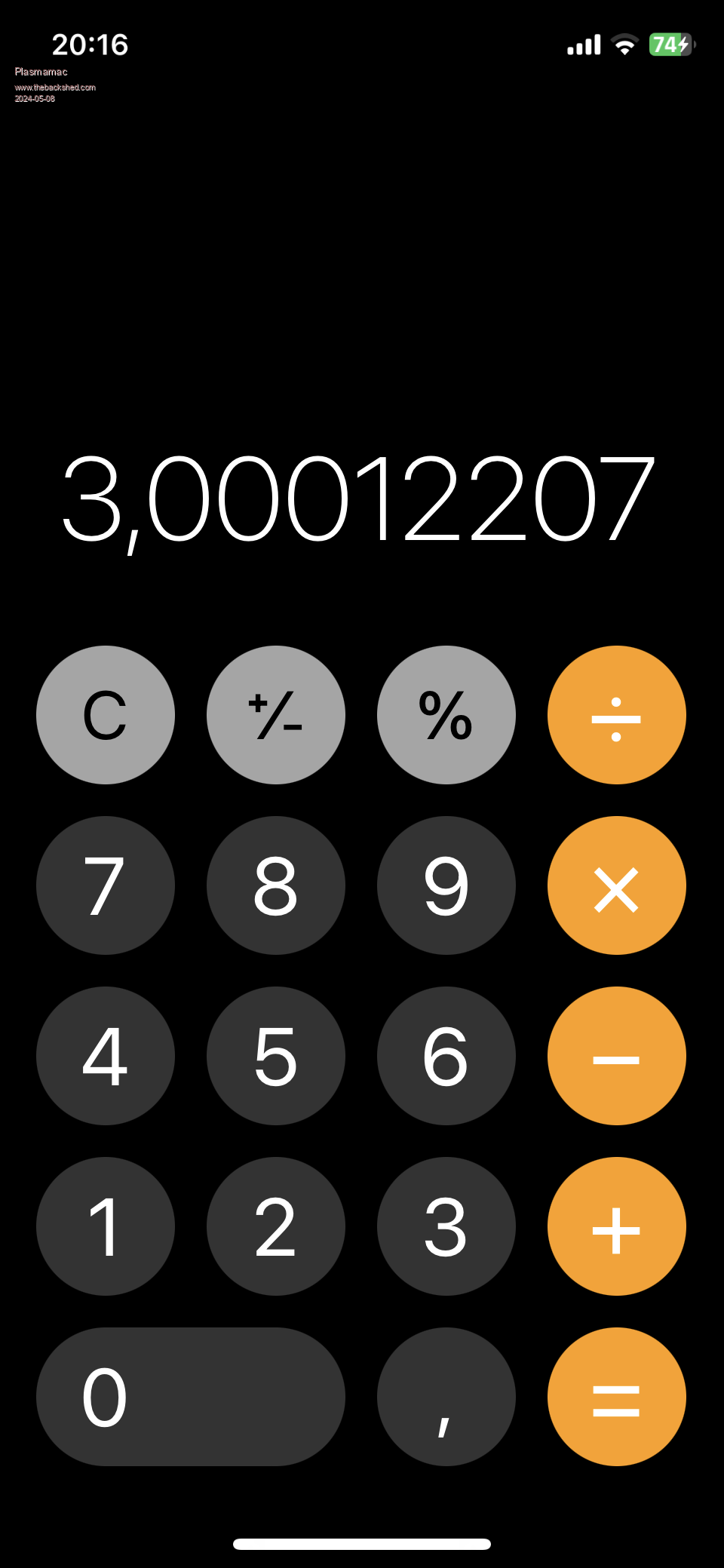

zeitfest
Joined: 31/07/2019
Posts: 702
Posted: 11:32pm 07 May 2024
Interesting thread.  What is the result on maximites or early micromites  ?
@Plasmamac, what is the screen ?
