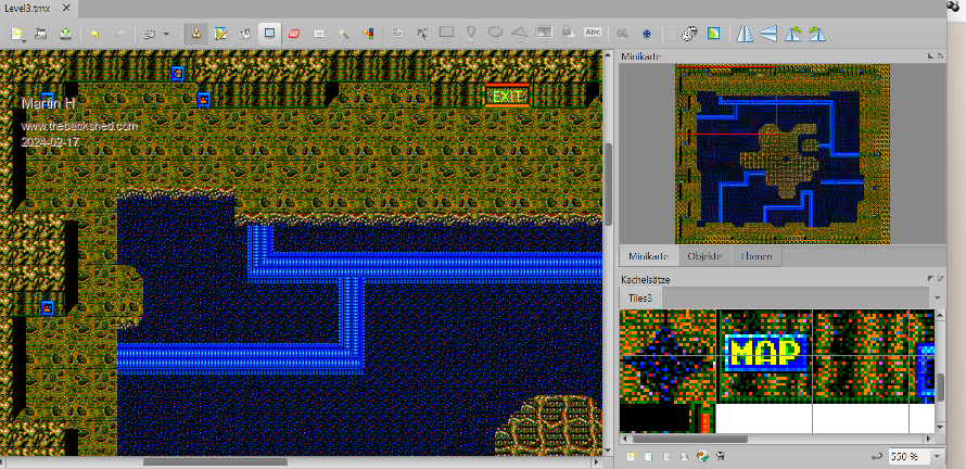

As I see it so far, there are several things that can be hidden. The map, the drones that keep your back free and the increase in weaponry. I should be able to implement the assignment reasonably quickly. There is a maximum of 128 tiles per level. In the original game, the tiles are twice as big, so I always have 4 together, which have the same properties.
I'll probably manage that at the weekend. Then adapt the scroll mechanics so that you can move the player using the buttons.
I just have to make sure that the player moves all the way to the edges. So his position on the screen is not fixed, unlike in Petrobot.
The drawing of the enemies is progressing and the tiles and map for level 3 are also finished.

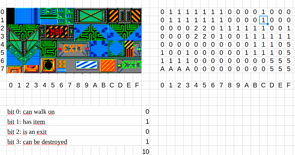

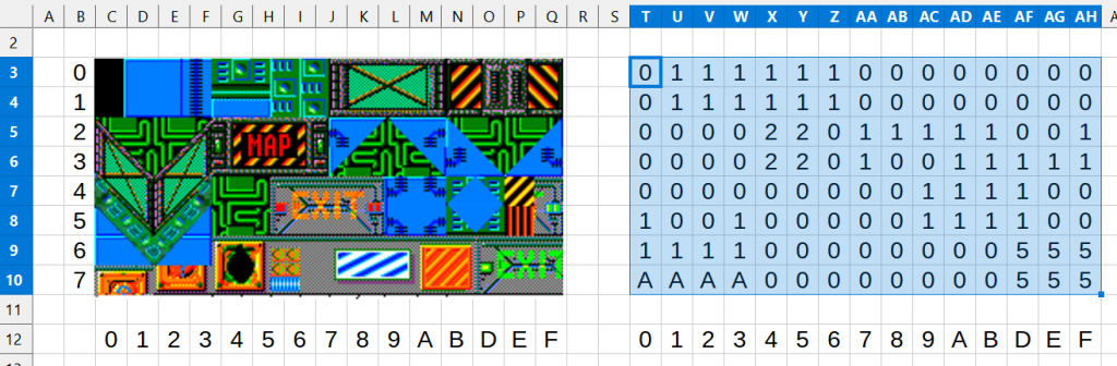

I think in the next version I will attach 128 bytes with the tile attributes to each map so that they can be read with each map.
like this:
I also spent time this weekend working on the Tile_Row and Tile_Col subs, which I will test tomorrow and, if they work, replace the existing scroll_BG sub.
Once the attributes and the new sub-routines have been implemented, it should be possible to walk through the worlds with the player.
Martin

Nice overview Martin !!
This definitely helps in development

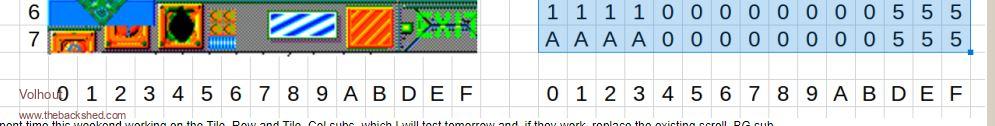

Maybe you could also add a column "C" ? (in 0,1,2...E,F, the C is missing).
I am sure you wanted to see if I was awake....yes I am !!
Edited 2024-02-19 22:01 by Volhout

Posted: 12:34pm 19 Feb 2024
Ups ..
you're right of course, and I didn't notice.
That's what happens when you do something like that (quickly) before you go to sleep.
But it explains the principle of how I will assign the attributes to the tiles
