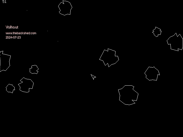

Now there actually are some PicoRocks to dodge. Well, actually, no dodging required because they can't hurt you.
Four different rocks are defined, and they can be drawn at different sizes. At this stage, drawing speed looks fine.
Collision detection is where the grunt work happens though. For my CMM2 Rocks-in-Space, the distance from each ship to each rock, and from each shot to each target is tested every iteration. The new imaginary number features might be useful to calculate this distance.
Keyboard control (via console) is not great, certainly nowhere as responsive as on the CMM2.

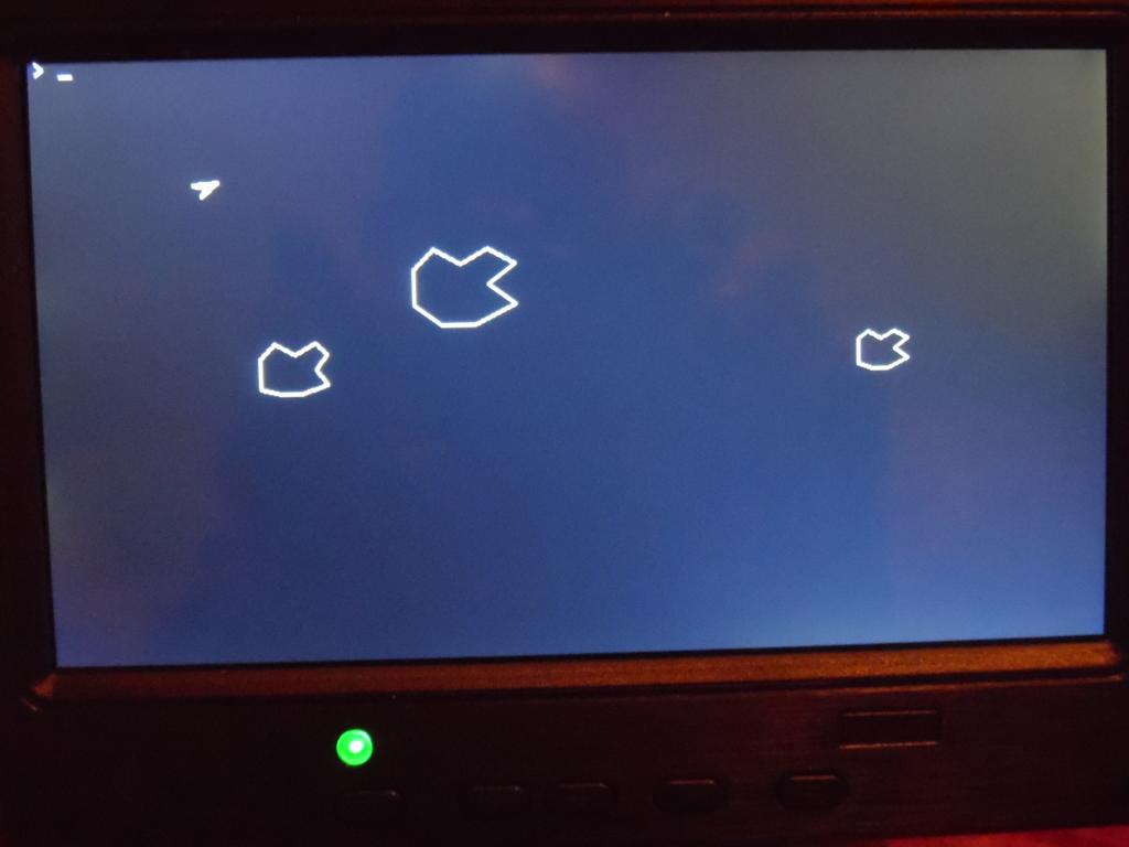

Posted: 08:04pm 14 Jan 2024
got wraparound sort of working
this is just to see line drawn rocks and speed and looking promising

you get a compressed image to line if you go off bottom or left scree but co-ords still valid.
and if x or y <0 they work as -16. weird but cool.
I think pico asteroids doable

stanleyella
Joined: 25/06/2022
Posts: 2807
Posted: 06:59pm 15 Jan 2024
imho 16 ship rotations and draw it.not all that data.
makes thrust different but missiles only 16 directions.
original arcade game seemed simpler.
collision checking is 4 checks per shape,.. maybe test pixels.
nice job your doing, lots of new commands I've not learnt yet.

Update to PicoRocks, using the new array rotate command added to firmware v5.08.00RC4
The program is suddenly a whole lot shorter.
For fun, I've made all the rocks rotate too. This will really bog down though if many many rocks need to be drawn.
Edit: The program below works fine in MODE 1 too, just change line 12. No colours, of course. You might also want to scale things up a bit.

stanleyella
Joined: 25/06/2022
Posts: 2807
Posted: 05:17pm 21 Jan 2024
strange with ili and non vga
https://www.youtube.com/watch?v=RWVrMc5veOY
Posts: 6187
Posted: 07:04am 23 Jul 2024
Pete, Stanley,
Anyone object if I take this a bit further ? There have not been updates for some time, but in the background you could have been working on it.
I am aiming at 640x480 to closer mimick the original monochrome vector graphics.
Martin H.
Joined: 04/06/2022
Posts: 1570
Posted: 09:43am 23 Jul 2024
  Volhout said  Pete, Stanley,
Harm,
looks even better if you place a Tile 0,0,RGB(green),0,80,40 after the CLS in Line 121
Martin
Edited 2024-07-23 19:43 by Martin H.
