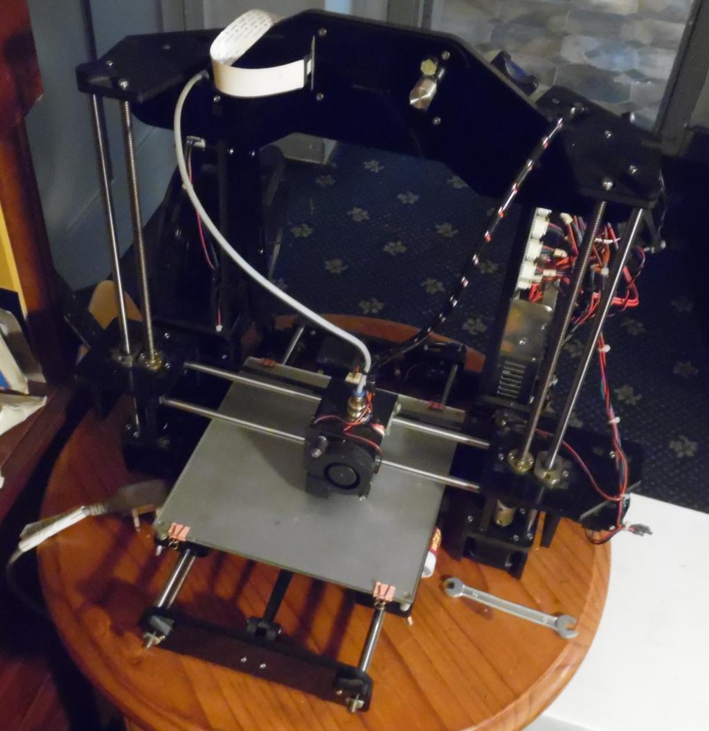

I use a £70 ebay flatpak build yourself kit and it's fine. problem is you have to copy the print file to a sd card then insert the card in the printer, there's no usb lead.
amazing the control board only uses a 328p.

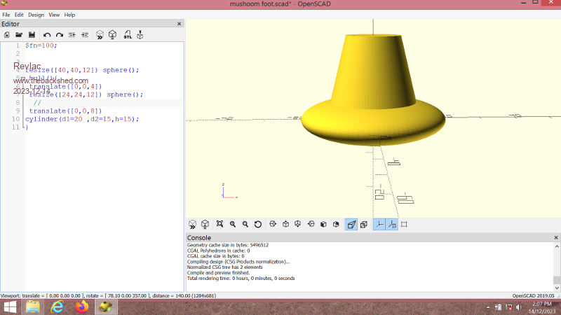

Just a few lines in OpenScad, mushroom is easy, its incomplete but anyone can play with it and make the way they want, I don't know the exact dimensions of that one in Bunnings, this should be fairly easy in any CAD I guess, just use the one your familiar with, I'm no expert with any of this.
$fn=100;
resize([40,40,12]) sphere();
hull(){
translate([0,0,4])
resize([24,24,12]) sphere();
translate([0,0,8])
cylinder(d1=20 ,d2=15,h=15);
Cheers Aaron

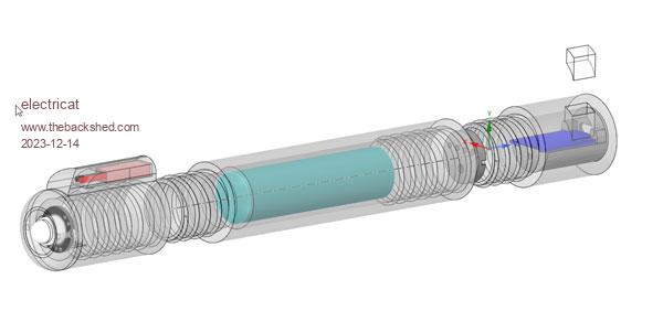

For mechanical 3D modeling I use DESIGNSPARK MECHANICAL (free version does not allow import STL, but do not need that) https://www.rs-online.com/designspark/home
My random creation/enclosure

Easy enough to load and then paste in Aaron's 'mushroom' from above.
I'm tinkering already.

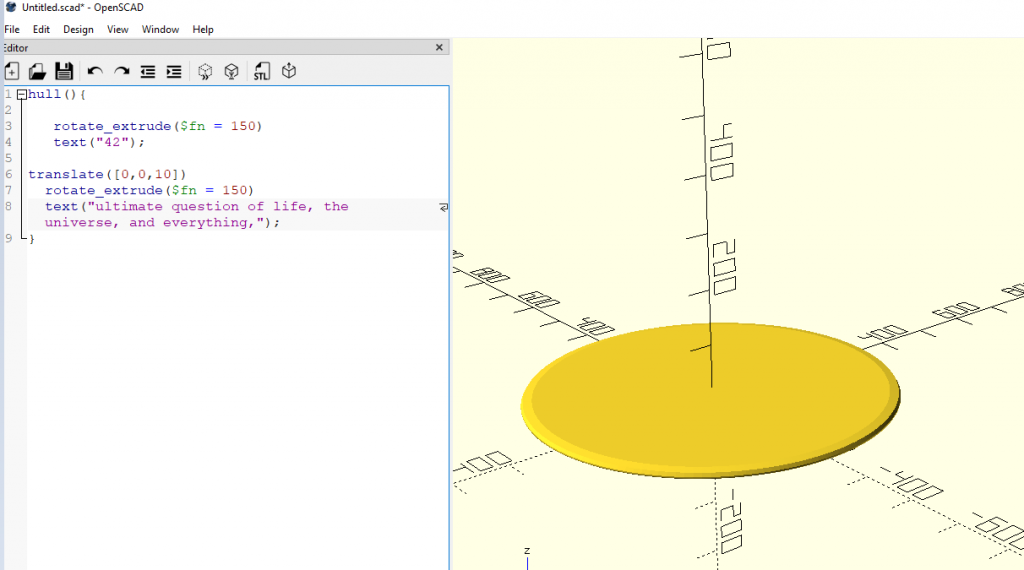

Was working on another project and ended up playing around with text,
Didn't work for what I wanted but makes a neat foot for little effort.
hull(){
   rotate_extrude($fn = 150)
   text("    O");
translate([0,0,10])
  text("O");
Seems funny that adding a few spaces before the "O" changes the size, the cheat sheet is good to have but Doesn't really explain how and where to use functions and other things, anyway will get back to my other project.

So that's umm, different. Try changing the "O"s to something else.
