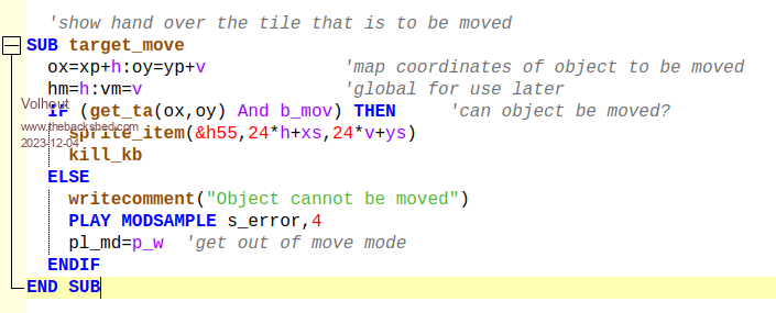

For Tom: The "kill_kb" in below code fixed it in the earlier version

By the way, pet25h.bas re-introduced an old bug in my damage routine (now you can shoot plants again, which was an earlier bug in pet17x), so my investigation of the tile attributes is really needed to get damage compliance. But pet25h has Tom's suggested information strings, adapted for length...
