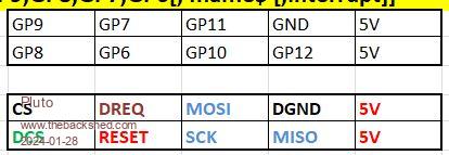

Seen from the component side of the VS1053 board:
OPTION AUDIO VS1053 GP10,GP11,GP12,GP9,GP8,GP7,GP6

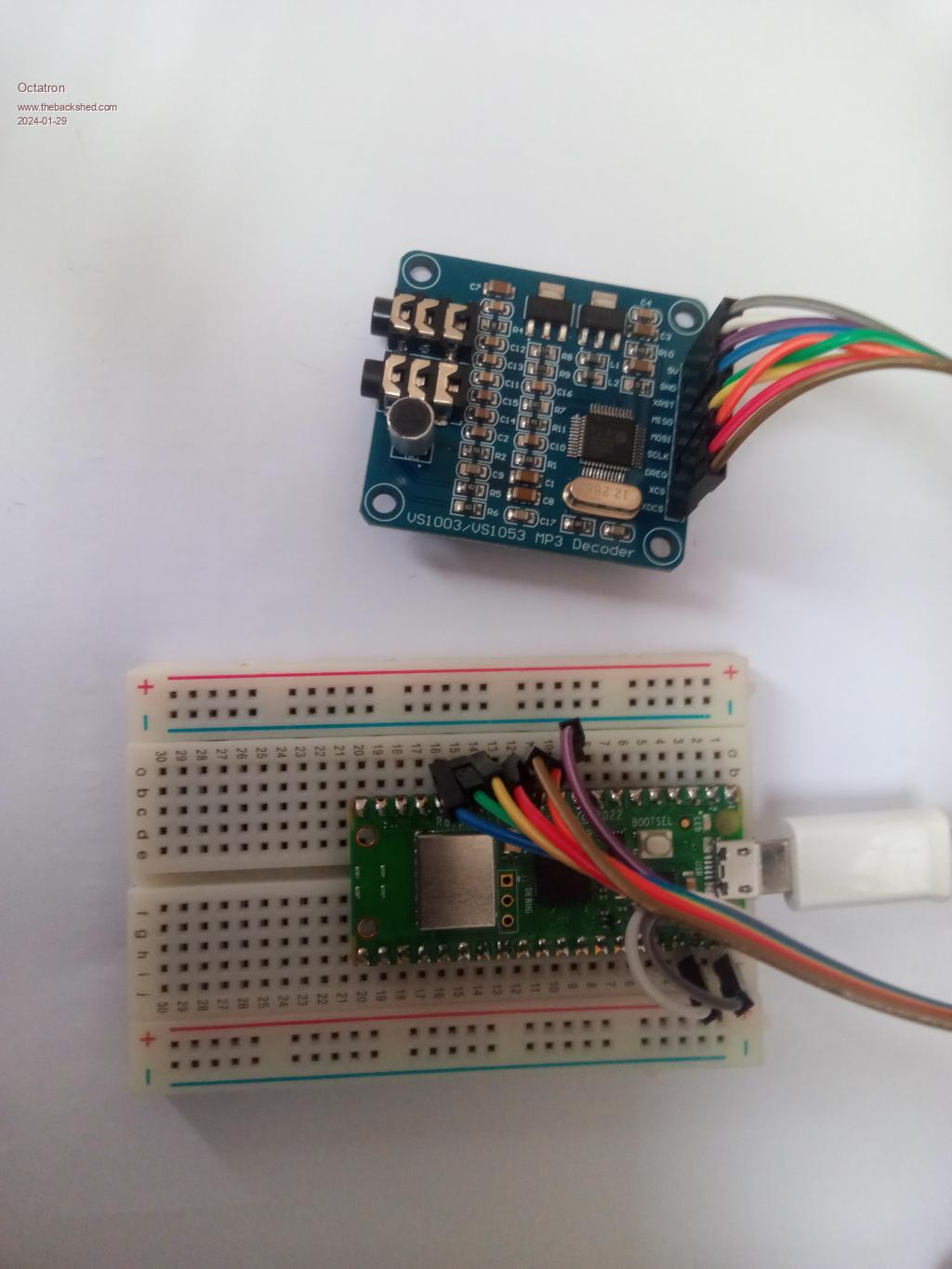

Are you using the same board as Matherp in first post of this thread?
No it's slightly different, see photo.

I think I have found the problem. The chip on the board is a VS10033 not a VS1053 and according to VLSI's website there are differences.
https://www.vlsi.fi/fileadmin/app_notes/migrate03to53.pdf

Your wiring looks right.
if you have a multimeter, have you checked through from the VS1053 to the actual Pico pin - just in case it's a faulty connection on the breadboard?

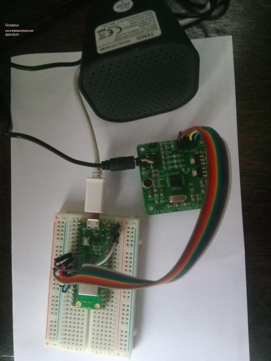

Posted: 05:04pm 31 Jan 2024
New VS1053 board has arrived connected it up and it works, wonderful.
Previous board was sold as a VS1053 but it had a VS10033 chip (should have spotted it earlier), now on the way back to the supplier for a re-fund. So I'm up and running, thanks for the help.
