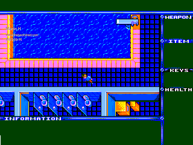

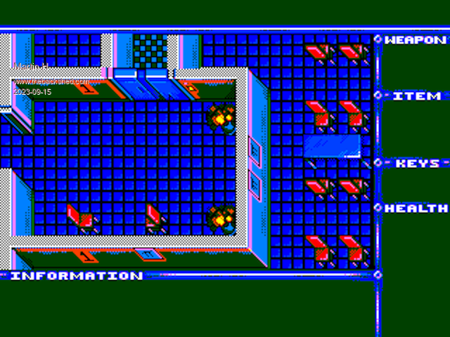

I'm currently in the process of adapting/convert/repaint every Tile into.spr Files.
Here is How it could look like on the Pico
with this Layout we are able to hide 53 Tiles under the Border
Edited 2023-09-15 21:06 by Martin H.

Martin H.
Joined: 04/06/2022
Posts: 1571
Posted: 11:54am 15 Sep 2023
  Volhout said  @Martin: nice....
As developmentis going right now, I will not store any tiles in layer N (*). There is plenty of space available (or will become available).
The window whould be 11x7 tiles (264x168) to be compliant to the PET version.
AFAIK there are 255 tiles in the amiga version. That is 255 x 288bytes = 73.4kbyte.
Essentially that will fit in library and in a flash slot. (**)
The Display shoes 11x7 Tiles so it is compliant to the PET version.
if we have max 256 differed Tiles, The map can then be a collection of the tile numbers.
I will see, if I am able to "decode" the Maps from Github.
Displaying 77 sprites isn't really time consuming.
To speed things up, if necessary, replace the X loop with 11 “Sprite Write” commands
For example, the player's animation, depending on the direction of movement, could be temporarily stored under the Border.

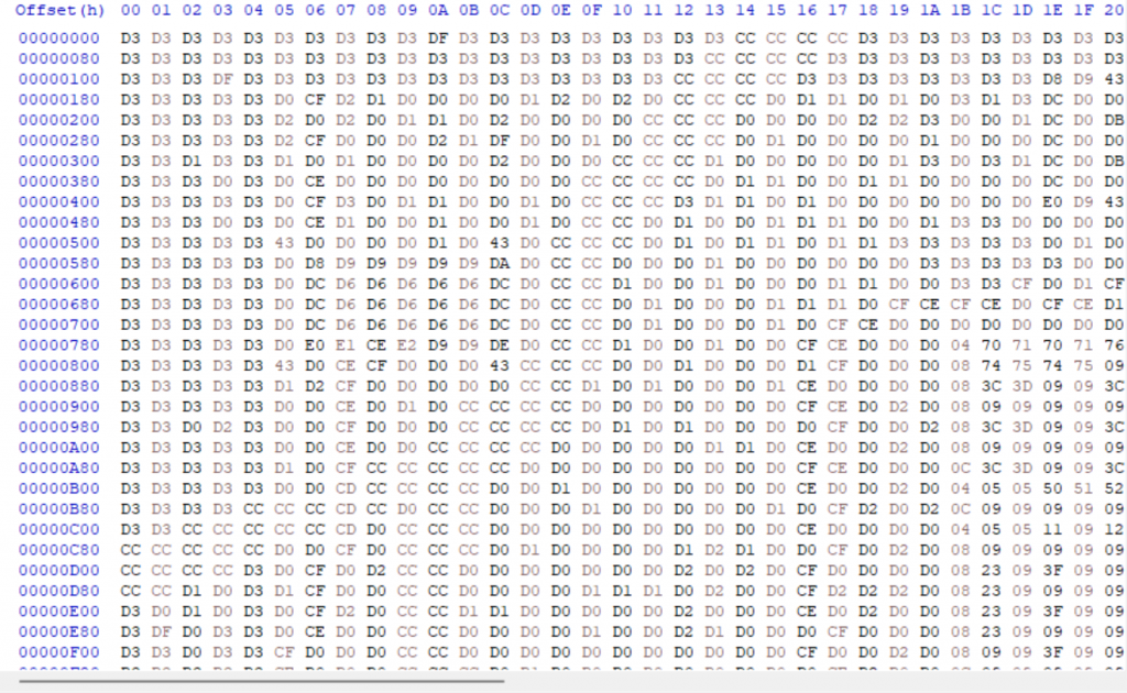

Posts: 6192
Posted: 01:17pm 15 Sep 2023
Martin,
I downloaded the user manual for the game. It shows (some of the) the maps.
Maps are 128 x 64 tiles (8kb when 1 byte per cell).
To make life easier, I suggest
The tiles (you are converting) should be grouped in 2 groups
1/ static tiles (floor/walls/grass/water/etc), there should be 127 of these maximum
2/ dynamic tiles (explosions, movements (opening doors), player, robots, etc..)
On the world map any number < 128 will directly translate into a tile
Any number > 128 will be an AI unit. The AI unit has a attribute list. In this list is the related tile number(s) depending on it's state. The AI tile can be any tile 0...255).
This allows to keep a compact world map.
I also have been looking at the video (part 1 is most interesting).
From that I derive:
world_map (x,y)
each cell (byte) contains a base tile number
if number < 128 then tile
if number > 127 then AI unit under/on tile
tile_attrib (128)
each cell (byte) contains tile capabilities (taken from youtube film David)
bit 0 = can walk on it
bit 1 = can hover over it
bit 2 = can be moved
bit 3 = can be destroyed
bit 4 = can be see through
bit 5 = can push onto
bit 6 =
bit 7 =
AI unit_attrib (128,8)
each object can have capabilities (taken from youtube file David)
byte UT = (unit type .. robot/door/etc...)
byte X = X coordinate
byte Y = Y coordinate
byte A =
byte B =
byte C =
byte D =
byte H = health (or hit points)
Edited 2023-09-15 23:30 by Volhout

so here is my work so far ...
All Levels, Tiles and most of the Sprites..
There is a little test program,
I haven't optimized anything here yet because it's just for illustrative purposes.
PETSCII.ZIP
The assignment of the tiles to the maps is not yet correct but I've moved enough pixels for today.
