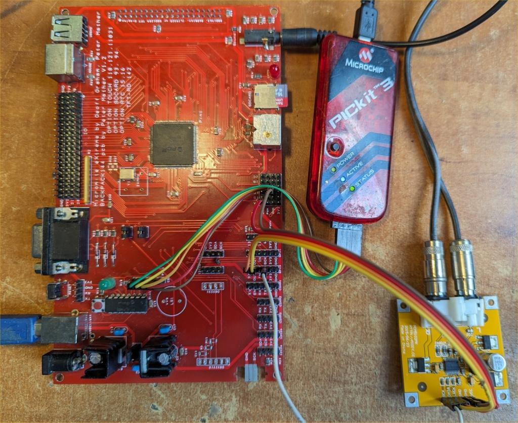

NB: the i2S dac pictured won't run on 3.3V - needs 5V

My i2S DAC board arrived this morning - going to spend the evening connecting it in and trying out - very exciting indeed.

Joined: 10/01/2016
Posts: 309
Posted: 07:32pm 03 Oct 2023
Well, this took me a while to sort out.
I connected the i2S DAC that arrived a couple of days ago - looked very much like the one shown in this thread and then tried to play an .MP3.  Nothing...! I checked my connections.  No issue.  4.98v on VCC.  I re-checked the connections just in case a connector was faulty - from actual pins 96,97,98 on the MMX chip to the solder joints on the i2S board.  All seemed okay. My conclusion; the board must be faulty.
Very frustrated, I looked on Amazon for a next-day delivery PCM5102 DAC and it arrived at lunchtime (a Dollartek product*).  Wired it in and...silence!  Unlikely to be another faulty board, but not impossible.  Again a forensic check on my wires and all seemed okay.  Could it be?  I loaded the Extreme with the old firmware** and, to my astonishment, the music played.
The innovative i2S seems not to be operative in this last firmware version.  Help?
**Edit: very old firmware -5.05.04 - it just came to hand in MMFlash folder.  I have been using 5.05.09 until this new round.
*Edit: the one on the slow boat from China was much cheaper!
Edited 2023-10-04 05:41 by circuit
