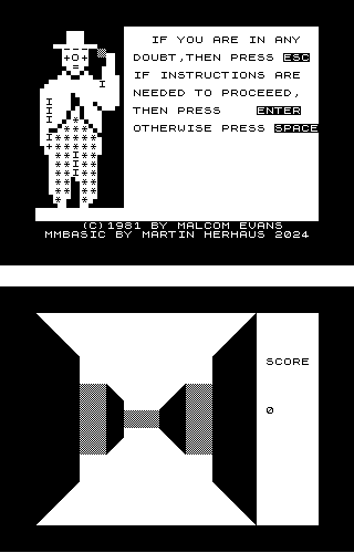

As a first step, i converted Juris Starfield demo from the same Link to Pico
'Starfield by Juri Fossaroli
'PicomiteVGA version Martin Herhaus

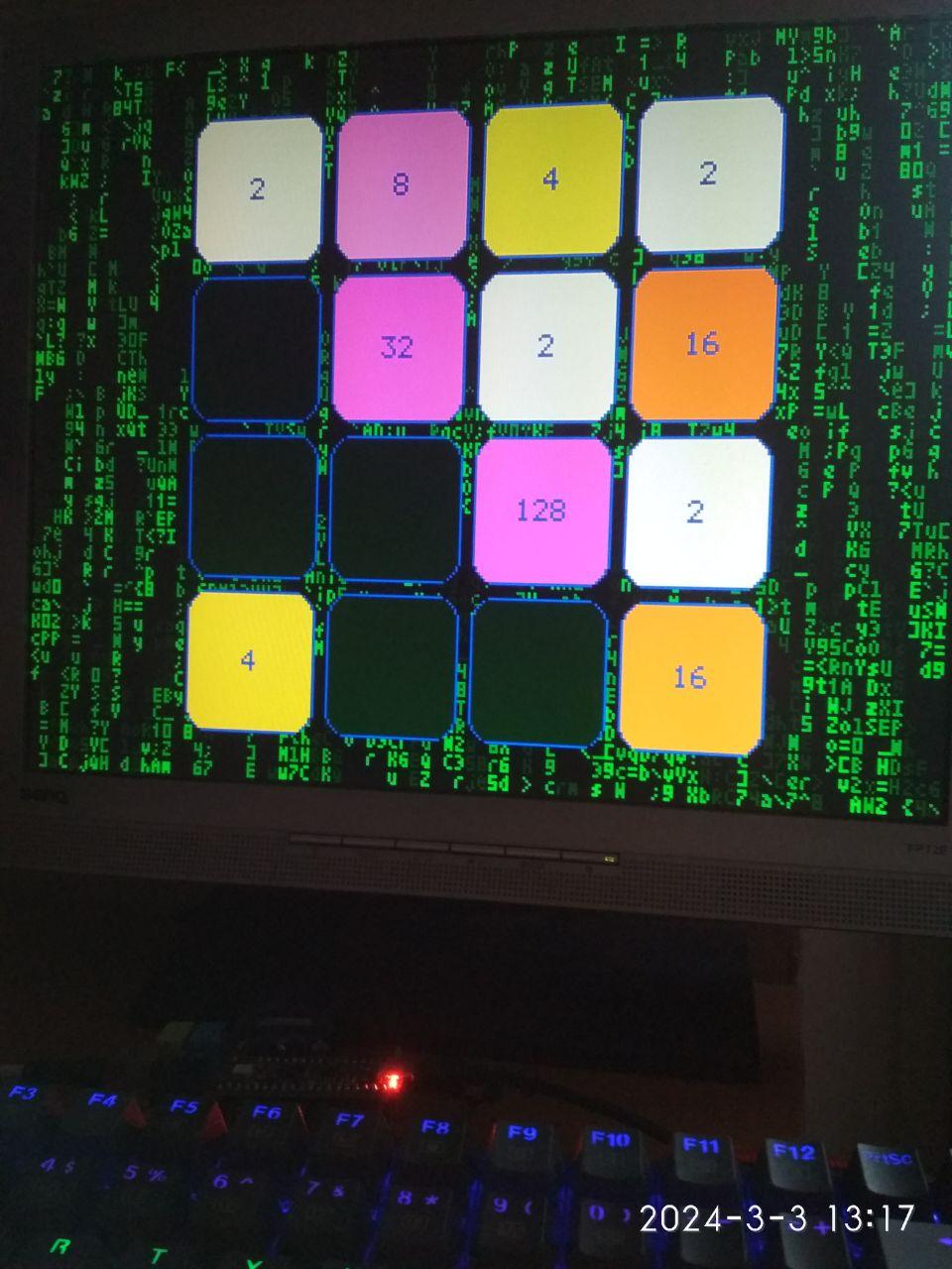

Posted: 11:26am 03 Mar 2024
Game "2048" on top of the current Matrix
2048.zip
Posts: 6187
Posted: 12:47pm 03 Mar 2024
Very nice,
Looks extremely polished. And works good. Had a few rounds of 256 and one of 512. Enjoyable to play.
Only one (minor) remark. The readability of the messages at end of game is not very good (orange color text on the green "matrix" background). Maybe some color changes or a frame around text could help.
Edited 2024-03-04 17:46 by Volhout

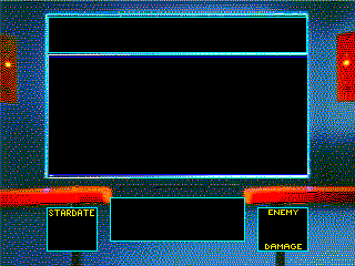

took a look and found that it would be the best, to keep the game in its 240x216 resolution. To keep it, all screen coordinates has an offset to be added (40 for x and 12 for y values) to keep it in center.
Screen than could look like this:

y=(stary(star)/starz(star))+88
If starz(star)>.3 Then cl=RGB(Cyan) Else cl=RGB(White)
If starz(star)>.6 Then cl=RGB(BLUE)
Inc starz(star),-0.02
If x>37 And x<270 And y>52 And y<156 Then Pixel x,y,cl:ox(star)=x:oy(star)=y
If x<=37 Or x>=270 Or y<=52 Or y>=156 Then starx(star)=0:stary(star)=0
End Sub
so replace every
Line (x1,y1)-(x2,y2),col,bf with bxf x1,y1,x2,y2,col
and every
Line (x1,y1)-(x2,y2),col,b with bx x1,y1,x2,y2,col
Syntax of Lines has to be cahnged
from Line (x1,y1)-(x2,y2)[,col]
to  Line x1,y1,x2,y2[,col]
Starfield set the integer var "maxstar=10" at start of the Program
Colornubers of the Maximite has to be  be translatet to the first 8 Colors of Picomite
colors:
 '--Colorscheme accordung to Spritecolors
 Data RGB(BLUE),RGB(GREEN),RGB(CYAN),RGB(RED)
 Data RGB(MAGENTA),RGB(YELLOW),RGB(WHITE),RGB(MYRTLE)
 Data RGB(COBALT) ,RGB(MIDGREEN),RGB(CERULEAN),RGB(RUST)
 Data RGB(FUCHSIA),RGB(BROWN),RGB(LILAC)
more to come (if you still want to port the Game to PicoMiteVGA)
sprites are cutted to PicoFriendly Sprite format
PICOTREK-resources.zip

One of the first games I bought for my ZX81 back then.
Who would have thought that I would be reprogramming it almost 43 years later
3D Monster Maze PicoMite VGA and others
Edited 2024-04-28 12:00 by Martin H.
