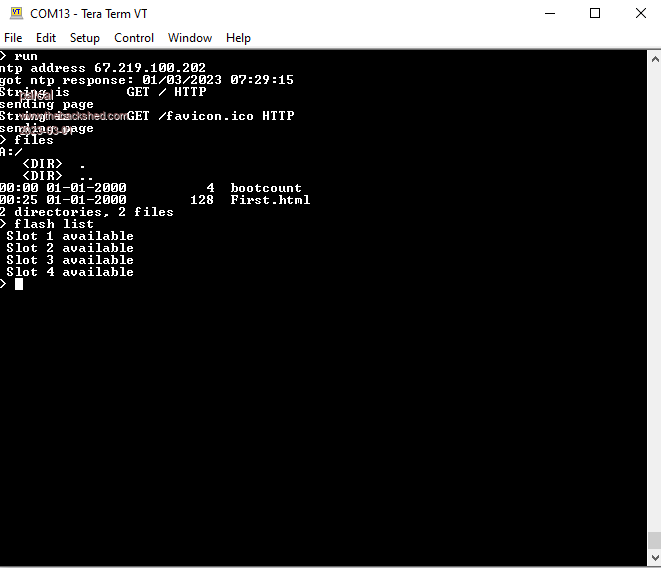

I have everything working OK except that
Why do I get the line "String is    GET/favicon.ico HTTP"
I did have Peter's web page loaded but it is no longer on the Pico so where did this line come from?

  palcal said  I have everything working OK except that
That's standard Browser behaviour. If you don't specifically provide an icon link for the page, it looks for "favicon.ico" by default. Once it gets the favicon, it won't ask/look again.

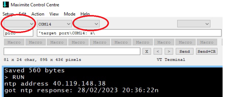

Posts: 6626
Posted: 04:56am 02 Mar 2023
Luc,
I noticed that your screenshots of MMCC have a few missing settings.
You should select 'picomite' as the device type. There are a number of things that this configures and users will have problems at times if this is not set correctly.
Even though the standard picomite configuration uses USB and the baud rate doesn't matter, some users will elect to use the alternative serial port which does require the baudrate to be set. Having a baud rate set will also allow MMCC to make a few decisions so it is definitely preferable to have the rate set. I use 115200 but any rate other than 1200 will do.
