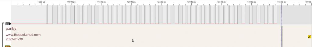

panky
Joined: 02/10/2012
Posts: 1135
Posted: 04:22am 30 Jan 2023
I've been able to capture both valid and invalid responses from the DHT11 with a Logic Analyser.
For the same temp and humidity, the response from the DHT11 for both valid and invalid responses are identical (number of pulses, pulse widths, pulse timing).
The only difference I can see is that and invalid response comes back from the DHT11 slightly quicker - varies a bit but roughly 50uS - 19.1mS after Pico takes the signal pin low for a valid response versus 19.05mS for an invalid response (ie. a temp/humidity of 1000).
As best as I can determine, the 1000 figure is not coming from the DHT11?
Will try to catch an invalid response at 250000.

panky
Joined: 02/10/2012
Posts: 1135
Posted: 10:40am 30 Jan 2023
As I go to bed for the night, 5200 loops with no errors at cpu speed 250000 and still counting.
Doug.

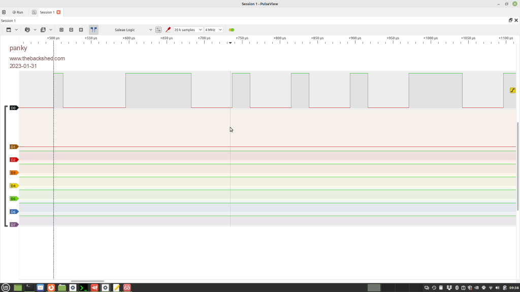

panky
Joined: 02/10/2012
Posts: 1135
Posted: 10:41pm 30 Jan 2023
I agree with Jim, my overnight run at 250000 cpu speed was 48000 cycles with no errors.
Catching both good and bad traces on the DHT11show no significant variation in timing of the pulse widths or inter pulse spacing.
The initial pulse is 12.75uS give or take 500nS (sampling error).
The space to the first pulse is 82.75uS +/- 500nS
A wide positive pulse is 87uS
The inter-pulse space is 54.25uS and the narrow positive pulse is 23.75uS
The first pulse shown above is the initial pulse from the DHT11.
Doug.

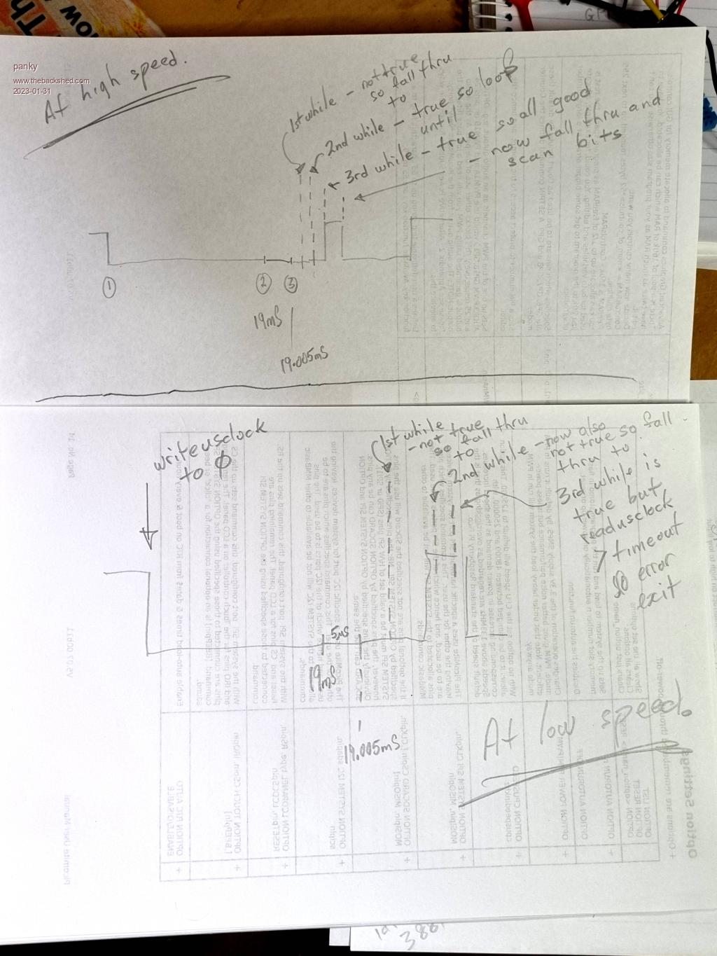

panky
Joined: 02/10/2012
Posts: 1135
Posted: 03:47am 31 Jan 2023
This might be a load of old coblers but I think the issue with DHT11 error rates high with low cpuspeed may be as follows:-
Referring to this section of code from External.c
   if(argc==7){
    dht22=getint(argv[6],0,1);
   // pulse the pin low for 1mS
// *** *** 1mS for DHT22 or 19mS for DHT11
   uSec(1000+dht22*18000);
   writeusclock(0);
   timeout = 400;
   PinSetBit(pin, CNPUSET); //#1
   PinSetBit(pin, TRISSET);
// ***at this point CRO indicates pin is low and stays low the whole 19mS if DHT11
   uSec(5);
   // wait for the DHT22 to pull the pin low and return it high then take it low again
//*** at this point, we have already waited 19.005mS and pin is already low for DHT11
   while(PinRead(pin)) if(readusclock() > timeout) goto error_exit; // pin lo so fall thru ??
//*** at low cpu clock I think we might miss the start of the timing pulse
// so the pin will now be high and thus fall thru the next line
   while(!PinRead(pin)) if(readusclock() > timeout) goto error_exit;
// *** again at lo cpu clock, I think we have missed the timing pulse so
// this next line will think it found the first data bit instead of the end
// of the timing bit ???
//    PInt(readusclock());PRet();
   // now we wait for the pin to go high and measure how long it stays high (> 50uS is a one bit, < 50uS is a zero bit)
   for(r = i = 0; i < 40; i++) {
    timeout=400;
       timeout=400;writeusclock(0);
       r <<= 1;
       r |= (readusclock() > 50);
I make absolutely no claim to fully understanding the code but it seems like it could be an area where timing might be affected by cpu speed.
Doug.
Edited 2023-01-31 14:03 by panky

panky
Joined: 02/10/2012
Posts: 1135
Posted: 04:10am 31 Jan 2023
Jim, How so?  For the DHT11, the delay in the code from the Pico is 1000mS + (1 * 18000) = 19mS
There is an additional 5uS before the WHILE statement. All my timings on both cro and logic analyser show the delay from when the Pico pulls the pin lo to when the timing pulse starts never less than 19.4mS?
Doug.
panky
Joined: 02/10/2012
Posts: 1135
Posted: 04:21am 31 Jan 2023
Given that the error exit can only come from either 1 of the 3 while statements associated with establishing the timing pulse or the 2 associated with actually reading the data and all my logic catches show the data to be correct for both good and bad readings, I think the more likely place where the error may be occurring is somewhere within the first 3 while statements?
Doug.
panky
Joined: 02/10/2012
Posts: 1135
Posted: 04:25am 31 Jan 2023
It may be that I am completely off the track    but at least I have had fun playing with the logic analyser and cro   Please don't make the assumption I actually know what I am talking about - just trying to look for possible areas of where the problem may be.
Doug.

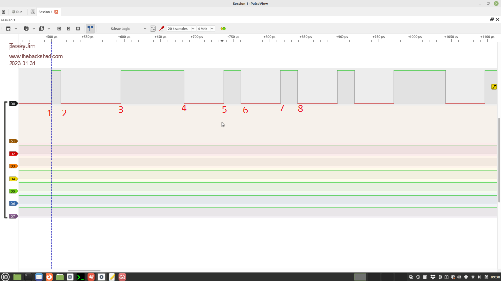

Posts: 6626
Posted: 07:03am 31 Jan 2023
On your trace.
transition 1 is the end of the 1mS or 19mS start pulse. timeout counter is reset here.
Control is handed to the DHT
1-2 5uS wait then 20uS wait while pin is high. while(PinRead(pin)) if(readusclock() > timeout) goto error_exit;
2-3 wait ~80uS while pin is low.               while(!PinRead(pin)) if(readusclock() > timeout) goto error_exit;
3-4 wait ~80uS while pin is high.              while(PinRead(pin)) if(readusclock() > timeout) goto error_exit;
4-5 is the first ~50uS low state in the FOR loop
5 is when the timeout timer is reset.         timeout=400;writeusclock(0);
7 is the next time the timer is reset ready to time the high state and watch for timeout.
A working system will have a maximum time of 5+20+80+80+50 = ~235uS plus another 10-20 elongated delays so well under the 400uS timeout
