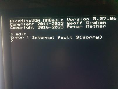

Joined: 11/04/2012
Posts: 1056
Posted: 06:03am 10 Jan 2023
I have upgraded a PiPico VGA to firmware release V5.07.06 and loaded the Mandelbrot program and all went well until I tried to raise the CPUSPEED to the higher value as mentioned by Peter at this point the Pico crashed. I power cycled it and to check if the program was still alive I typed EDIT and I received the following error message:
I reloaded a new uf2 file but now the unit rebooted spazmodically a few times and now is bricked.
Any clues?
OA47
Posts: 3416
Posted: 06:57am 10 Jan 2023
Perhaps that particular unit does not like being overclocked that far. Try to load an old incompatible .uf2 thus forcing it back to default settings (any non-VGA one might work). Then re-try the latest version.
Edited 2023-01-10 16:58 by phil99
Posts: 9238
Posted: 07:26am 10 Jan 2023
You could try using the flash nuke program first.
OA47
Joined: 11/04/2012
Posts: 1056
Posted: 07:54am 10 Jan 2023
Found a copy of 5.07.04b8 loaded it and now it does seem to be stable.
Upped the CPU speed to 252000 and still stable. Guess this particular unit doesn't like being overclocked that far. I will try another Pico and see if I get better behavior.
Thanks for the feedback again guys.
OA47
Posts: 3369
Posted: 11:31am 10 Jan 2023
The guaranteed method of clearing this sort of problem is to load the firmware file https://geoffg.net/Downloads/picomite/Clear_Flash.uf2 which will reset the Pico to its factory fresh state, then you can reload the PicoMiteVGA firmware.
Posts: 3416
Posted: 11:46am 10 Jan 2023
Thanks for the reminder. My senility advances, I used it myself a year or so ago. Still have a copy.

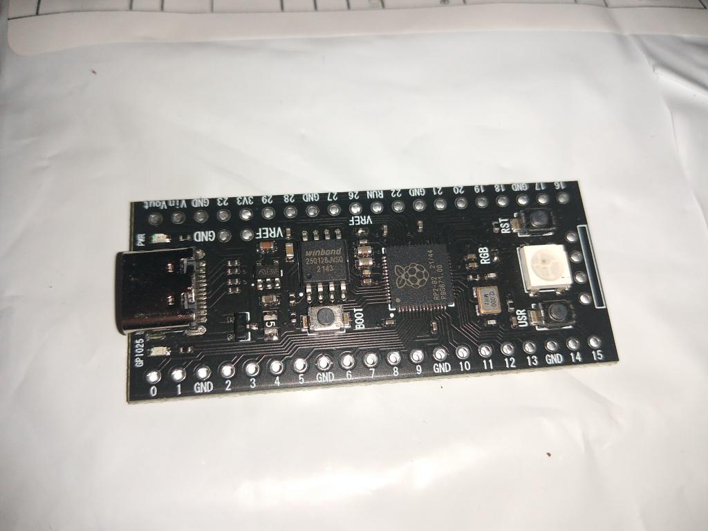

Tinine
Joined: 30/03/2016
Posts: 1646
Posted: 01:38pm 10 Jan 2023
Working great, here
Tinine
Joined: 30/03/2016
Posts: 1646
Posted: 01:39pm 10 Jan 2023
Nice module

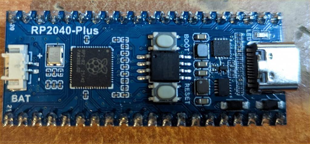

Craig
Posts: 12058
Posted: 01:59pm 10 Jan 2023
This is my favourite module
Waveshare RP2040-Plus
USB-C
Battery circuitry
Boot and Reset
16MB flash
total pin compatibility
Pluto
Joined: 09/06/2017
Location: Finland
Posts: 418
Posted: 02:02pm 10 Jan 2023
I have been using these modules since last autumn. Tested several of th 4MB models without problems. 16MB version on their way from China.
+ USB-C connector
+ Lower price than the standard green ones
+ On board WS2812B RGB LED.
Pluto
Joined: 09/06/2017
Location: Finland
Posts: 418
Posted: 02:03pm 10 Jan 2023
I was refering to Tinine's picture.
Tinine
Joined: 30/03/2016
Posts: 1646
Posted: 02:27pm 10 Jan 2023
Yeah, I got four....Didn't check re: pin compatibility though.
