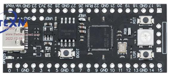

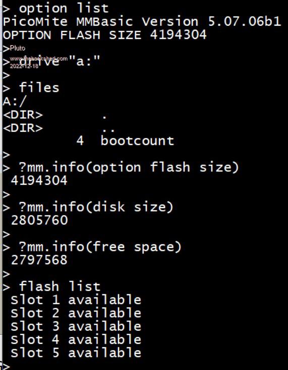

Posted: 07:10pm 17 Dec 2022
Tested on this type:
It has a Winbond 25Q32 flash (4MB). Seems to be OK.

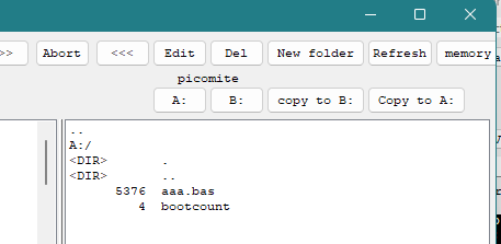

Posted: 03:15am 18 Dec 2022
Getting there:
Everything seems to work but it gets upset if you try to change to drive A: when you are already on drive A:
I need to add state checking to prevent that sort of thing.
I think I will add a "LOAD" button to transfer selected file to the main program memory ready to RUN
