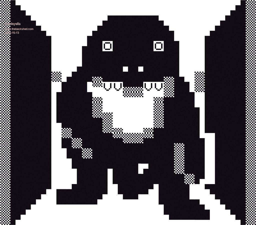

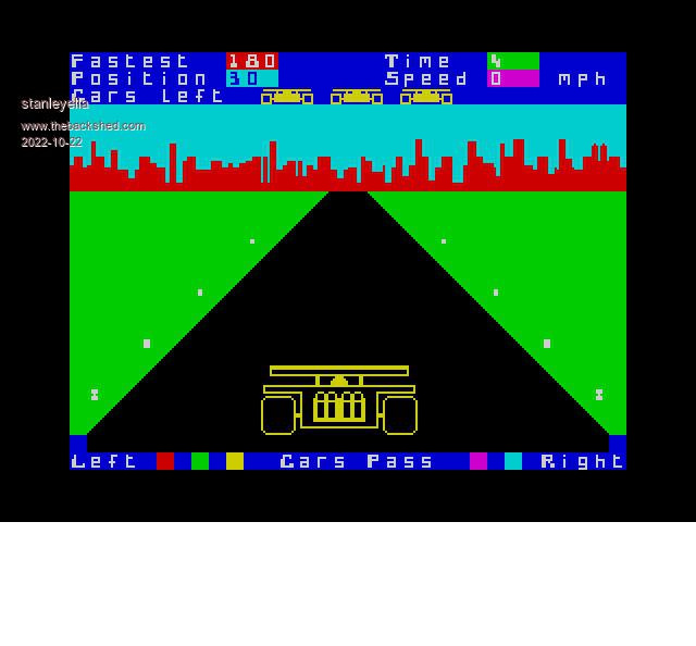

@ Martin H. char set for graphics? nostalgia?
Martin H.
Joined: 04/06/2022
Posts: 1570
Posted: 03:17pm 13 Oct 2022
3D Monster Mace   ... The problem is, that on VT100, you have not charset with those "Quarterpixels" like the ZX 81 had

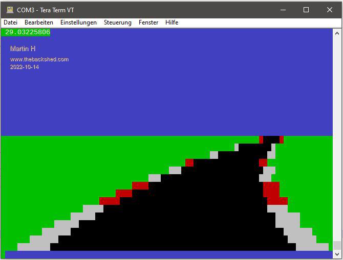

More Like this:
For PicoMite nonVGA
in Terminal..
(runs on a bare Raspberry Pico with MMBasic in VT100 Terminal)
CPUSPEED (KHz) 252000 (13.8 FPS @ 127000 KHz)
(will also run on PicomiteVGA in Terminal but much slower when the Line "Option Display SH%/8,SW%/4" is deleted and Prints garbage on the VGA Screen because it cannot process the VT100 escape sequences)
realy Nightly Build, as i woke Up at 3 AM
quick and dirty translated to VT100, sure there is room for improvements and optimizations
'VT_Road
Cur_off

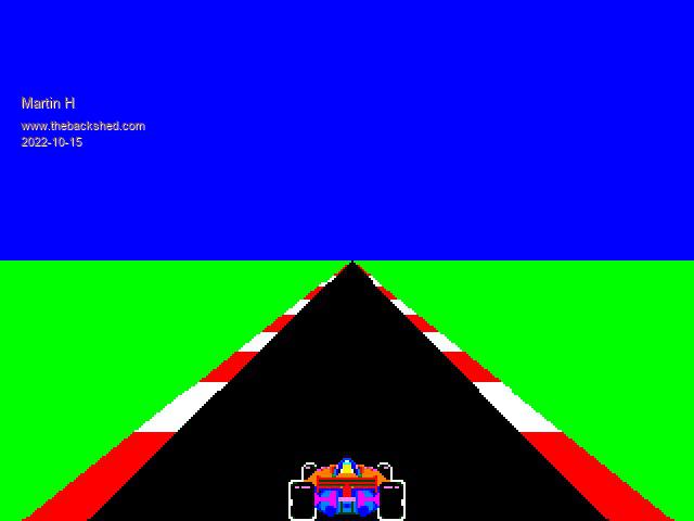

Martin H.
Joined: 04/06/2022
Posts: 1570
Posted: 07:37am 14 Oct 2022
back to the original listing.
The empty road is a little boring.
For this reason I've done some Pixelwork and designed a car which can be integrated into the original listing.

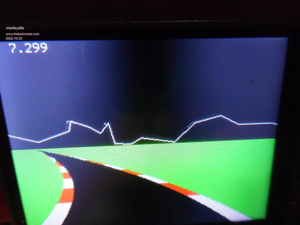

stanleyella
Joined: 25/06/2022
Posts: 2807
Posted: 02:47pm 14 Oct 2022
Sprite read needs to be blit read for non vga mmb. I will try but it is a big sprite.
Martin H.
Joined: 04/06/2022
Posts: 1570
Posted: 03:14pm 14 Oct 2022
  stanleyella said  Sprite read needs to be blit read for non vga mmb. I will try but it is a big sprite.
actually this are 2 Sprites in one... The right Side is a little different from the left Side.
Since the car is symmetrical, I only read half of the car with each sprite and then draw them once mirrored and once normal
I was too lazy to draw the sprite 2 times
Both Programs in combination it looks like this

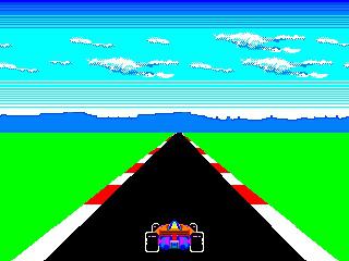

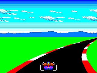

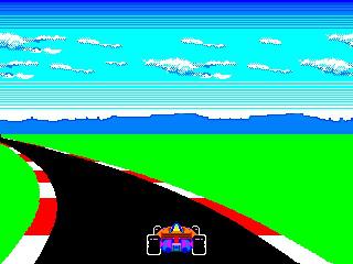

next evolution
added the Car and painted a Background
CPUSPEED 378000

'b3x% right x position of the street and left x position of the right Border
'b4x% right x position of the right Border
'BB% Border broad
'bc% Border Color (red or white) calculated over Sinus Function
'HH% Half Screen y-Res  HW% Half Screen x-Res
'xofs%() Pre calculated Curve over Exponetial function
'ofsx% how much has the Curve to be bended
Sub do_bg dir%
 Box 0,hh%+2,SW%,hh%-2,,COL%(2),COL%(2)
 For F%=2 To HH%
   bc%=bcol%(dst%,f%):ofs%=xofs%(2,f%)*n*dir%:y%=hh%+f%:BB%=f%/4
   b1X%=HW%-F%-bb%+ofs%:b2x%=HW%-F%+ofs%
   b3x%=HW%-F%+ofs%+2*f%:b4x%=b1x%+(2*bb%+2*f%)
   Line b1x%,y%,b4x%,y%,,bcol%(dst%,f%)
   Line b2x%,y%,b3x%,y%,,0
 Next
 Inc dst%:If dst%>6 Then dst%=1
End Sub
'--- Moves the Background while driving a curve
Sub Mov_sky dir%
Local mv1%=1,mv2%=2
If dir%>0 Then
 Sprite read #31,0,28,mv2%,22
 Sprite Mv2%,28,0,28,320-mv2%,22
 Sprite write #31,320-mv2%,28
 Sprite read #31,0,50,mv2%,22
 Sprite Mv1%,50,0,50,320-mv1%,22
 Sprite write #31,320-mv1%,50
 Sprite read #30,0,102,mv2%,10
 Sprite Mv2%,102,0,102,320-mv2%,10
 Sprite write #30,320-mv2%,102
Else
 Sprite read #31,320-mv2%,28,mv2%,22
 Sprite 0,28,mv2%,28,320-mv2%,22
 Sprite write #31,0,28
 Sprite read #31,320-mv2%,50,mv2%,22
 Sprite 0,50,mv1%,50,320-mv1%,22
 Sprite write #31,0-mv1%,50
 Sprite read #30,320-mv2%,102,mv2%,10
 Sprite 0,102,mv2%,102,320-mv2%,10
 Sprite write #30,0,102
EndIf
'Sprite CLOSE 31
End Sub
Sub do_car
 If dist% Mod 2 Then
    Sprite write #1,132,200
    Sprite write #1,160,200,1
 Else
    Sprite write #2,132,200,1
    Sprite write #2,160,200
 EndIf
End Sub
Sub read_Sprites
 Local nr%,p%,n%,byt$,m$
 '--- Read/Create Sprites
 Restore car
  For p%=1 To 31
   Read Byt$:Byt$=expand$(Byt$)
   For n%=1 To Len(Byt$)
    m$=Mid$(Byt$,n%,1)
    Pixel n%-1,p%,COL%(Val("&H"+m$))
   Next
  Next
 Sprite read #1,0,0,28,32
 Sprite read #2,28,0,28,32
End Sub
Function expand$(pxl$)
 Local n%,nmb%,tmp$,co$
 For n%=1 To Len(pxl$)
   If Asc(Mid$(pxl$,n%,1))< 71 Then
     tmp$=tmp$+Mid$(pxl$,n%,1)
   Else
     co$=Hex$(Asc(Mid$(pxl$,n%,1))-71)
     Inc n%:nmb%=Val("&H"+Mid$(pxl$,n%,1)):tmp$=tmp$+String$(nmb%+1,co$)
   EndIf
 Next
 expand$=tmp$
End Function
Sub on_break
 Sprite CLOSE all: FRAMEBUFFER CLOSE
 MODE 1: Option Break 3
 End
End Sub
colors:
'--Colorscheme accordung to matherp
Data RGB(BLUE),RGB(GREEN),RGB(CYAN),RGB(RED),RGB(MAGENTA),RGB(YELLOW),RGB(WHITE
Data RGB(MYRTLE),RGB(COBALT),RGB(MIDGREEN),RGB(CERULEAN),RGB(RUST),RGB(FUCHSIA)
Data RGB(BROWN),RGB(LILAC)
car:
Data "GFGFGFG7","GFGFGFG7","GFG9P3GFG9","GFG8917719GFG8","G8N3GA91J319GAN3G8"
Data "G7788087G5EECF11M311FCEEG5780887G7"
Data "G678FF00800FDCFC48F11M311F84CFCDFG77G6"
Data "G67G5DD4U2C4B107M3701B4CU24DDG2FF07G6","G67G4U6C4B107M3701B4CU6G47G6"
Data "G67G3U8AB1U71BAU8G37G6","G67G2U24CU4AAU9AAU4C4U2G27G6"
Data "G6700U3KFKBU3007G6","00N5U54OFO94U5N500","07788G6EEKFKBEEG688770"
Data "078G9E4OB44OB4EGA70","0700FF0V3001KAEK3EKA1GA70"
Data "07GA14HAK3HA4100V30FF0070","07GA14019R255911K311955R291041GA70"
Data "07GA5119R2L2911K3119L2R29115G9770","07GA551R3L2911K3119L2R3155G9770"
Data "07GAL99V79L9G9770","077G9L99V79L9GA70","077G9551R3L29B8R38B9L2R3155G9770"
Data "077G9519R3L29B891198B9L2R3915G9770"
Data "07GA919BB9H259B891198B95H29BB919GA70","07GA791BBH49B8R38B9H4BB197GA70"
Data "07GA70819H49B8R38B9H491807GA70","07GA7G2H489O9H5007GA70"
Data "078G887G4H2GBH2G478G8870","0778G6877GFGB778G68770","00NAGFGDNA00"
and the Backgroud image file( BMP must be stored in the same folder):
Sky.zip
have Fun
Mart!n
Edited 2022-10-22 03:05 by Martin H.

stanleyella
Joined: 25/06/2022
Posts: 2807
Posted: 05:20pm 21 Oct 2022
I like the way you are going with this.
I knew some guys in the 80's doing it for zxspectrum.
stanleyella
Joined: 25/06/2022
Posts: 2807
Posted: 05:50pm 21 Oct 2022
Not easy to convert to lcd mmb but am trying.

stanleyella
Joined: 25/06/2022
Posts: 2807
Posted: 08:24pm 22 Oct 2022
I get errors like
RUN
[100] Blit write #2,132,200,1
Error : Syntax
when usibg blit instead of sprite.

Here's a modification to include a track.
At the very end is a data block that encodes the track. You can change it for any course you might like.
I'm not sure if I have the sky movement correct. I don't have an SD card connected, so I can't load the sky graphic to test.
autosave

Posts: 6625

stanleyella
Joined: 25/06/2022
Posts: 2807
Posted: 12:16am 23 Oct 2022
  TassyJim said
  stanleyella said  I get errors like
RUN
Error : Syntax
The available commands are:
BLIT READ #b, x, y, w, h
BLIT WRITE #b, x, y, w, h
BLIT LOAD #b, f$, x, y, w, h
BLIT CLOSE #b
In the VGA firmware, you can flip the sprites. This is not available in the TFT version so you will have to create the flipped side of the car as an additional sprite.
A lot more to do to convert to non vga but the road works and I can redo the car as any sprite.. sorry blit.
Nice road code. Lots of maths to learn. I am impressed.
My version of scrolling was slow using blit but that was lcd.
Using blit read blit write was faster than using blit x1,y1,x2,2,w,h
option DEFAULT INTEGER
OPTION EXPLICIT
dim counter
cls
'landscape
line 0,0,20,8
line 20,8,32,16
line 32,16,42,4
line 42,4,48,30
line 48,30,68,31
line 68,31,80,24
line 80,24,92,26
line 92,26,120,31
line 120,31,144,8
line 144,8,176,0
line 176,0,198,12
line 198,12,240,12
line 240,12,280,24
line 280,24,316,12
line 316,12,319,0
do
 for counter = 1 to 100
   scroll_left
 next counter
   scroll_right
 next counter
loop
sub scroll_left
 blit read 1,0,0,4,32
 blit read 2,4,0,316,32
 blit write 2,0,0,316,32
 blit write 1,316,0,4,32
 blit close 2
 blit close 1
end sub
sub scroll_right
 blit read 1,316,0,4,32
 blit read 2,0,0,316,32
 blit write 2,4,0,316,32
 blit write 1,0,0,4,32
 blit close 2
 blit close 1
end sub
Edited 2022-10-23 11:22 by stanleyella

Hi Stanley
RUN
Error : Syntax
BLIT CLOSE #b
ok, if the Version cannot Flip the Sprite/Blit you can modify the Read procedure and Flip them while creating:
Sub read_Sprites
Restore car
 For p%=1 To 31
  For n%=1 To Len(Byt$)/2
   m$=Mid$(Byt$,n%,1)
   Pixel 56-n%,p%,COL%(Val("&H"+m$))
   m$=Mid$(Byt$,Len(Byt$)-(n%-1),1)
   Pixel n%-1,32+p%,COL%(Val("&H"+m$))
   Pixel 56-n%,32+p%,COL%(Val("&H"+m$))
   Next
 Next
Sprite read #1,0,0,56,32:Sprite read #2,0,32,56,32
Pause 5000
End Sub
so you have 2 fullsize Sprites.
with little Changesin the do_car sub
Sub do_car
 If dist% Mod 2 Then
 Else
 EndIf
it should do the job
Mart!n
