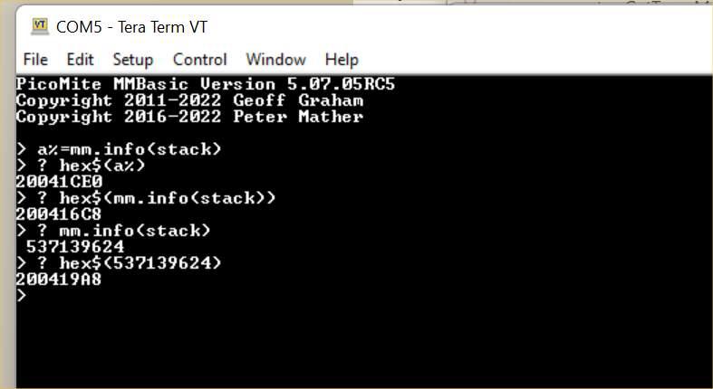

Have a play with this version. This includes two new mm.info functions
mm.info(stack) returns the current value of the C stack pointer
mm.info(heap) returns the amount of MMBasic heap memory free
In addition I have implemented stack checking in various places. An error will be thrown if the stack pointer goes below &H2003f800. If it does it hits the C heap which is used by the USB CDC code and after that hits some critical firmware variables hence the strange error messages you have seen

Using the new diagnostics you should be able to tune the chess code to run within the limits of the PicoMite. NB: there is no way to increase the C stack allocation without reducing the MMbasic heap size (variable area)

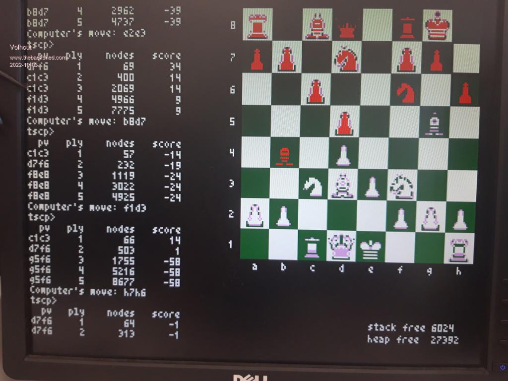

Posts: 6185
Posted: 09:33am 03 Oct 2022
Hi Kevin,
I made some improvements, and added stack level and heap level to the screen.
Have your code running for one hour (playing itself) and not problems.
I will PM the code later today when I have more confidence (with your proposed changes).
Stack levels and heap levels seem to leave 23k free (stack starting at 36k, heap at 26k).
EDIT: correction, the C-stack is only 8.8k and often reaches 2k level... This is seriously close to crashing. But it keeps running with the levels you set. I will need to improve more....
Thanks Peter, for this tool....
Edited 2022-10-03 19:53 by Volhout

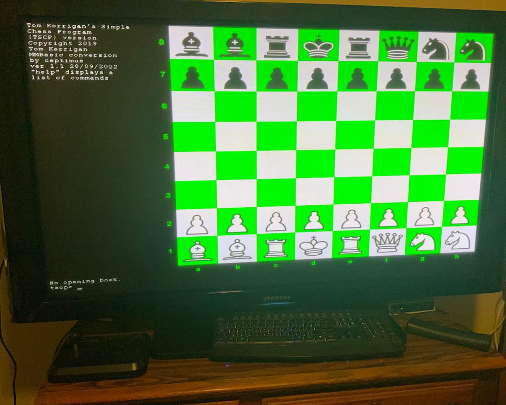

Hi, yes, I claim no credit for converting it to MMBasic from C, other than getting the version from Bar1010 working on the Pico. The graphics are quite poor, simply a rescale of Bar1010 pieces, they need to be improved but I'm away from home at the moment.
Question for Ceptimus or Bar or Peter, I have tried Emailing Tom Kerrigan several times now to ask for permission to publish a PicoMite version of Chess, this is on the Email from his website, but I've had no response, do you know of a better address?
As you can see it's quiet slow, but may be ok for a casual player. I would think that if the original C could be compiled as a csub if that is even possible, with MMBasic providing the user interface it would then potentially give quite acceptable results.
