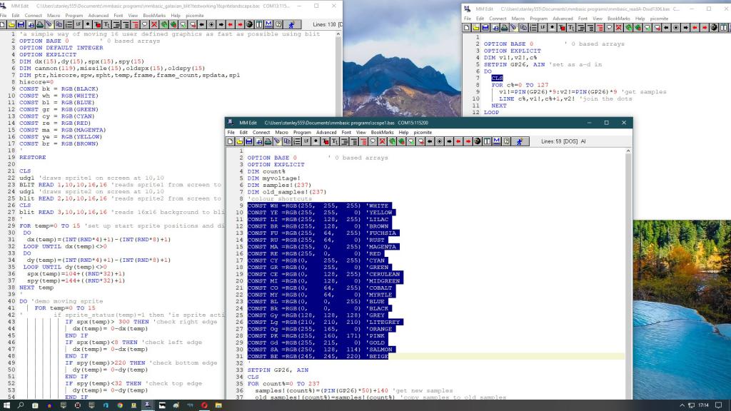

Mik, I am liking mmbasic, It is all new and shiny and easy enough that even I can use it, The built in editor which I use with teraterm is totally new,
It is a small screen and make full screen loses the f1,f2, info panel.
I have spent hours trying to use it and still it is a pain to use.
Someone said they go icon blind using mmedit. and me. but it so familiar to use.
I have no connections with the author of mmedit but it is an alternative for win users.
notepad++ or geany no, not setup.
Posts: 9232
Posted: 09:25pm 29 Aug 2022
I know what you mean, but no matter what the editor interface is, it's very important that what you think is a hardware bug isn't actually a problem with the way you are using the editor because you have missed something about how it does something. Having a simple, lowest common denominator editor that everyone has removes that possibility.
Windows applications are designed to have similar user interfaces, which is why you are comfortable with MMEdit. That doesn't mean that they all work in the same way though, only that they have a similar look and feel. IIRC, MMEdit uses routines in the MMBasic editor to do file transfers etc. It simulates the keystrokes that a user would make if operating the editor directly. It's not actually changing the memory of the Pico directly as you might expect. (I'm sure someone will correct me if I've made any glaring errors in these statements! :) ).
If you are using the console connection (the USB connection) then the editor screen can easily be over 40 lines of over 100 characters if you want. You can make it a size that you are comfortable with. Editing on a ILI9341 or even a SSD1963 LCD screen is *not* recommended (although the SSD scrolls much faster)! It certainly isn't a small screen, it can be as big as your monitor. :) It's also *very* fast to use. Simply function key driven. No delays as the program is transferred. All possible commands are in a neat line across the bottom of the screen.
Tera Term will let you set the maximum size of the display (in lines & characters) as well as the font to use. This is then backed up by the OPTION DISPLAY in MMBasic.
