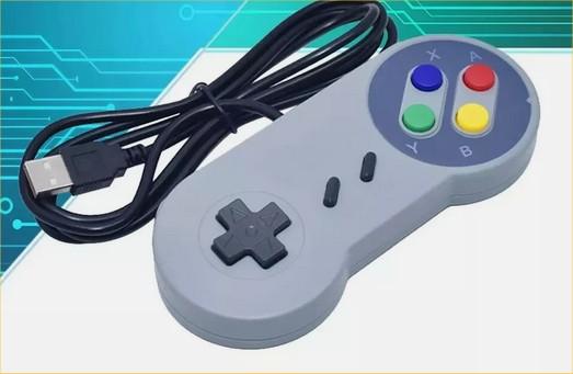

Note however that there may be a wrinkle to sort out with the generic 12-button USB controllers; @Mixtel90 has one where the D-pad is not reading as button presses but instead as the left-analog stick pushed to its maximum extent. If/when I escape MMB4L I will do some testing of my own.

Posts: 12042
Posted: 12:31pm 01 Oct 2024
Thanks for the controller which I have sorted. RC3 on the main thread will have support so please check with your other device.
Should be supported on any USB variant RP2040 and RP2350

Posts: 12042
Posted: 02:26pm 01 Oct 2024
PM me your address and I'll send the controller back (if it ever stops raining so I can get to the post office )
Posts: 9228
Posted: 02:35pm 01 Oct 2024
Just tested it. It works beautifully. :)
