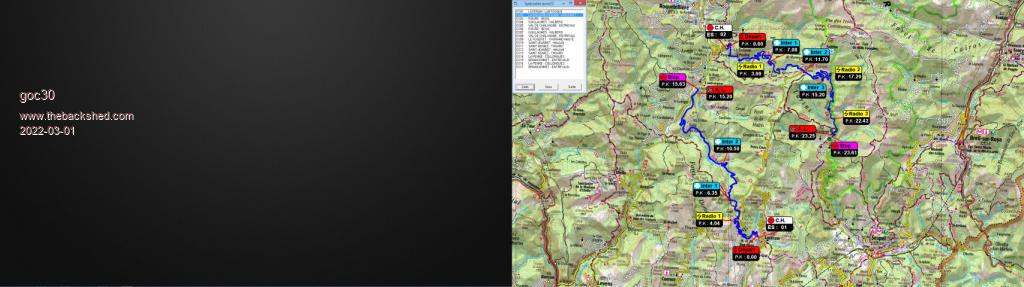

  matherp said  How about I get rid of full screen mode completely but create a new mode for 1080p screens which is the maximum size that will fit above the task bar completely within the screen. Something like 1850x980? I can play with the setting to get the optimum
MS Window, from win3.11 to win11 can draw window with or without any border in full screen  from EGA to XGA or Full HD, I don't understand why it is not possible in MMBasic.
I have somes progs who use full screen without border, like Maps, for 1 to 4 screen. It work perfect with vb6, but now with win10 and win11, it is more difficulte to execute. For that I can be interesting by MMB, but if it is not possible to work in full screen without border, I must search other langage Lazarus or Purebasic
exemple

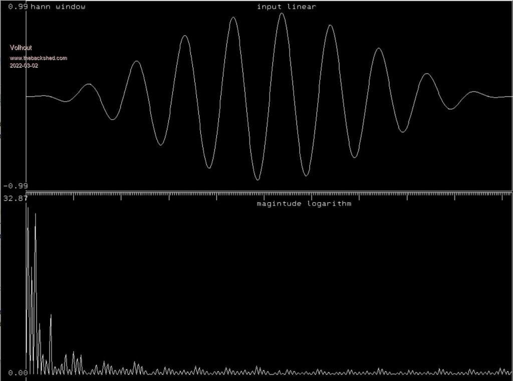

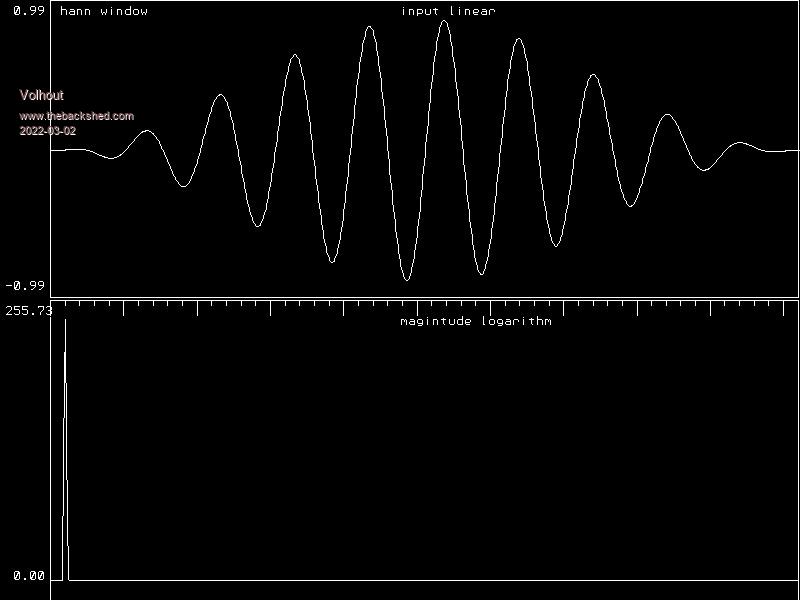

Hi Peter,
Please check the MATH FFT function. For CMM2 we had to fix it, and for MMB4W we seem to run into a similar issue (although not identical).
When I take the FFT magnitude from a sinesquare windowed sine wave, and display it in linear scale, it should look like this (CMM2 fft calculation from below program):
However, the MMB4W math function shows many spurious peaks. Below graph shows the sinesquare windowed sine signal (top), as well as the fft (lower graph)
I use this code to check it (the program can change the windowing function with "w", and change the number of sinewaves for fft with "a" and "z", and save the graph to disk with "s").
'check fft magnitude function
n=1023 'samples
cy=10  'cycles
sq=0   'sq=1 = square wave. sq=0 = sine wave
dim a!(n),fm!(n)
w=0  'window type, 0=none
do
 cls
 'draw 2 frames using mm.hres mm.vres
 box 50,0,(mm.hres-51),mm.vres/2-2
 box 50,mm.vres/2,mm.hres-51,mm.vres-1
 'prepare input signal
 sinfill
 if k$="w" then w=(w+1) mod 4
 if w then window
 'plot input signal
 plot_in
 'do fft
 math fft magnitude a!(),fm!()
 'convert to logaritm
 'lin2log
 'plot fft
 plot_fft
 'keyboard commands
 do
   k$=inkey$
 loop until k$<>""
 if k$="a" then cy=cy+1
 if k$="z" then cy=cy-1:cy=max(cy,2)
 if k$="s" then save image "fft",0,0,800,600
loop until k$="q"
end
'subroutines
'fill the input array a!() with cy cycles of sinewave
sub sinfill
 for i=0 to n
   a!(i)=sin(2*pi*cy*i/n)
   if sq=1 then
     if a!(i)>0 then
       a!(i)=1
     else
       a!(i)=-1
     end if
   end if
 next i
end sub
'apply a window over the input signal (triangle for now)
sub window
 if w=1 then
   for i=0 to n/2  'linear
     a!(i)=(i/n)*a!(i)
     a!(n-i)=(i/n)*a!(n-i)
   next i
   ? @(60,5) "triangle window"
 else if w=2 then
   for i=0 to n    'quadratic (do linear twice)
     a!(i)=(i/n)*a!(i)
   next i
   ? @(60,5) "quadratic window"
 else if w=3 then
   for i=0 to n    'sine^2 (hann) window
     a!(i)=sin(pi*i/n)*sin(pi*i/n)*a!(i)
   next i
   ? @(60,5) "hann window"
 end if
end sub
'plot the input signal in the upper window
sub plot_in
 'find minimum and maximum
 mi!=0:ma!=0
 for i=0 to n
   mi!=min(mi!,a!(i))
   ma!=max(ma!,a!(i))
 next i
 '? mi!,ma!
 'calculate gain and offset to fit it into the window
 xgain=(mm.hres-50)/n
 xoffs=50
 ygain=-(mm.vres/2.3)/(ma!-mi!)
 yoffs=mm.vres/4-ygain*(ma!+mi!)/2
 'plot the actual samples  using linear interpolation
 for i=0 to n-1
   line i*xgain+xoffs,a!(i)*ygain+yoffs,(i+1)*xgain+xoffs,a!(i+1)*ygain+yoffs
 next i
 'add legend
 ? @(mm.hres/2,5) "input linear"
 ? @(5,5) str$(ma!,2,2)
 ? @(5,mm.vres/2-20) str$(mi!,2,2)
end sub
'plot the fft output in the lower window
sub plot_fft
 'find min and max and where max is
 mi!=1e6:ma!=-1e6
 for i=0 to n/2  'fft output is symetrical
   mi!=min(mi!,fm!(i))
   ma!=max(ma!,fm!(i))
   if ma!=fm!(i) then cf=i':? cf
 next i
 'apply some logaritmic scaling
 'mi!=-120:ma!=60
 'mi!=0:ma!=200
 'mi!=max(mi!,-140):ma!=min(ma!,120)
 'for i=0 to n
 '  fm!(i)=min(ma!,max(mi!,fm!(i)))
 'next i
 'calculate scaling to fit the window
 xgain=2*(mm.hres-50)/n
 xoffs=50
 yoffs=mm.vres-mi!*ygain-20
 'plot the fft graph
 for i=0 to n/2-2
   line i*xgain+xoffs,fm!(i)*ygain+yoffs,(i+1)*xgain+xoffs,fm!(i+1)*ygain+yoffs
 next i
 'add legend
 ? @(mm.hres/2,mm.vres/2+15) "magintude logarithm"
 ? @(5,mm.vres/2+5) str$(ma!,2,2)
 ? @(5,mm.vres-30) str$(mi!,2,2);
 'put marker ticks in multiples of centre frequency
 for i=0 to n/2-2 step cf
   line i*xgain+xoffs,mm.vres/2,i*xgain+xoffs,mm.vres/2+5
   if ((i mod(5*cy)) = 0) then
     line i*xgain+xoffs,mm.vres/2,i*xgain+xoffs,mm.vres/2+15
   end if
 next i
end sub
'convert linear output to logarithmic
sub lin2log
 for i=0 to n/2
   fm!(i)= 20*log(fm!(i)+1e-300)/log(10)
 next i
end sub
Edited 2022-03-02 17:27 by Volhout

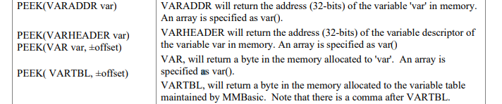

Posts: 4405
Posted: 09:37am 03 Mar 2022
  KD5ZXG said  We may already have a way for finding variables I am unaware of.
CMM2 Manual:
And there are corresponding POKEs for VAR and VARTBL.
PEEK(VARHEADER) is currently unimplemented in MMB4W but I suspect that is just an oversight that Peter will address.
This doesn't help with the DATA pointer since that is not an MMBasic variable - and infact is two internal variables which need to be updated as a single atomic unit.
  KD5ZXG said  What feature is missing that wants direct access to this pointer?
There is a fundamental design flaw in the whole BASIC DATA concept, you can't iterate through multiple DATA sections "simultaneously" because there is only one (hidden) pointer. Workarounds include either reading an entire DATA section into memory before operating on it, or designing the format of your DATA such that you can always RESTORE it to the start and then iterate through it to find a point you were at previously.
Anway, I have an idea, time to "Fire up the Quattro" - bonus pop culture points for anyone who knows the reference without looking it up.

Fourier transform works on repetitive signals. (google "wiki FFT").
In theory these signals repeat until eternity.
If you take a snapshot of these signals (i.e. 10 sine waves) the beginning and the end of the 10 sine waves represent a distortion of the "eternal signal", they are distortions.
To minimize the disruption effect of the beginning and end of the snapshot, each sample in the snapshot is "weighted". It's contribution to the Fourier Transform is made more -or less- important. The "weighting" is called "windowing".
There are many types of windows. There is a rectangular window (meaning all samples have the same weight), there is triangular weighting (the first and last samples have zero weight, the centre samples have maximum weight. Samples in between have a weight that is a linear interpolation between first and centre sample.
If you execute the program in my post, and press "w" a few times, you see a number of windowing techniques, and the effect on waveform and FFT.
One of the weighting standards is the "Hann Window". This is similar to the triangular windowing, but samples between first and centre are weighted with a sine^2 function.
Play with the program, and experience.
Vohout
note: the FFT window shows linear magnitude FFT for demonstration purpose (the lin2log function is commented out).
Edited 2022-03-03 20:24 by Volhout
