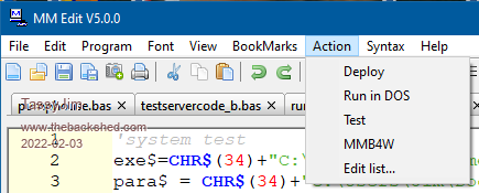

I currently have .BAS files associated with MMEdit and run the MMBasic program by clicking on the gear icon or the running man as appropriate. I would like to be able to associate .BAS programs with both MMEdit and MMBasic.exe but Windows doesn't allow that.
I was thinking of either another batch file to choose between MMEdit and MMBasic and maybe Notepad as well or just right clicking on the .BAS file and choosing 'Open with' (probably easier).
Do you have an alternate?
Is it possible to use the one instance of MMEdit with either version of MMBasic.exe? Somehow choosing which version to run.

  Turbo46 said  Hi Jim,
I use right-click to run using another program (usually notepad++)
In MMEditV5, you can configure as many external programs as you desire.
The first one in the list will be the one that runs when you click on the gear icon. It doesn't have to be MMBasic.exe
I may add a second icon.
