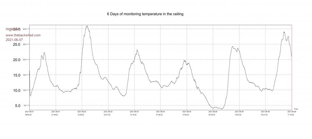

Aaron, since you mentioned the air temp in your roof cavity being worth harvesting, I put a datalogger in my ceiling about 30cm under the peak to see what ours was like. We have black tiles, so would have thought it would be reasonably high.
After 6 days I took it out and downloaded the results. Definitely a dead loss for our house. Temps were very poor.
Cheers,  Roger

  Quote  After 6 days I took it out and downloaded the results. Definitely a dead loss for our house. Temps were very poor.
And you have black Tiles? Sarking under them I presume?
Can't get near my roof in summer, Mt recollection of winter temps up there were not promising as well. I'll check again but given your results tie in with what I remember....
Like Inverters. Get hot enough to fry eggs on if uncooled but it winter with very similar power running through them they are barely warm.  The temp difference is in no way Linear to the ambient difference that's for sure!

  Quote  The test setup was working today in the clear warm sun, the first since last weekend I think. Most of the days here have been cold and overcast with a couple not reaching Double Digits.
Sounds like we're a bit luckier than you. We had one dud day this week and a couple that had a slow start but came good at least for a while  ...  but today was an absolute ripper.
From 10:15 - 15:45 it stayed above 30 degrees and reached 39.2 at the peak. That's 5 and a half hours with the fan on its highest speed. Got almost uncomfortably warm inside  ...  but I'll take that.
Can't wait to hear your results with the next lot of tests. Good luck.
Cheers,  Roger
