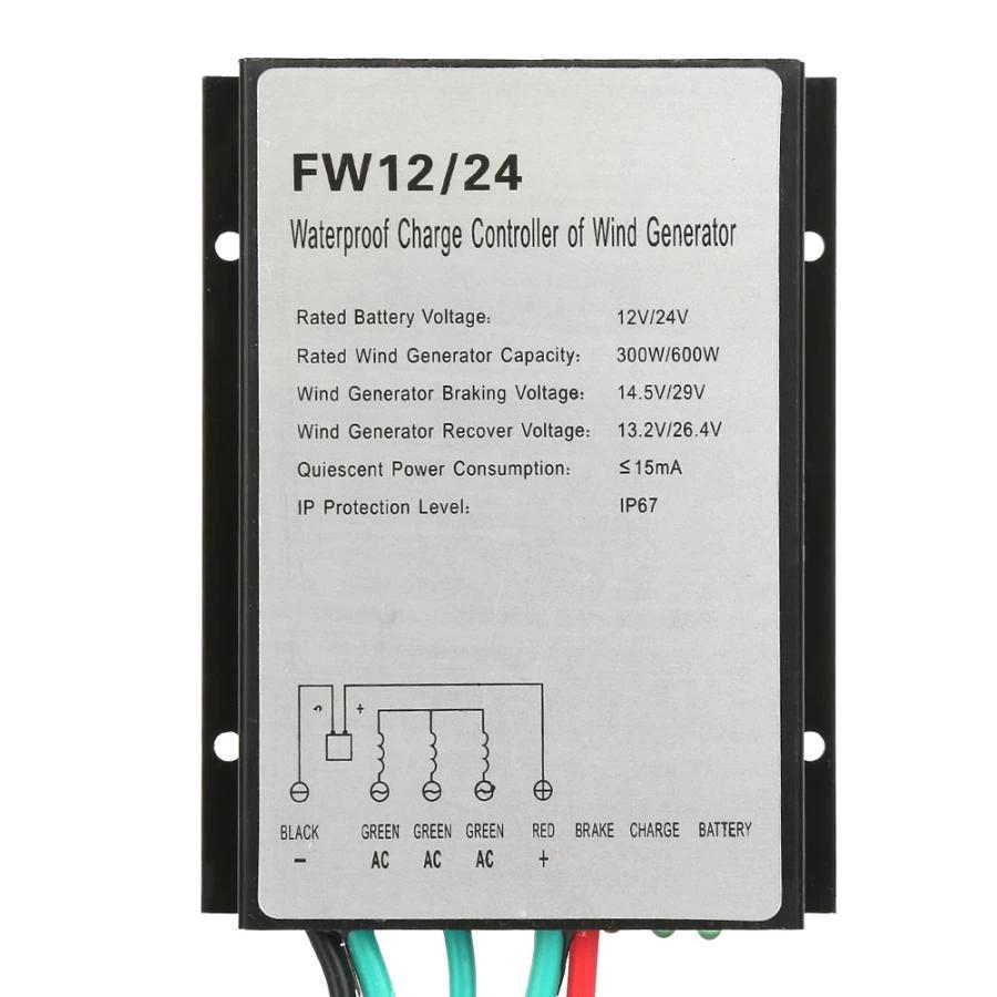

  Technophiliac said
  pollenface said  I have the 1000w boost/mppt controller from ebay $65AUD.
It works, but my turbine has never produced more than 225w in a single instance.
Would you please advise the brands and model numbers or give url's?
Here you go
https://tinyurl.com/37j8u46t
Off grid man caver
Technophiliac
Joined: 18/12/2020
Posts: 92
Posted: 05:09am 25 Oct 2021
  pollenface said
Here you go
Thanks for your suggestion of "Wind Turbine Charge Controller Waterproof 40A Voltage Boost Low Speed Regulator" - 12/24V. 12V @40A = 480W. Not going to cut it.
Maybe two PWM in parallel might work?
