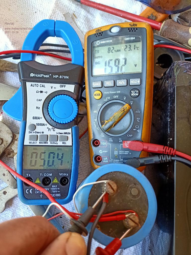

I hadn't taken any proper power reading's up until now as it was experimental to see what happens.
With a battery charger that can supply large amperage and a clamp meter over the wire going to the cell, the first zap measured about 50Amp as it is almost a dead short, just to confirm that, the amp meter needle on the battery charger went past 40Amp and hit the stopper.
The next zap (measured on the clamp meter) was about 45A then next was 40A and so on as the resistance of the cell increased.
The last pack of cell's, I only give them 9 dumps from the capacitor & charger, just to see if the results would differ.

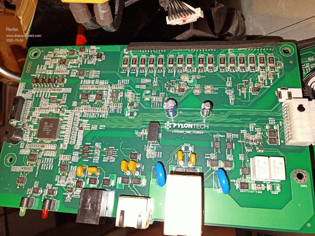

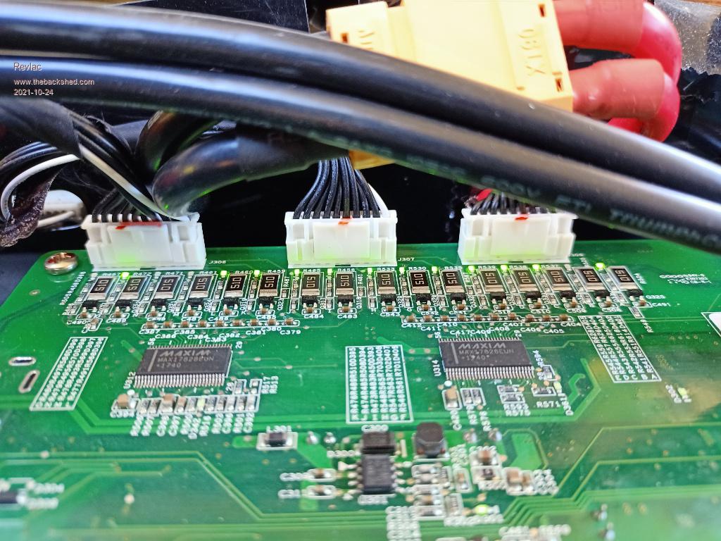

Time for some fault finding, Underside of the balancer, can see a row of balance resistor's, couldn't see anything unusual.
More checking and probing around on the common port under over voltage MOSFET board, found a shorted diode on the power supply section, this took out the PTC fuse that supplied that section.

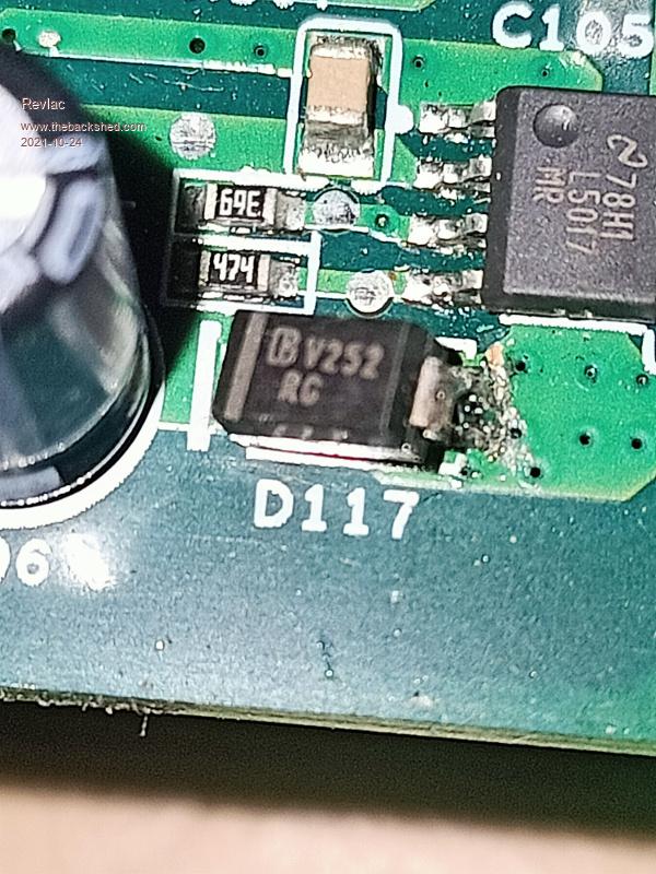

It was a bugger to trace this thing, there is a middle layer in the pcb that carries the positive power.

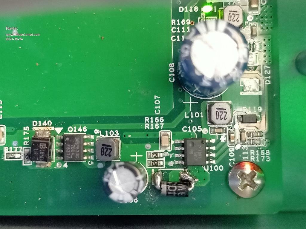

Could not find information on this diode, so replaced in with another smd diode of similar size....well it all fired up when connected to the batteries, looks promising, after about an hour all lights are out on the circuit boards, bugger.
Checked and found the diode shorted again, (I do not have any SMD stuff around, just grabbed something from old unused circuit boards) replaced it with another different one that was a little larger looking but unknown value, soldered it in, connected power and the diode failed immediately, something else may be wrong?
Just get a 1n4004 bend&cut the legs and solder that in place...it will fit.
Ok it now works with that diode in place and no heat on components, still don't think its doing what it should, some of the LED's are not as bright as the rest, for what ever reason.

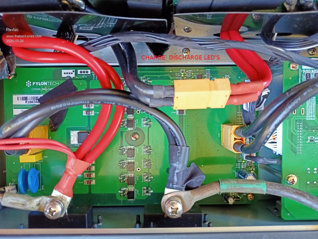

The 2 LED's on this board indicate the charge and discharge mosfets low voltage cut off, one led will go out, the other will be off when voltage goes high....normal operation.....what is not normal is that either of them will switch off with know reason at all that I am aware of, started at 48.4 I had the inverter running off it for a short time, and it just cut power to the inverter at 48v, could be SOC setting that is not working or setup.
Charging the flatpack the row of LED's indicate the cells that have a higher voltage than others and are in the process of lowering the voltage of those cells, This section appears to be functioning normally.....enough to burn a finger on those resistors after a short time.

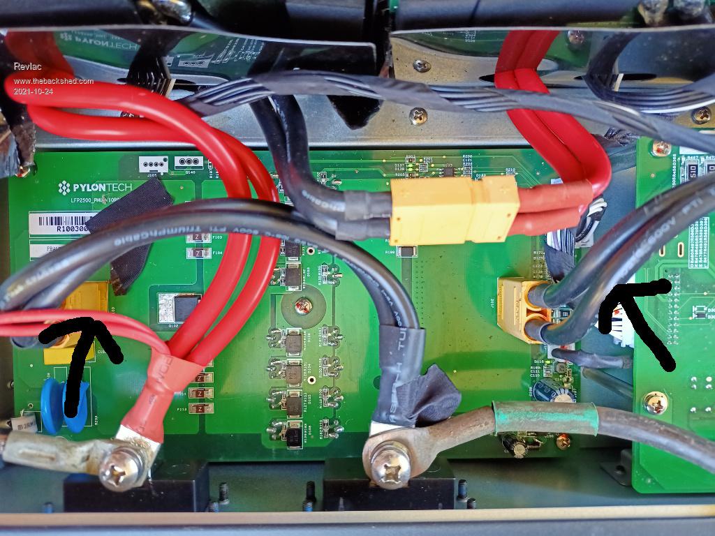

Another issue or several....charge will often cut out and restart for no apparent reason, don't what to blowup an inverter connected to it when that happens.
When the (cells are full) charge exceeds what the balances can handle it cut the input power.....as it should, however the fault led comes on and shrieking noisy buzzer starts up and as yet, will not turn off without actually removing the positive power wire.
What we could do is put an external switch on this positive wire to either reset when this fault occurs, or it will also be used to turn the power off to the unit, as there is no other way to turn it off.
The large black wire is negative power in and out of the battery, what we could do here is splice a heavy wire into that and run that to an inverter or appliance or whatever, to avoid all the strange on off behaviour, however this would bypass the low voltage cutout rendering it useless....use an external low voltage cutout, should do the job.
For charging, the normal ports (outlets) should be used, this will still use the battery protection and work in its normal way...Normal? Whats that?
The reason for this flatpack's behaviour, with its power on off on trickery, could be that the flatpack in supposed to have a control unit connected to it, that connects to net where setting and commissioning of the system is performed, also according to the manual the power led should flash and the button should put the flatpack into sleep mode when pressed for a few seconds, but NO it wont do that.
These are not build to be stand alone, as far as I can workout.

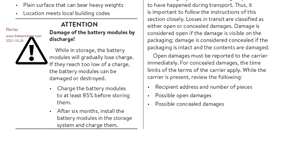

Not sure what was the cause of the flat cells, could have been left sitting on the shelf too long and discharged till completely flat, or some fault on the control boards.
So after all this, giving these cells some shock treatment has revived all of them, but still many unknowns, they have swollen back up a little (wouldn't be noticed with cylindrical cells), the capacity is unknown although I did put in over 400Wh into each of the 3 packs (about 1.2Kwh overall) there was some time spent charging after that, don't know how much.
