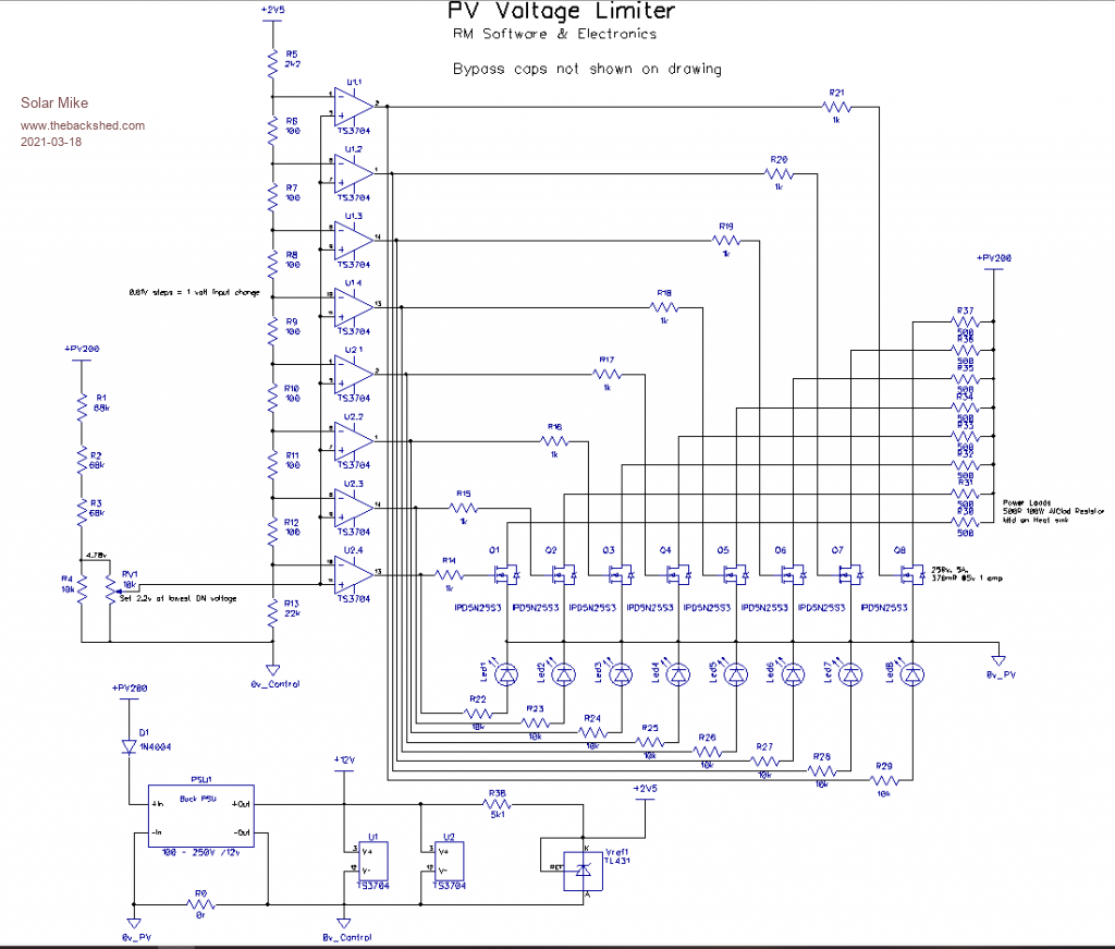

Decided to start to build up something, did few tests putting a 1 amp load on unloaded 1.5Kw 120v panel array that's close at hand, the voltage dropped 7-8 volts; so should work on a 200V peak array.
Simplest I can come up with is 8 comparators that have push-pull outputs, that will concurrently switch on as their sample voltage increases over a narrow range. Each one turns on a mosfet with a 500 Ohm alclad resistor bolted to a heatsink. May have to have a small fan, will see, I don't like fans, they crap out after a number of years, longest I have had one run for is 2 years before the ball bearings fell apart.
Circuit:
Note no bypass caps shown, or spike protection but will be on the pcb.
Mike

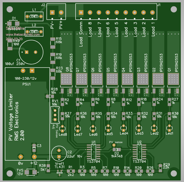

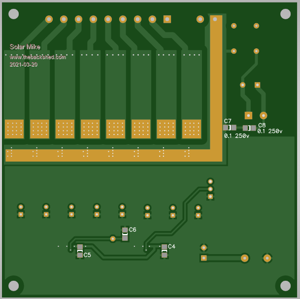

100 x 100mm PCB, circuit  essentially unchanged other than component designators have altered after I re-numbered the old schematic above.
The specified DPak mosfets are rated for 250v, 5A, Rds of 0.33R at 2A load; the pcb trace acts as a heatsink, so should be ok for loads under 3A per device or 24A total.
I have a box of 1000R 50W resistors and will use combinations of them bolted to a 3mm thick alloy plate as the heatsink.
The plan is to set the sense voltage some what above the array Mppt value, so when the PV is lightly loaded the mosfets start turning on, applying a load  to limit the peak voltage.
I haven't placed any spike suppression on the mosfets, their turn on/off speed will be limited by the drive resistors, so unlikely to cause high speed transitional glitches.
Guess you could also use something like this on a wind powered device to add additional loading if the speed increased and thus higher voltages.
Mike
Posted: 10:03am 20 Mar 2021
Very nice Mike, an excellent job as usual.
Be very interested to see how this goes.

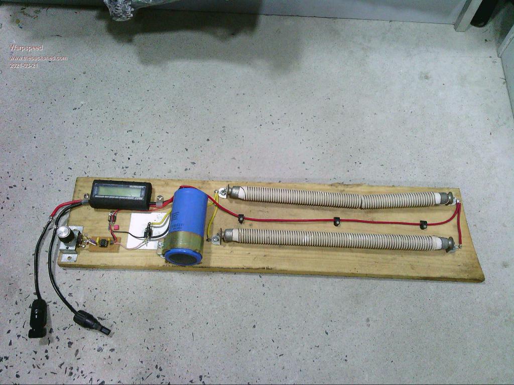

Posted: 11:11pm 20 Mar 2021
Back in 2018 I built a simple continuously adjustable load for testing and comparing solar panels.
It used an LM555 timer that generated pwm 0% to 100% duty cycle, and that switched a very heavy resistive load on and off that discharged a large electrolytic.
The electrolytic was large enough to completely eliminate the pwm pulsing, and acted as a steady state load on the single 24v solar panel (one only).
Not really a buck converter as there was no choke, it just switched the resistive load on and off. A choke would have been better, and greatly reduced the size of the electrolytic needed, but for this I did not bother with a choke.
It used a Turnigy power meter that monitored volts, amps, watts, and watt hours.
Very instructive on how solar panels actually behave, and it is also what led me to the original idea of the "solar hot water" self adjusting MPPT controller.

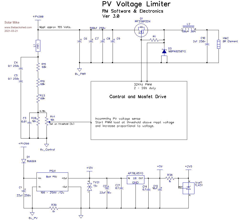

That looks highly original Tony, those little watt meters are great, I use one for testing low voltage PV controller outputs.
Here is a brief schematic, sort of works in reverse to a standard PWM buck power supply controller in that only the input PV is monitored, if its less than a set point, say 6 volts above the normal expected PV mppt value then it switches off any pwm drive and does nothing. When the PV input exceeds the setpoint, then pwm drive starts with 1-2% duty cycle and increases proportionally to any voltage increase, ie. to prevent the PV voltage from increasing too much, the wasted power heats up the water.
During normal operation the PV charge controller is running at the PV array mppt point, so the load circuit wont have any affect; it will only switch in if the voltage rises say when on float or similar.
If I allow up to 20 amps of load current that should be sufficient to keep the voltage under control, any more then that may have to use a synchronous mosfet rectifier rather than the MBR40250. No large electro's on the output as I dont really care about any ripple.
Mike
Posted: 09:58pm 21 Mar 2021
If you put the mosfet in the negative side, the source could then be grounded, which makes it a lot easier to drive.

  Solar Mike said
Mike
I always admire your PCB's Mike, one could learn a lot from them.
To further my knowledge, can you supply more detail on that nifty way to pass heat (and current) from one side to the other by using multiple tiny vias?
Specifically, what size drill for those vias and how much current each can handle.
If there is some online calculator for plated through hole current capacity I'd appreciate a link to it.
I assume that capacity depends on the size of the plated through  hole?
Posted: 05:53pm 22 Mar 2021
Many years ago when we still had companies in Australia manufacturing circuit boards, I remember a discussion with the factory production manager. He said they did some testing of plated through holes and especially vias as to how much current they could take, and about two amps per via was about the practical limit, as I recall.
You can place non tented vias as very small normal pads (or pads within pads), which means the via is not covered by the solder mask as they normally are. The vias can then be filled with solder which should make a big improvement to both heat and current transfer.
As far as heat dissipation, about one watt per square inch if both sides of the board are used seems to be about the limit, although I have never seen any published recommendations. Anything in contact with a board that reaches 80 Celsius or more will make the board turn black over time.

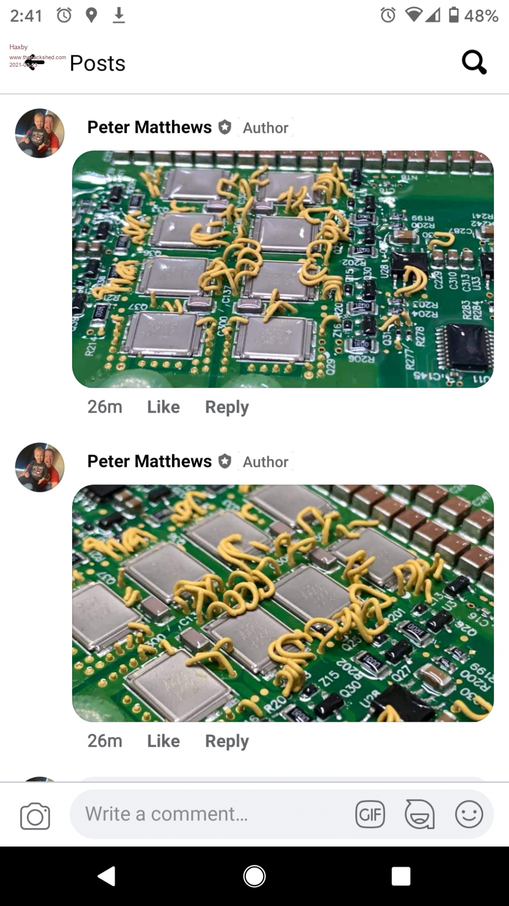

Lots of interesting tricks in the trade for heat dissipation these days. Here is a tesla Powerwall MOSFET board:
I think it uses IRL7472L or similar package.
Looks like the whole board is stuck down with a thermal adhesive and the vias stop air bubbles from forming in the adhesive during manufacture. The result is the Raman noodles look.
There are also smd components that look like capacitors but all they do is transfer heat from one pad to another. Good to use when you have a giant ground layer heat sink but the component you want to cool is floating at some voltage.

Hi Murphy's friend.
Thanks for the kind comments. Standard 1.6mm FR4 cored pcb doesn't conduct heat well, placing open un-tented 0.4 to 0.5mm vias that allow flow soldering to fill them up will improve things a lot. It can never be as good as bolting the power device direct to a heatsink, going to thinner 0.8mm pcb material would allow a better heat transfer. Better the new alloy cored pcb materials.
The pcb I'm using here has 16 x 0.4mm vias on the drain of each mosfet, pcb will be 1mm thick, each mosfet will only be dissipating 0.35W @1A to 1.4W @2A, so temperature rise isn't really an issue, current carrying capacity of vias is determined by the surface area and depth of the plated through hole and allowed temperature rise, 0.4mm vias can conduct several amps, I allow 1amp per via to stop them warming up to much.
One of the high power PV controllers in a previous design has DPak power devices soldered to the top of the board, with the heatsink mounted via an insulator bolted to the underside, each device has 42 x 0.5mm vias linking each layer, how this will work in practice I dont know, building those up now, still waiting for the mosfets to arrive...
Here are some links for PCB trace\Via calculations
Calc1
Calc2
Mike

  Warpspeed said  If you put the mosfet in the negative side, the source could then be grounded, which makes it a lot easier to drive.
Very true, I need to have another think about this concept overall.
Initially the aim was to reduce the peak array voltage of approx 200v when the panels were unloaded down to 160v, 5 volts higher than the mppt value of 155.
Then later thinking to divert this wasted power into something more useful other than heating up the air.
A standard HWC element (3Kw 17.6R) could be used, however at the 160v value only 1500W would be used, when the 6Kw array could pump out a lot more. Would have to use 2 elements in parallel to lower the resistance, I don't really want to weld another big nut onto the cylinder in order to add a second element.
Perhaps a simple high frequency transformer pwm push-pull inverter could be used to step up the voltage from 160 to 230, rectified and the unfiltered pulsing DC supplied to the element via a switch device connected to the thermostat.
Or a boost upconverter topology.......
