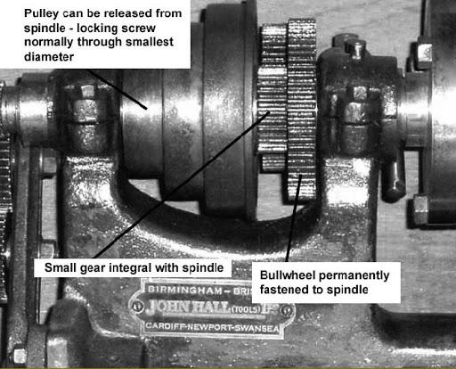

Posted: 09:55am 10 Feb 2021
To fit an endless belt to one of those old lathes involves removing the main spindle.
If its built like this one, just unbolt the two saddles, fit the belt, and put the saddles back.
