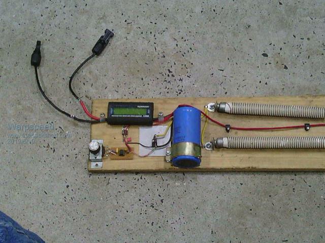

My old solar panel tester works in a very similar manner.
There is a relatively large electrolytic connected to the 24v solar panel via a Turnigy power meter.
A pair of nine ohm radiator bars connected in parallel are switched by a mosfet as a discharge load. The mosfet gate is driven by a 555 that has an adjustable duty cycle from almost zero to almost a hundred percent.
By tweaking the potentiometer I can adjust the constant steady loading on the solar panel from almost nothing up to a maximum load of about 4.5 ohms, and read off voltage, current, and power at any loading point. Its dead easy to find the max power point, and measure how the power falls away at higher or lower panel voltage.
Its all very simple and efficient and works amazingly well. A higher voltage version connected to a hot water heater should be just as efficient.

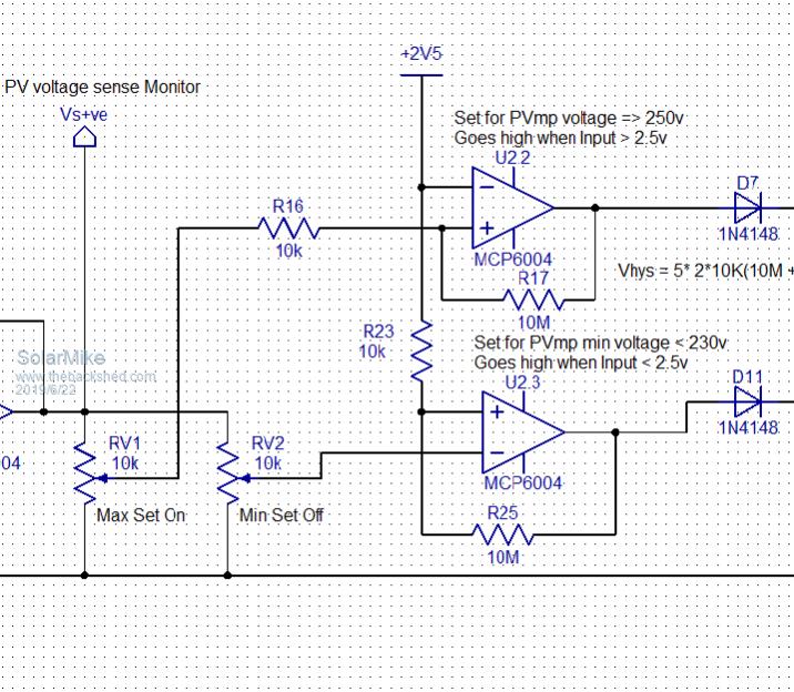

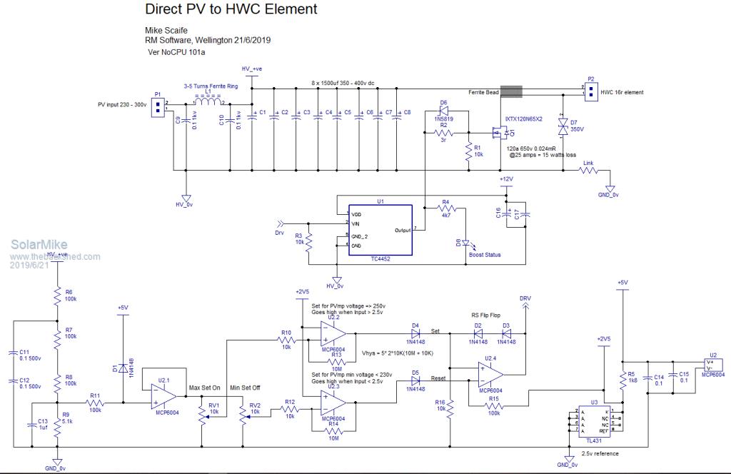

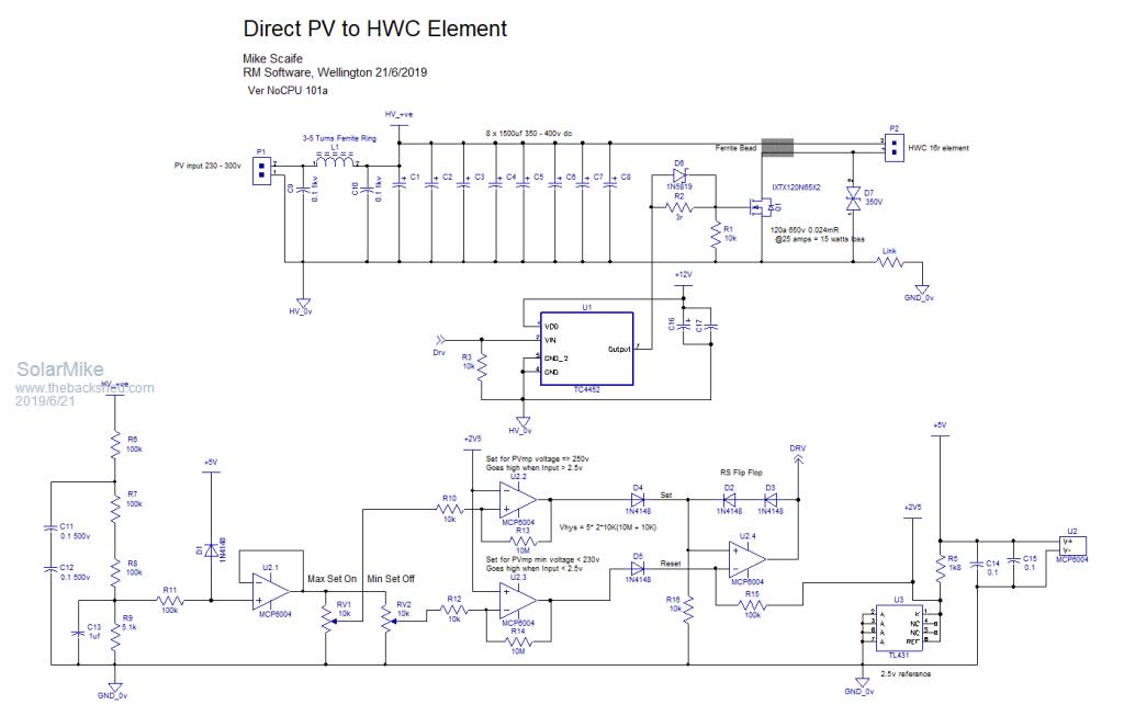

Good one there Tony, looks like it will work, here is the circuit that I think will do the job using minimal number of components.
I have used a rail to rail input/output op amp here as a voltage buffer, a high/low voltage sensor comparator and an RS flip flop. The output drives a mosfet driver stage.
The mosfet is triggered on at the max set point by RV1, it stays on until tripped off by the setting of RV2. The on/off rate will be determined by the main capacitor bank value and the amount of sunlight.
The circuit has to withstand the max panel voltage with no load, so with say 8 panels in series, could be exceeding 300v. Means mosfets start getting expensive, the one I have selected here costs $25 or so from RS.
Will make a pcb to test it, helps locate errors in the cct when laying it out.
Mike
Posted: 07:50am 21 Jun 2019
That is pretty much exactly how I would have done it Mike.
The two voltage trip points can be adjusted quite independently, and the whole thing can be set up with nothing more exotic than a multimeter.
I have been using some cheaper e-bay high voltage mosfets, at least for initial testing of some prototypes, then used something much better for the final effort.
FDA50N50 500v 48 amps 100 or so milliohms. Not exactly state of the art Rdson, but cheap at around $7.15, and it has an absolutely massive silicon die rated for 625 watts. It will run hot, but it will run.

  Warpspeed said   I have been using some cheaper e-bay high voltage mosfets, at least for initial testing of some prototypes, then used something much better for the final effort.
Good choice for initial tests, however if used in final solution, pulsing 24 amps and the expected duty cycle will be dissipating 30 watts or so with Rdson = 100mR. If the Rdson can be lowered to approx 25mR either by a single device or multiples in parallel then so much the better.
If the series connected panels max voltage can be lowered somewhat (USA HWC elements are 220v or 115v), then cheaper 300 volt mosfets could be used.
I don't have any suitable high voltage PV setup, so for running a test can use a 1KW variable 100v power supply and a 50V DC rated HWC element that I use as a dummy load.
Will leave for a few days before looking at the PCB design, so any options or changes people want let me know.
Edit: Mosfet diode incorrect, fixed, added status led
MikeEdited by Solar Mike 2019-06-22

When I tested that solar panel earlier in my previous post, I only had a very brief patch of clear blue sky to work with, and had to work very quickly.
The figures on my power meter were jumping around all over the place, and I now realize why.
My 555 runs at only a few hundred Hz, and the voltage on the electrolytic is ramping up and down at that rate. Not by much, but the A/D converter in the power meter is not synchronous with this ramping, and I was seeing scrambled numbers that I had to quickly eyeball, guess, and write down.
Anyhow, the test tells us that we have a surprisingly flat power curve, which is what I vaguely remembered from similar testing a few years back.
I just wanted to see all that again, and confirm that Mike's circuit is not only workable, but is going to be non critical to set up and also a lot more overall efficient than I expected for something so simple.
Posted: 08:54am 22 Jun 2019
So, if I were to build such a clever solar panel power tester, what should I do different? Run the 555 at a lower frequency? Or fit a bigger capacitor?
I happen to have such a Turningy power meter, sitting on my shelf for a long time, waiting for a project

Cannot believe how many errors I made drawing the schematic, the inverting comparator was not going to work... not enough coffee, amended part here.
I will start a new thread for this circuit with a replacement drawing..
Mike

  Ralph2k6 said   Sorry for my naivety, but is this sort of voltage and power closing in on IGBT's instead of MOSFETS ?
rs compnents igbt module
IGBT's are more robust and less expensive than High Voltage mosfets, and suited for low frequency switching as per this circuit. Their saturation voltage at any appreciable current is approx 2 volts.
In this instance the mosfet is switching 15 amps from the charged cap + 8.3 amps from the PV; say 24 amps.
The IGBT will dissipate 48 watts, a single mosfet with 24 mR will dissipate 13.8w, 2 parallel mosfets total dissipation = 7 watts.
As this is a somewhat lethal device, it has to be placed in an enclosed box, 7 watts heat is easier to control than 48.
Mike
