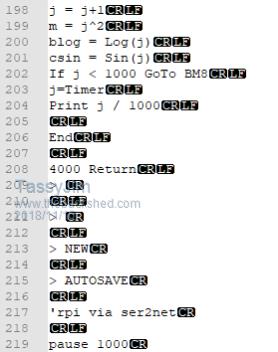

Codenquilts
Posts: 6632
Posted: 02:51am 16 Nov 2018
I will try to work out how to ignore the error message.
My usual upload method is AUTOSAVE from 'load' in MMChat.
I have added a setting to use ctrl-C for PiCromite files and that seems to work.
I have another 'problem'
The PI starts sending double CRs which results in double spacing.
I still haven't worked out what triggers it.
Posts: 6632
Posted: 05:17am 16 Nov 2018
An update for MMEdit to address the XMODEM problem.
You still get the error message but MMEdit keeps going instead of throwing a hissy fit.
I have also made some changes to allow using AUTOSAVE ('Load' in the Chat window)
To do this you need to select the PiCromite syntax file so MMEdit knows to use ctrl-C instead of ctrl-Z
I have also made a few changes to fix a few errors caused by the extra CRs.
You need to place the TKN file into the program folder and the DTA file into the data folder.
2018-11-16_151710_MMedit.zip
Edit:
I tried using AUTO instead of AUTOSAVE but that came up with 'Error: Unknown command'
If you are using MMBasic via a serial port, exiting out of MMBasic can be hard to recover from. Perhaps a 'Confirm exit' would be useful to catch the accidental ctrl-Z
Edited by TassyJim 2018-11-17

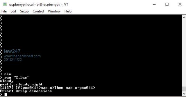

lew247
Joined: 23/12/2015
Posts: 1709
Posted: 09:58pm 21 Nov 2018
Matherp
I installed the latest version of Picromite tonight but I'm getting a weird error
I don't have that line of code in my program
I had no issues with the previous version I was using, although it was probably 2 - 3 versions ago, I didn't upgrade when you included the code for graphs at first
Any ideas?
I've sent you the full code by message as it contains my logins for the various weather stationsEdited by lew247 2018-11-23
Posts: 12083
Posted: 07:27am 22 Nov 2018
That line is in the code you sent me in the subroutine "getlimits". Geoff has tightened up array checking in the latest version of MMBasic and I implemented the changes in the Pi-cromite.Edited by matherp 2018-11-23

Posts: 4391
Posted: 01:38pm 22 Nov 2018
Two thoughts
1. pxx0 appears to be used as an array but declared not as an array
2. i has not been set.
I suppose i may default to zero but that is terrible coding even if so.
JohnEdited by JohnS 2018-11-23
lew247
Joined: 23/12/2015
Posts: 1709
Posted: 01:53pm 22 Nov 2018
  JohnS said   Two thoughts
While it may be "terrible coding" I have no idea how you declare something as an array
Posts: 12083
Posted: 06:09pm 22 Nov 2018
  Quote  1. pxx0 appears to be used as an array but declared not as an array
This is the "bug" that Geoff fixed. Previously simple variables could be used with an index without a bug being generated.
If pxx0 etc are simple variables then just get rid of the index brackets from the subroutine
lew247
Joined: 23/12/2015
Posts: 1709
Posted: 09:00pm 22 Nov 2018
Thanks Peter
I've got it working again now

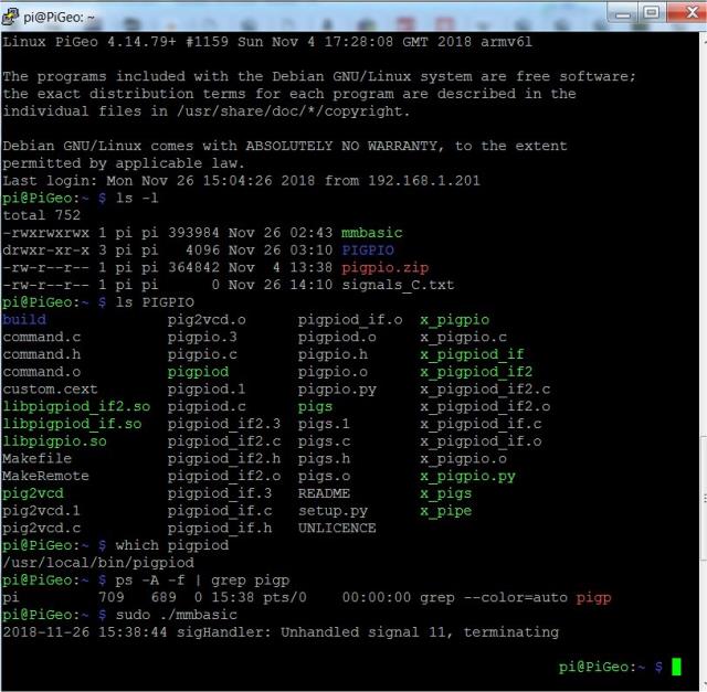

Posts: 3885
Posted: 03:54pm 26 Nov 2018
I downloaded 2018-11-17_085257_mmbasicstetch.zip and put mmbasic on a raspberry pi zero w with latest raspbian stretch lite (installed yesterday). When I run "sudo mmbasic", I get "SigHandler: Unhandled signal 11, terminating", and a return to the "$" prompt. I'm connected to the pi headlessly over wifi with puTTY.
At this point, what I type does not appear, but if I type a linux command and hit enter, it runs. I have to reboot to get typing at the linux command line to appear.
I'm not running pigpiod, as shown by "ps -A -f | grep pigp". I followed instructions and made pigpiod v68--location shown by "which pigpiod".
I could not cut and paste from the puTTY window after the SigHandler error. There is a screen shot below.
What do I need to do?
Posts: 12083
Posted: 05:31pm 26 Nov 2018
  Quote  I get "SigHandler: Unhandled signal 11, terminating"
Things to try:
make sure stretch is fully updated
sudo apt-get update
sudo apt-get upgrade
Try "rm .options" before running mmbasic
  Quote  I have to reboot to get typing at the linux command line to appear.
Just disconnect putty and re-connect and you will get back to normal. This issue is that ncurses has taken over control of the terminal
UPDATE
I had a jessie pi-zero w that needed updating so I did a complete new install
downloaded Stretch-lite image
burned to sd card using win32diskmanager
created wpa_supplicant.conf with my wifi details and saved on the boot disk
created "ssh" and saved on the boot disk
sd card into pi-zero and power on
found ip address of pi (wifi connect successful)
connected using teraterm over ip (SSH successful)
sudo apt-get update
wget abyz.me.uk/rpi/pigpio/pigpio.tar
tar xf pigpio.tar
cd PIGPIO
make
sudo make install
cd ..
downloaded 2018-11-17_085257_mmbasicstetch.zip from TBS
extract mmbasic
copy to pi using winscp
chmod +x mmbasic
sudo ./mmbasic
All runs perfectly
