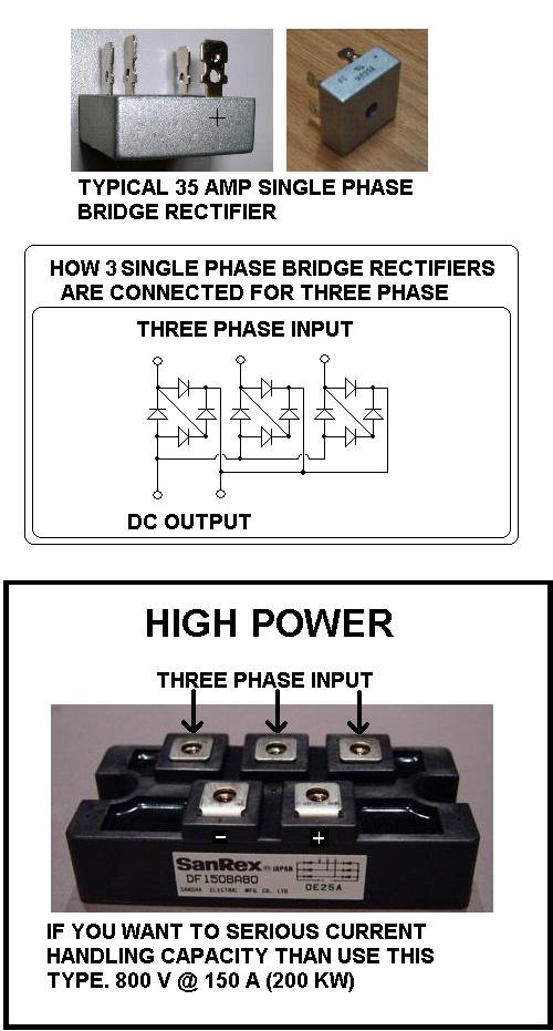

The only benefit from using bridge rectifiers instead of diodes is that it is simpler to wire. The drawback is that if only one diode burns out in the bridge rectifier, then the rectifier will cut your current flow by 50%. If you use 3 bridge rectifiers as shown in the arrangement below than your current carrying capacity becomes double. I would bring the three phase output of the F & P stator down the tower and rectify at the base.
