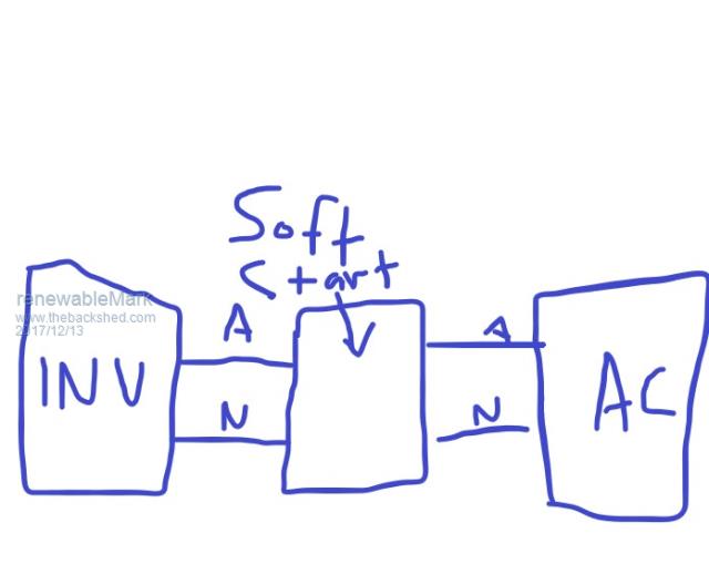

Can you clarify "needs to be connected in after the power trigger"
Can I run the AC power into that board and the output to the AC feed line, or does it get fitted in the AC somewhere?

Posted: 06:53am 13 Dec 2017
Like this???

Posted: 07:36am 13 Dec 2017
Search Oztules 6KW inverter, you will find lots of information on this site and a few others.
Cost to build an Inverter is under $500, have a search around for old Aerosharp 3 KW GTIs, I think there was someone in Melbourne was selling new old stock for around $60 each recently. These old inverters have transformers, copper wire, heatsinks, filters, cases and other bits and pieces that keep the cost down.
I did have some PCB's but would need to order more, if you are going this way hang onto the Aurora GTI as it will work in well with what you are trying to achieve.
Soft start has to have no power to it until you start the device so must go after whatever is switching on the motor, ie trigger on power tool or contactor in the AC. putting in before this will just have it passing power through with no effect. It must only see power at startup, not before.
