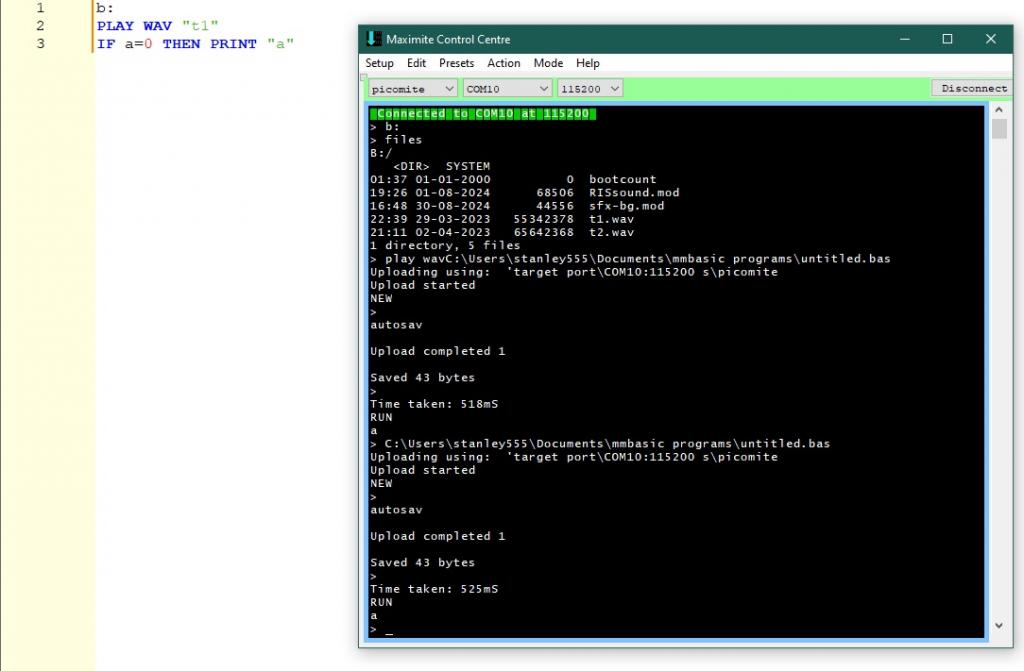

Posts: 6191
Posted: 08:57pm 21 Dec 2024
Hi Peter,
There is a serious issue with PLAY WAV on RP2040 VGA 6.00.01rc9
On the commandline you can type PLAY WAV "yoursong.wav" and it plays.
In a program you can not.
Below is a minimal code to show the problem. It uses the tetris sound for Blocks.
PLAY WAV "tet16cut.wav"
if a=0 then print "a"
This errors with "Error : IF without THEN"
and does not play any sound.
Edited 2024-12-22 06:58 by Volhout
stanleyella
Joined: 25/06/2022
Posts: 2807
Posted: 09:32pm 21 Dec 2024
2350 hdmi usb is ok
Edited 2024-12-22 07:36 by stanleyella

Posts: 12042
Posted: 08:17am 22 Dec 2024
  Quote  There is a serious issue with PLAY WAV on RP2040 VGA 6.00.01rc9
Just need to finish off some work on AES128 and then I'll look at it. Pretty sure I know what the issue will be - firmware has outgrown the space allocated so programs are overwriting the firmware
