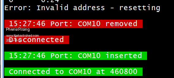

I'd just started a settick test, after reading about an issue, when I saw RC15.
I updated my RPi Pico 2 and ran my normally rock-solid "settick 1" routine. It runs for a few seconds and then:
Oh wait....it's also the first time that I tried 396MHz..Dropping back to 378MHz to test.
Edited 2024-11-06 01:38 by PhenixRising
PhenixRising
Joined: 07/11/2023
Posts: 2099
Posted: 03:43pm 05 Nov 2024
False alarm...My Pico-2 doesn't like 396MHz

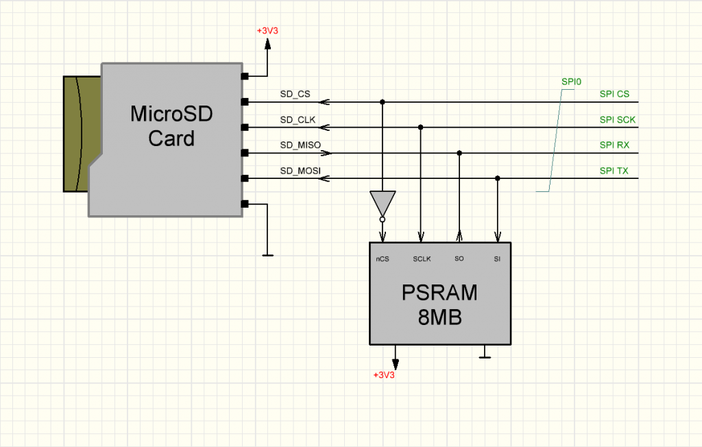

External PSRAM for PicoMite
Is it possible for PicoMite to combine the connection to Pico of an external SD card and the SPRAM memory on one SPI bus?
Make the choice of access via the Chip Select line, for PSRAM it is inverted, which means it is available when there is no access to the SD card.
What are the considerations for this?
Posts: 12042
Posted: 09:45pm 07 Nov 2024
No

if psram is cool then why it not implemented commercial pico boards?
Posts: 9229
Posted: 10:25pm 07 Nov 2024
We now know that Pimorini's PSRAM is slow on a QSPI bus. It'll probably be slightly faster than paper tape storage if you use a single SPI channel. :)

javavi,
A PS-RAM as a external memory device can technically function on the SPI bus. But you would need to treat it as such. The SD card speed (clock speed) is in the 5-16MHz range. The PS-RAM would need to use similar, but it is 1 bit databus.
The RP2350 boards that have PS-RAM use the memory chip at somthing like 60MHz with a 4 bit wide bus. That gives a datarate that is around 20x faster. This is the same bus that the flash is on. Additionally there is (hardware inside the RP2350) a caching mechanism attached to the QSPI bus.
So yes, technically it is possible, but it may be better to buy a device that has PS-RAM on board. so you can use it in a transparent way, and it is much faster.

  Volhout said  So yes, technically it is possible, but it may be better to buy a device that has PS-RAM on board. so you can use it in a transparent way, and it is much faster.
Volhout, Thanks for the detailed answer!
I just know that the emulator guys use PSRAM in single-bit SPI mode in their emulators of retro computers on Pico (RP2040) and this memory allows them to expand the RAM of emulated devices, such as ZX-Spectrum 1024k on Z80 @3.5MHz with memory page switching.
True, this works on PIO machines at a data rate of up to 133 MHz.
Yes, I am aware of the expanded capabilities of working with PSRAM of the new RP2350 chip, but unfortunately there are no available modules with installed memory yet. I don't understand why it was impossible to make a landing place on the bottom of the reference board.
Regards, javavi.
