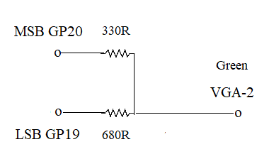

Here is the simplified DAC I use. Dark Green and Mid Green are not exactly the same as the precision DAC but with only two bits the colours will always be as rough as guts no matter what is used.
If all else fails remove the existing resistors and use this. It will give all 16 colours.

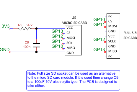

Is this correct? I don't get these GP assignments on the full-size SD card:
Craig

SPI TX = MOSI (master-out-slave-in):
GP3,GP7,GP11,GP15,GP19,GP27
SPI RX = MISO (master-in-slave-out)
GP0,GP4,GP8,GP12,GP16,GP20,GP28
Unless I misunderstand (it happens a lot   )
Craig
Posts: 9238
Posted: 09:12am 25 May 2022
There isn't a problem as on the MicroMite the SDcard is always software driven and doesn't use the SPI hardware built into the chip. Even if you use SYSTEM SPI the SDcard will still use software.
You can actually use any pins you like for an SDcard. :) This is why I was able to simply reverse the order of the OPTION SDCARD signals to allow an alternative full size SDcard to the micro SDcard module, which has the socket upside down.

  Mixtel90 said  There isn't a problem as on the MicroMite the SDcard is always software driven and doesn't use the SPI hardware built into the chip. Even if you use SYSTEM SPI the SDcard will still use software.
Aha...That's what the other thread was referring to when they said it was bit-banged
Craig
Posts: 9238
Posted: 10:00am 25 May 2022
Correct. :)
The next version of the PicoGAME allows a SMD microSD socket, as well as a full size one. The pins are in the same order so it wasn't difficult to do.
