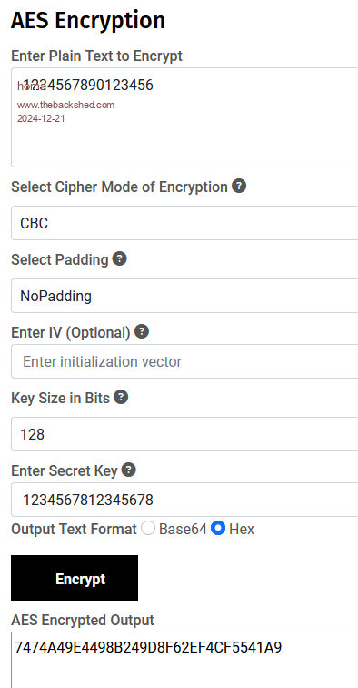

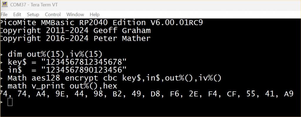

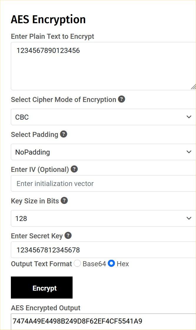

Posts: 12042
Posted: 06:15pm 20 Dec 2024
So many thing wrong
You haven't set an initialisation vector and they seem to be assuming all zeroes - I don't
Trying to print out$ can't work as it contains non-printable values. You would have to take each element in turn and HES$(asc(mid$( it
And then somehow you have got the website to create a 32 byte output from a 16 byte input
My way works
Edited 2024-12-21 04:17 by matherp

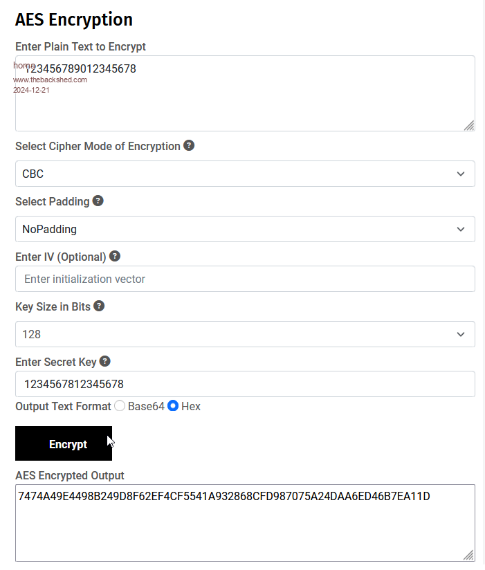

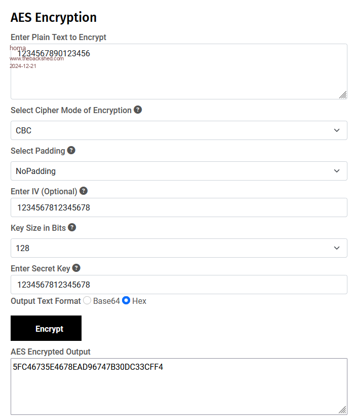

You are right, my first entry on the website was two characters too long.
Here is the correct test1:
> list
'TEST aes128 cbc
Dim integer out2(15)
out$ = ""
key$ = "1234567812345678"
in$  = "1234567890123456"
iv$  = "1234567812345678"
Math aes128 encrypt cbc key$,in$,out2(),iv$
Math v_print out2(), hex
'Print out$
> run
5F, C4, 67, 35, E4, 67, 8E, AD, 96, 74, 7B, 30, DC, 33, CF, F4
