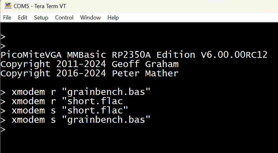

xmodem s "V 6.00.00RC12 LCD-b.opt" sends the file ok (via TeraTerm) but never returns to the command prompt. Heartbeat stops, no response to Ctrl-C.
Xmodem r "file" is ok.
Footnote added 2024-11-02 13:34 by phil99
PicoMite MMBasic RP2040 Edition V6.00.00RC12
and
PicoMiteVGA MMBasic RP2350A Edition V6.00.00RC12
Tried a variety of file sizes, same result.
Footnote added 2024-11-02 13:43 by phil99
PicoMiteVGA MMBasic RP2350A Edition V6.00.00RC12 also locks up with Xmodem r "file"

Posts: 3414
Posted: 08:38pm 02 Nov 2024
Using TeraTerm V4.103 and V5.2 same result, VGA and LCD Picos lock up after sending the file. Still happening this morning.
The Xmodem r lockup only occurs when saving on B:.
Serial settings:-
115200, 8, N, 1
Flow control- none
Transmit delay- 0mS/character, 5mS/line
These settings worked in the past.
